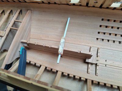

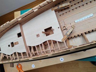

I hope I understood your question correctly. The inner layer of the partition is made of silica sand, which is commonly used in construction industry. The sand simulates a non-combustible mixture that was used as a "fireproof" material because there was a gunpowder store behind the partition.

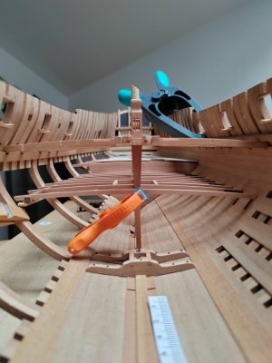

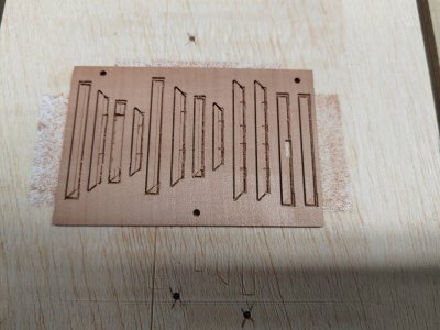

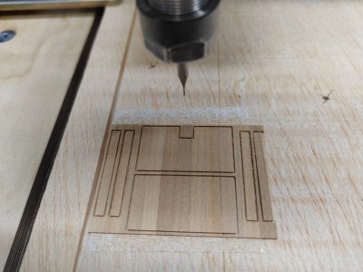

kuba91nt - Most of the parts (except the planks) are "cut" using a CNC milling machine, which guarantees maximum precision of the cut parts.

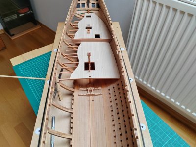

serikoff - The decks were not glued up to this point. I glued them in the next stage (see further in this post), of course I painted the entire underdeck with wax before that.

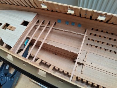

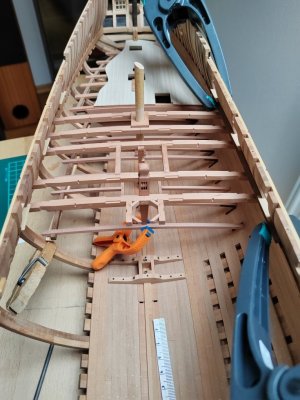

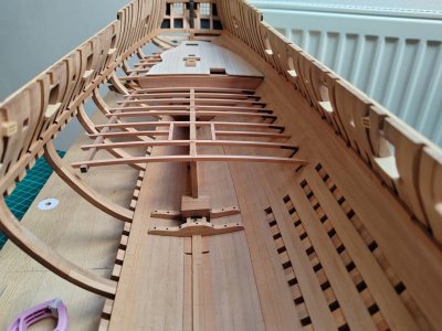

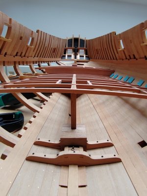

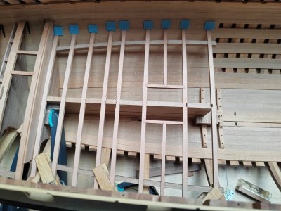

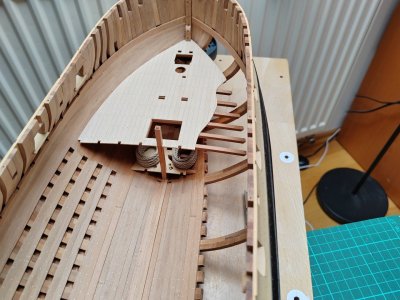

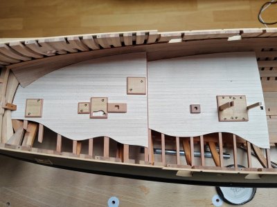

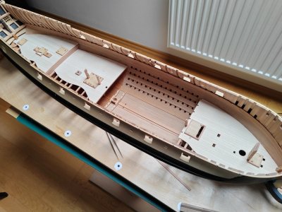

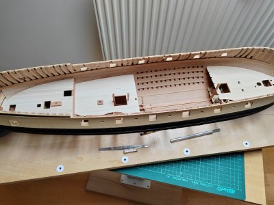

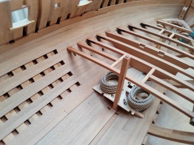

Below deck completed, all lower decks are glued in place.
kuba91nt - Most planks are cut with a FET saw and then planed to the appropriate thickness. The only exception so far is the deck planks, which are "cut" with a CNC milling machine.

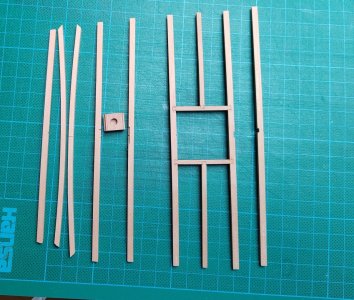

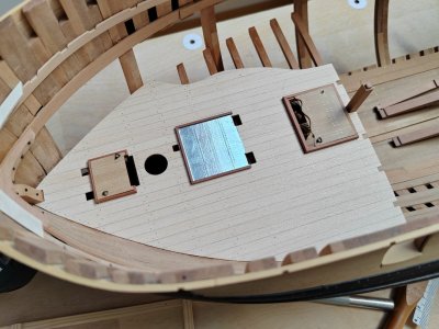

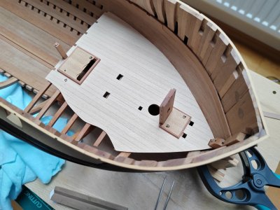

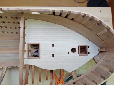

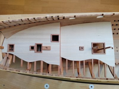

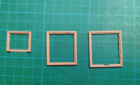

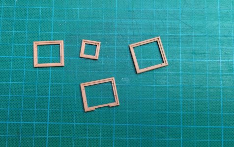

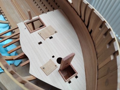

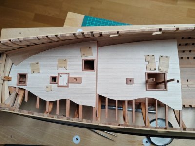

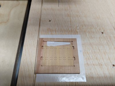

To make the decks not look so "poor", I started making hatches.
Beautiful, a joy to watch. Incredible precision and purity. :)Thumbsup
This is just such a wonderful build to follow. My compliments!

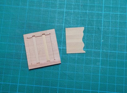

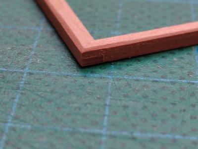

A question if I might: I am surprised to see mitered corners on the hatch frames. On English ships they are not done this way. Is this universally true on French ships?
Thanks everyone for the compliments :).
To Paul: I'm no expert on historical accuracy, but that's the case with both models I build according to French plans.

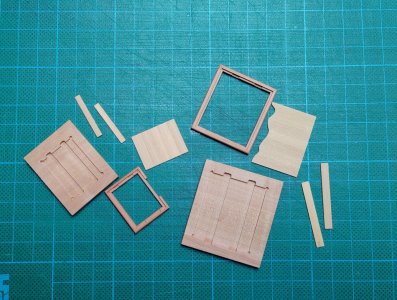

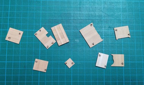

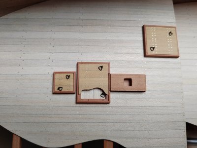

Finishing hatches - covers, sheeting for the galley stove.
A couple of very nice hatches!
