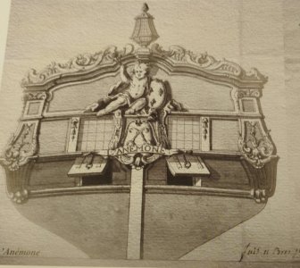

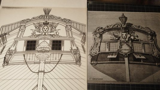

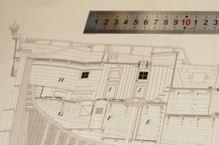

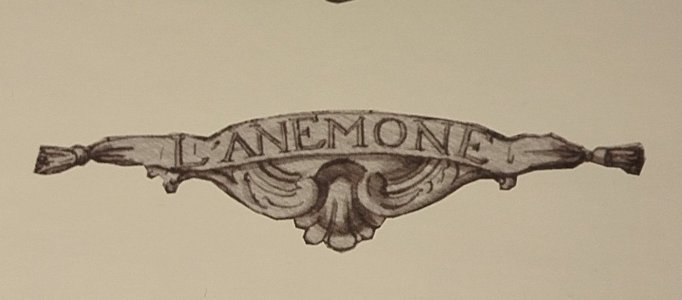

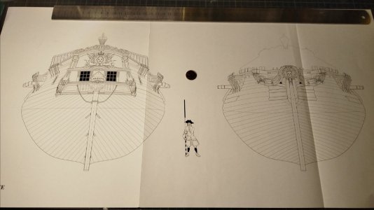

The L'AMARANTE monography offers a fully
three part decor to her sister L'ANÉMONE in ink by Cassieri - beautyfull drawings that will have to be stretched to fit the drawn transom.

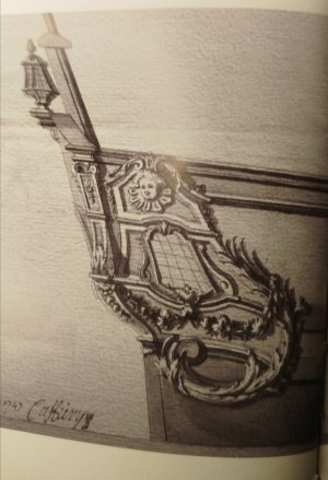

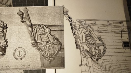

The bouteille is of a nice floral design with it's late Baroque / early Rococo layout:

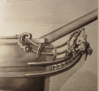

The figurehead will give me some headache:
Here the original drawings in 1/36 by Gêrade Delacroix showing the differences to the Cassieri art work side by side (later on I will place the frostpaper drawing onto of the Art Copy on my under light tablet).

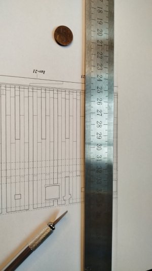

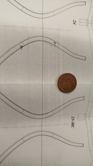

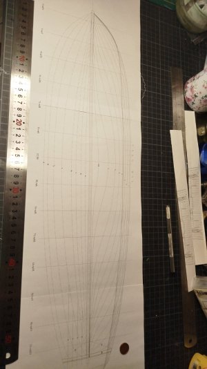

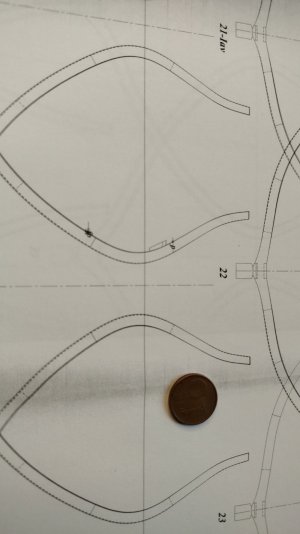

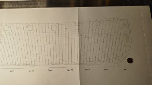

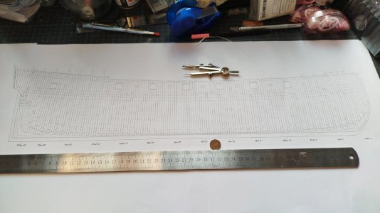

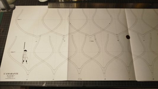

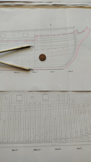

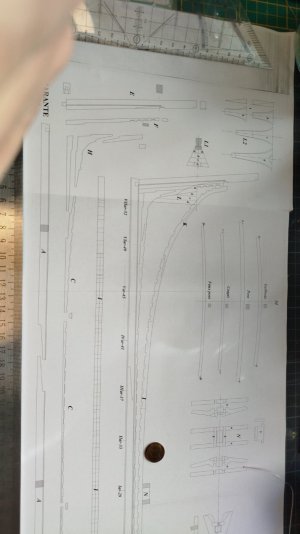

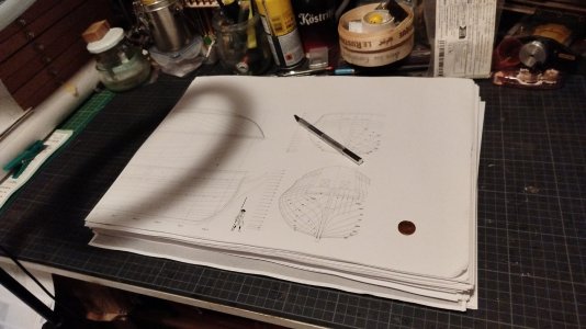

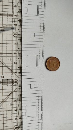

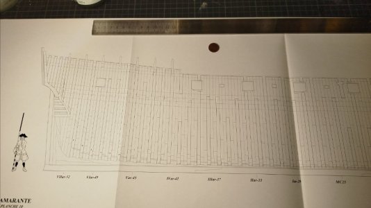

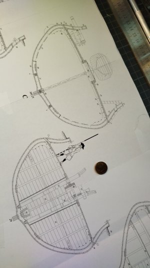

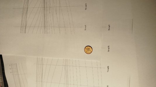

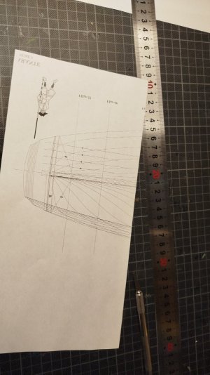

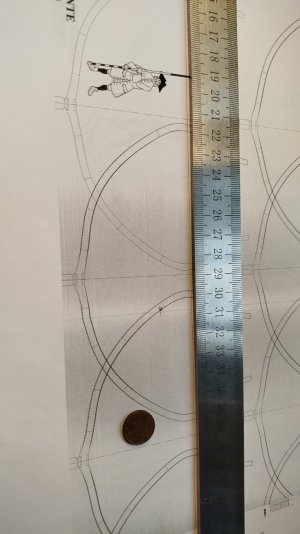

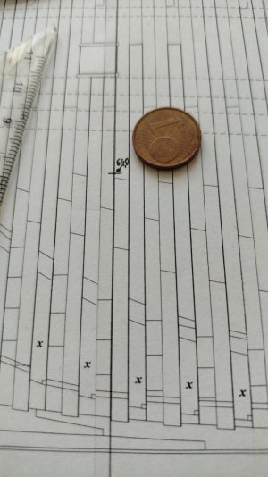

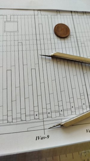

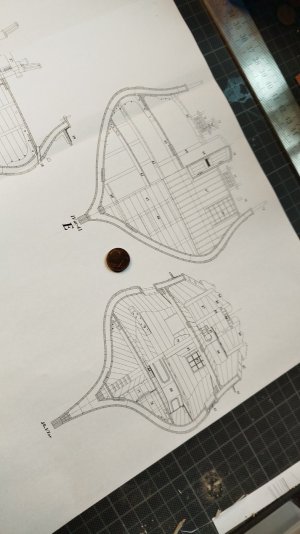

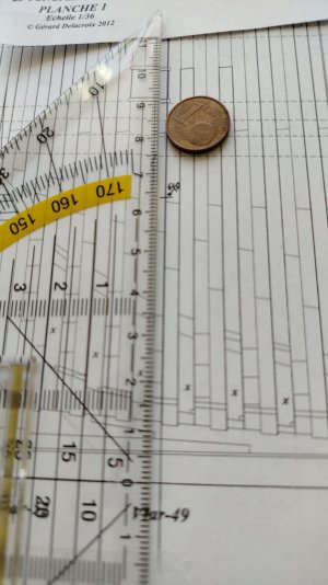

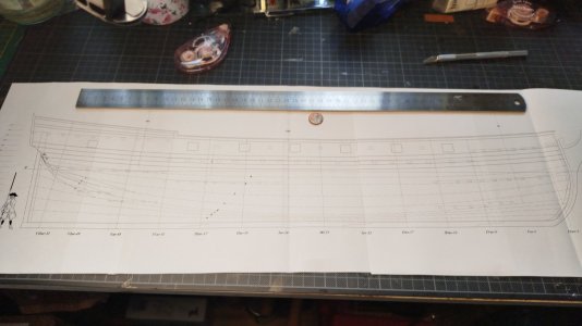

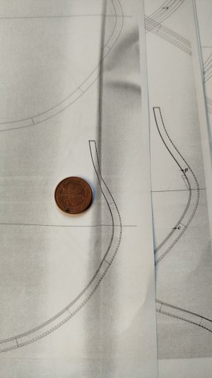

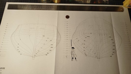

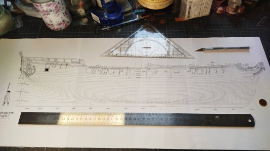

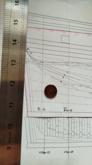

But this is what I do crash into at the very end; my Idea came while leafing through the plans' set - why should I not start using the huge

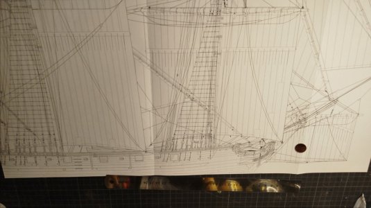

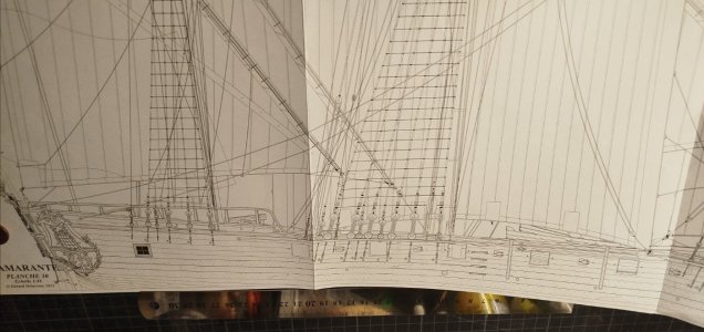

number of frames' drawing in card model building, too? Ab Hoving did it for an Admiraity model - so it does work,the proof of concept is made. So I could take the plans and scale them down by 75% to 1/48 Polish_20260308_194208938.jpg
as shown in the sail plan giving a good idea of the real size.

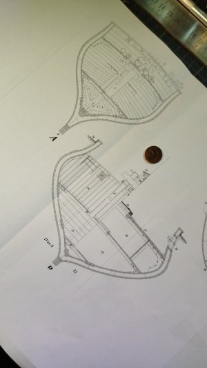

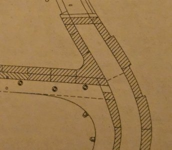

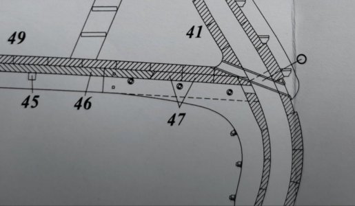

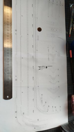

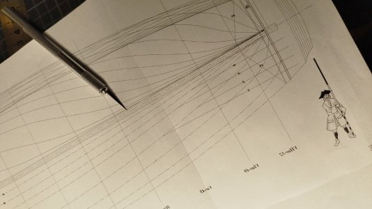

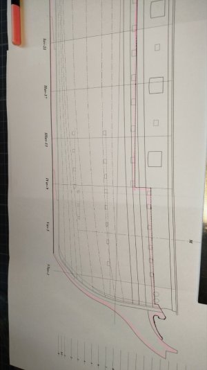

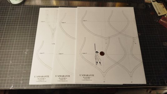

Certainly there are a plenty of formes - 53 at all,
so I may not to have double the bookbinder's cardboard of 1mm thickness but creating a centerboard looking like a crazy harp...

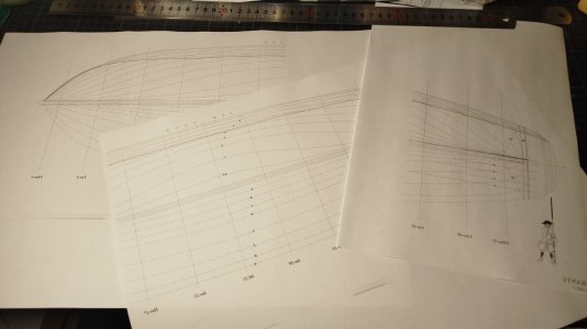

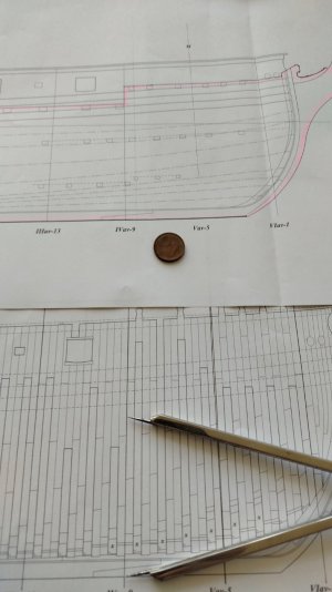

So there is a possibility to use the plates 5, 6, and 7 for the beauty lines of the hull.
so this will give a plenty more of glueing surface than the usual bulkhead method - even when only every 2nd or 3rd frame will be used.
So due to this I do call it the "tight method" for a hull model with closed gun port lids.

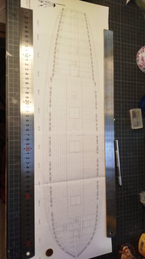

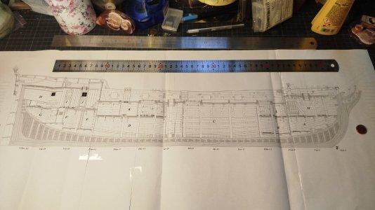

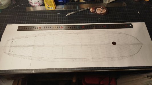

Here the first measurements downsized to 1/48 taken from the Ancre website:
Hull length:
860 × 0.75 = 645,0mms
Ships length:
1.080 × 0,75 = 810,0mms
Hull's hight
220 × 0,75=165,0mms
Ship's hight
810 × 0,75 = 607,5mms
Hull's width
22O × 0,75 = 165,0mms
Ship's width
440 × 0,75 = 330,0mms
This may give a first impression due to the size.
