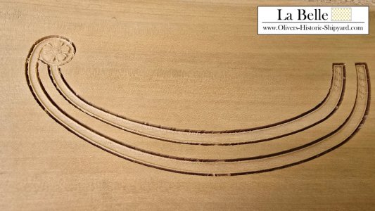

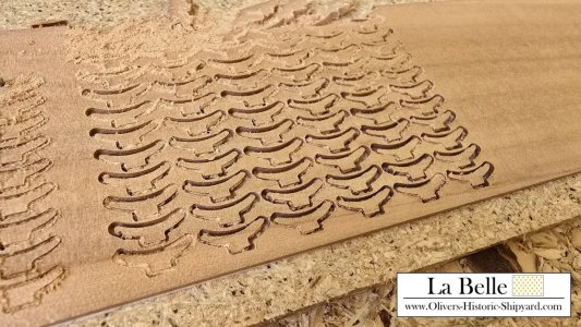

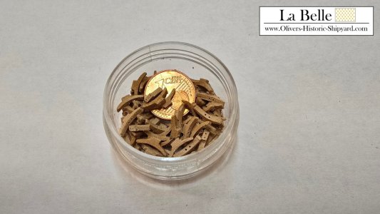

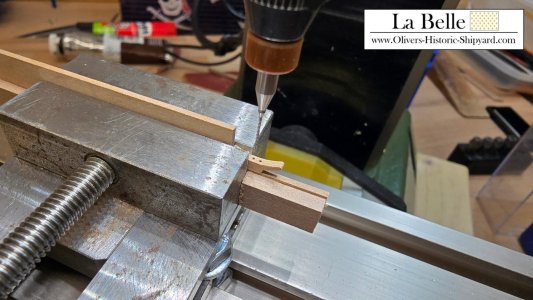

The cleats correspond geometrically to the small cleats on the wreck. As I don't trust glued cleats, I will also secure them with a bolt.

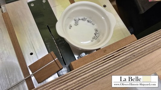

The 3mm sheaves will be installed in the crane beams, mast cradles and the fixed snatch blocks on the railing. According to the wreck, La Belle only had wooden sheaves and axles. Before installation, the parts are cleaned again, the cleats rounded, etc.

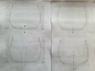

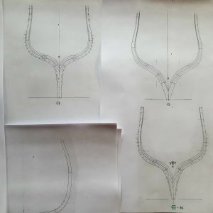

This is my first scratch build and there is a lot of things to learn for me. First I mesured the plan a lot of hours to find any mistakes and errors. May last project i canceled because the plan was incorrect and i build the hull with a lot of errors. To avoid the same error i tried to check up the plan.
Unfortunatly the plan is full with errors and incorrect drawings. A lot of drawings shows the same detail in differnt manners. The planset has two kind of errors. Errors in the drawing and errors in the printing. After this i decide to draw my own plan. In the drawing process i find more errors. Now i know that it was the best desicion to redraw the plan. It helps also to understand the wooden part and their interfaces together. It was a good decision also for the future. I will draw for my next projects also my own plans
The draw the Hull with CATIA and the process at this point tooks 2 month. All in my freetime. Now is the point to start the building of the Hull. But i will continue to complete the ship on CAD.
Hi Oliver.
You are absolutely right about design errors of this plan. CAD is too difficult for me so i tried to save this monograph in another way. At the moment i am even making inverted copies of frames, however center line of frames is shifted relative to center in reflection from 0.8 to 1.4 degrees, which results in differences of up to 4-5 mm on the width of upper part of frame. The connected frames are still OK, however bow and stern of plan 5 and numbering 15-16-17 - this is a tragedy... I don't know how to save myself with this, i will try to manually invert these angles after printing. A great model, however the year of the plan 1999 is doing its job, instead of building I have been sitting on the plan for several hours...
For now, a better solution would be to simply make L'Amarante because is more complicated but simpler in construction and on a fresh plan. I don't know what to do now.
Best regards.
@kuba91nt
It´s complicated and depend how far is your progress. If you are only on the paper maybe its better do look for a other project. But the after the errors in the frame you can build the project without trouble. The rest fits more or less well.

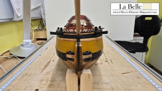

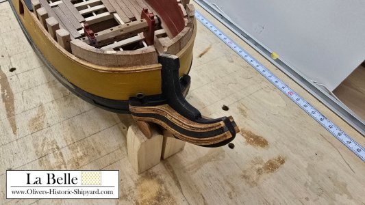

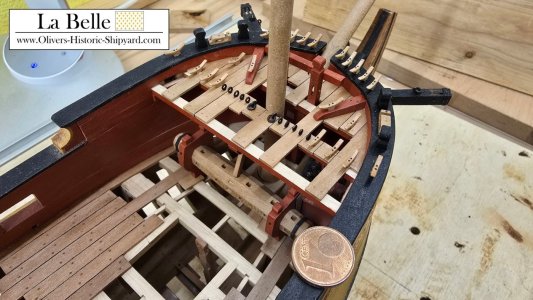

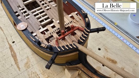

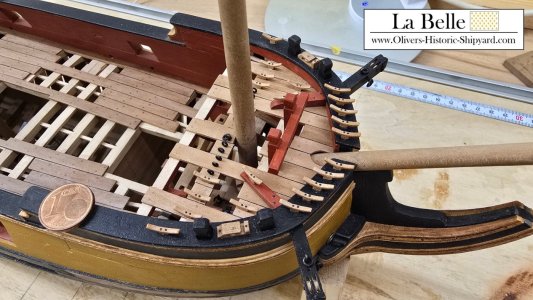

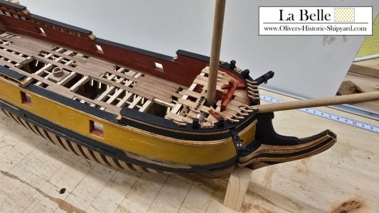

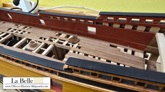

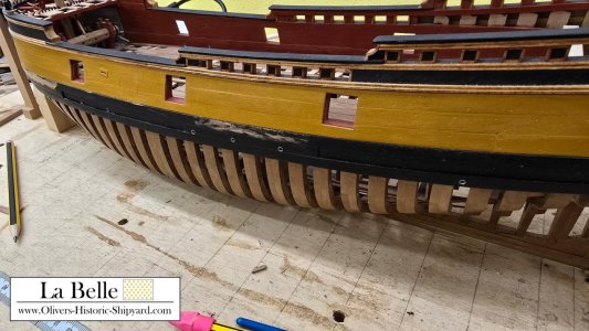

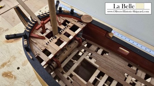

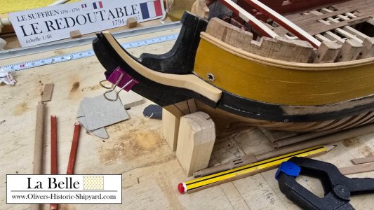

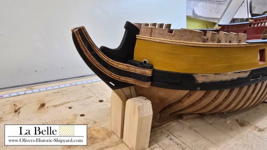

Short update: Forecastle done!
View attachment 519496View attachment 519497View attachment 519498View attachment 519499View attachment 519500View attachment 519501
my dear Oliver
the Forecastle of your ship looks marvelous Okay
