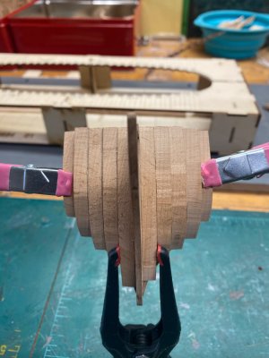

Bonjour, on voit bien les 3 épaisseurs de 'bois' sur le couple 12.
Les Sabords se situent entre les couples 13-14 et 7-8.
J'espère avoir répondu à vos questions. J'utilise Google Translate pour la traduction en français et ce n'est pas toujours très bon.

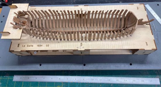

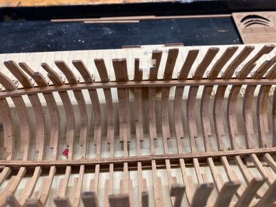

Frame clean up and initial taper day. Missing frames not seen are either being repaired or replaced. I used my last piece of Cherry today so hope I don’t need to make any more frames. To anyone planning to build this kit. It is small and the frames are quite fragile. A light touch is needed. Not a bad thing but a fact. This is the most time consuming, repetitive and stressful part of the build. Once the hull is assembled and deck clamps, ceilings etc are in then we have a strong structure to work with.

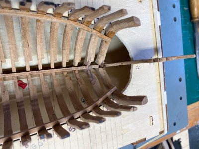

Bonjour, sur la photo les couples 13 et 14 sont installés à l'envers (il faut les retourner), ainsi installés dans le bon sens vous verrez le sabord.
Bonjour, sur la photo les couples 13 et 14 sont installés à l'envers (il faut les retourner), donc installés dans le bon sens vous verrez le hublot.
Yes ! I see it.

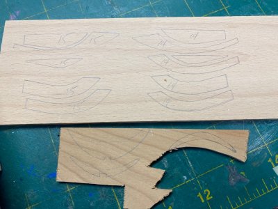

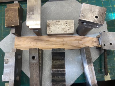

Hand sanded all the frames to get a good finish. Final sanding way in the future. Having issues with the stern timbers. Hesitant to glue them in place unless I’m sure they’re in the right place. The drawing shows a rear view but not a side view with the correct angle.

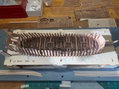

Finally some progress. I got the hawse Timbers in. Also got the deck beams and pillars installed. I’m gluing the deck planks together only this far the rest I’ll add in the ship. I see clearly the instructions with these POF kits leave a lot to be desired. I had planned to add ceilings, interior structures, etc etc not included in the kit but decided to just carry on with the kit parts, not go by the Ancre plans and get it finished but definitely not perfect. Mixing very fragile kit parts with scratch build extras just doesn’t make sense or appeal to me. I’d be better off just scratching the entire project. Live and learn !
