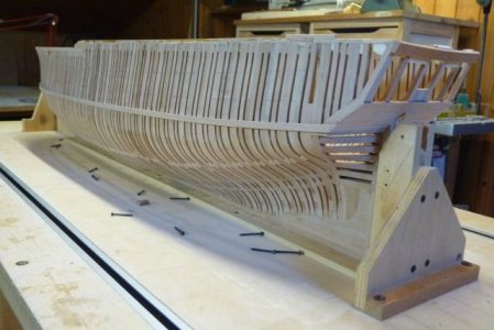

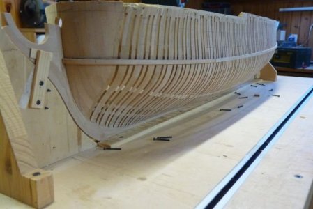

LA CREOLE 1:48 BY MATIZ
Ciao Tiziano,
Come sempre, il tuo lavoro è tra i migliori al mondo. Sei una modella meravigliosa, mio vecchio amico.
Come sempre, il tuo lavoro è tra i migliori al mondo. Bellissima modella, mio vecchio amico. Per favore, porgi i miei più cordiali saluti alla tua famiglia.

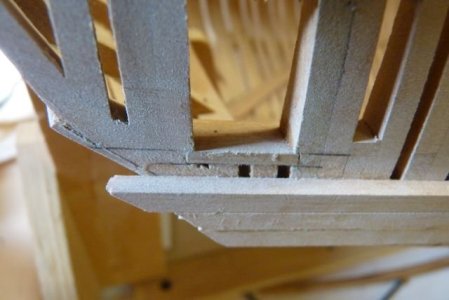

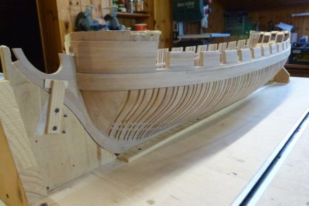

Hi Tiziano

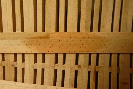

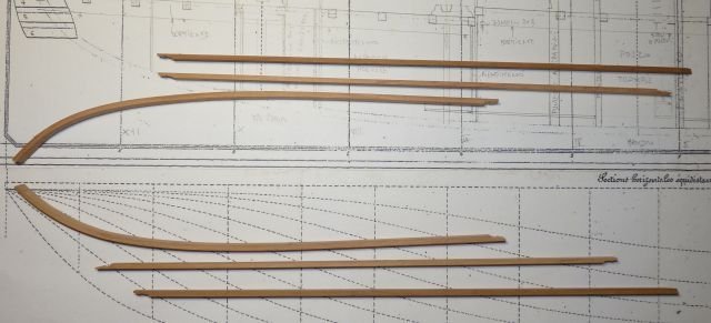

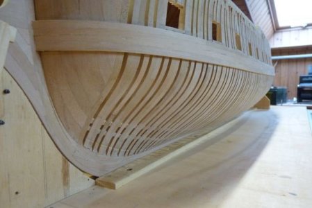

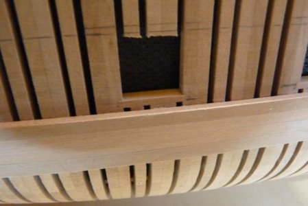

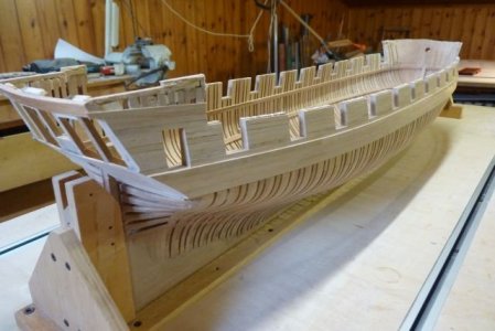

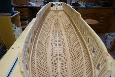

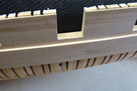

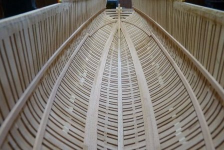

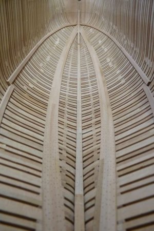

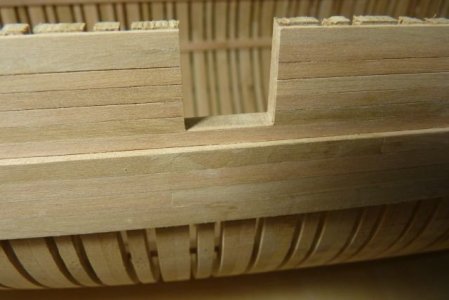

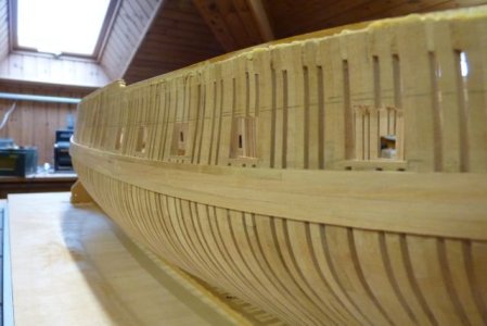

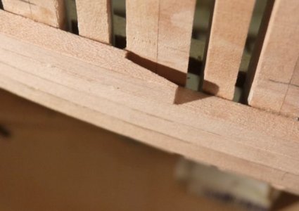

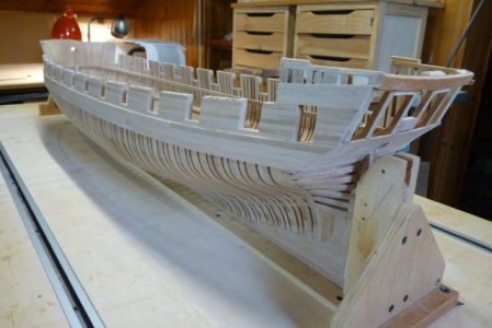

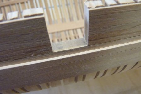

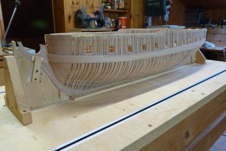

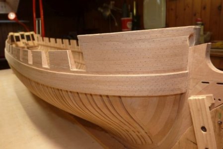

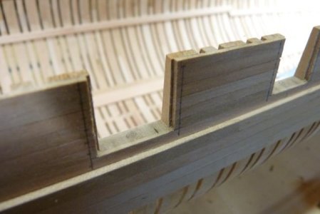

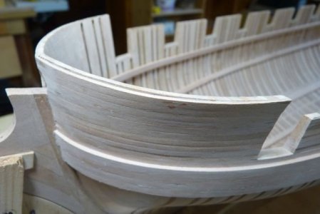

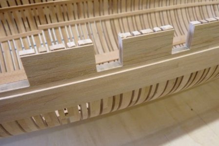

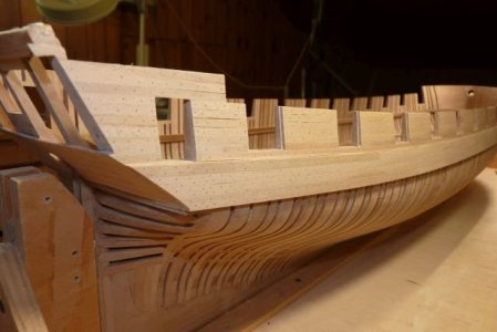

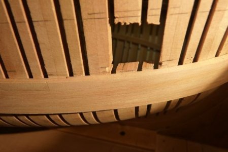

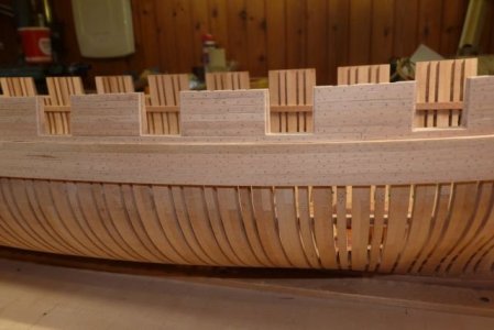

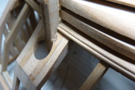

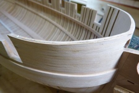

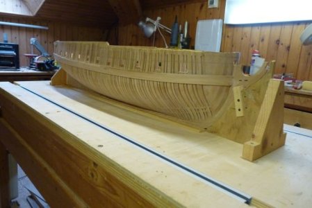

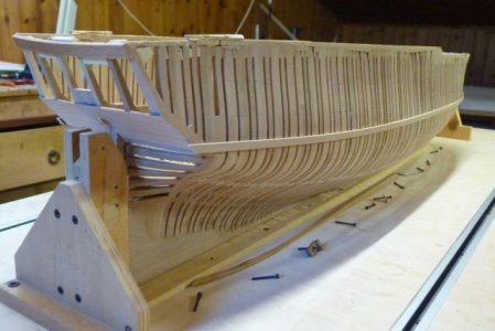

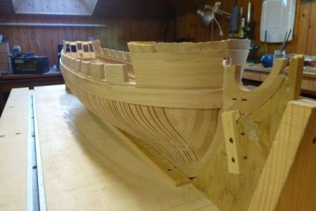

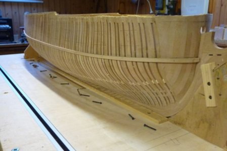

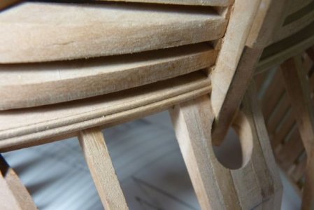

Your La Creole is gorgeous! It is hard to tell from the photos, but are the strakes already on the model the wales? If they are, do they taper in thickness near the bow so the seat in the rabbet the same as the adjacent planking like on English ships?
Ciao

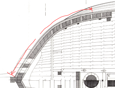

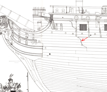

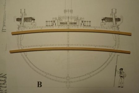

Allan I am not finding anything in my French plans that indicates the wales are thinned. Quite the opposite, in fact. On Bonhomme Richard the front section of the bow planking above the wales seems doubled up so that it is all the thickness of the wales from the stem until just aft of the catheads.
I was at work when I posted that, so I thought I would follow up with some screen grabs.
And I would just like to be clear, I am not trying to one up you, Allan, or even pretend I am an expert in anything. This is just what I saw in one set of ANCRE drawings.
