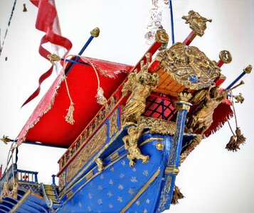

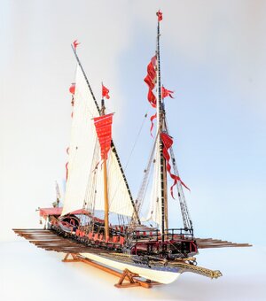

On the tour through my model ship world, I showed the galley “La Reale”, alongside the “Soleil Royal” and the “Chebec”, one of the flagship models of the French company Heller from the seventies. I built the model about ten years ago, and since then I have actually managed to save the extremely fragile ship undamaged through several moves. In the meantime, however, I've seen myself a little fed up with it, and while researching the Internet, I had an idea for a far-reaching modification. Here one picture of the finished model again.

The first change is that I put self-made windows in the structure at the rear. There are models for this in historical illustrations and plans. In my eyes, the structure looks more closed and somehow more homely.
Built oob:
Modifikation:
To be continued.
Schmidt

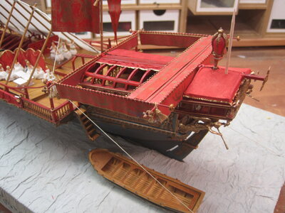

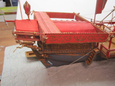

In addition to the windows in the rear, I covered the “pergola” above with a cloth in the same red. The golden fringes create a special effect. Since I didn't know whether I would like the cover, I covered the struts of the pergola with adhesive tape so that the paper handkerchief did not stick when it was dry, but could be removed. The procedure was also required in order to be able to cut the fringes into the edge.
So that there is still a view of the inside, I have shown the cloth on the other side in the folded state.
I really like the result. It's almost a shame that the pelmet covers some areas when looking from the side.

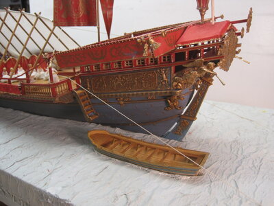

I have revised the ornaments on the stern a little by drybrushing the protruding areas with a lighter gold. In my opinion, the model of the Real was designed by the same designer as that of the Soleil Royal. I think I can recognize his handwriting in the design of the figures and the frescoes. Unfortunately, the ornaments on the galley do not stand out as well as on the Soleil. So it will depend very much on the presentation of the finished model. If possible, it should only be presented a little below eye level.
Schmidt

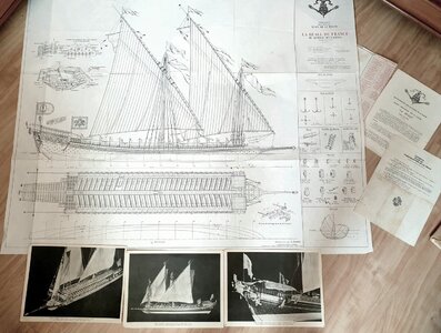

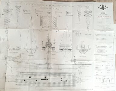

Le modèle que j'ai construit (photos que j'ai postées ci-dessus), a été réalisé à l'échelle de la monographie éditée par notre association (l'AAMM). Celle-ci était proposée (à l'époque), au 1/75e, en 2 feuilles de plans, un fascicule explicatif et des photographies d'un de nos modèles des collections du Musée de la Marine de Paris. C'est modèles de galères ("réales"), sont parmi nos modèles exposés, les plus prisés des visiteurs, peut-être parceque les ornements d'une de ces galères (Réales)
peuvent être admirés dans notre Musée de Paris. Malheureusement, celui-ci est en rénovation complète, mais les travaux avance bien, et nous espérons que le Musée pourra ouvrir comme prévu (en 2022). À ce sujet, le site du musée propose des vistes virtuelles sur le site, (sur l'avancement des travaux également) et les collections également en ligne. Tous nos autres musées de la Marine (Château de Brest, Arsenal de Rochefort (avec la Frégate Hermione qui se trouve sur le site de l'arsenal à proximité du Musée), Musée de la Citadelle de Port-Louis et de la Compagnie des Indes (Lorient), d'où dans ce lieu, a été construit, notamment le Duc de Duras, qui plus tard deviendra le Vaisseau de John Paul Jones "Le Bonhomme Richard". arsenal de Toulon est également réouvert avec ses très belles collections. Je mets pour informations, les photos que j'avais achetées à notre association (AAMM), plans en 2 feuilles au 1 / 75e
Françis

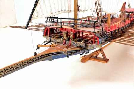

The aft deck of the Heller galley is very simply designed with transverse planks.
The original occupies a kind of chess pattern parquet here. The cover for access to the lower deck was let into it. I tried to recreate this with strips of polystyrene. I muliplied the completed puzzled part several times with silicone and resin in order to be able to do several color tests on them.
Here is the winner. Cut into pieces and relocated, the parquet part also forms the floor inside the pergola.
Schmidt
Of course, one cannot expect the noble ladies and gentlemen of the seventeenth and eighteenth centuries to step over the row benches on which the galley slaves were chained. For this reason, the crew laid planks over the rear row benches, which form a flat surface on both sides of the running track (coursie).
In the photo you can already see the supports for the awning. But its construction is a chapter in itself that I will deal with later.
