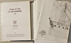

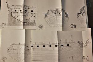

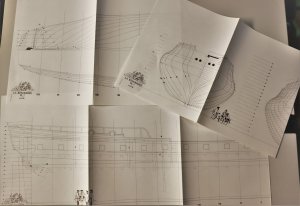

Planset Review:
La RENOMMÉE - Frégate de VIII - 1744
in scale 1:48
by Jean Boudriot
Monographie is available directly from ancre via
https://ancre.fr/en/monograph/20-monographie-de-la-renommee-fregate-de-8-1744.html#/langue-anglais
Price is 135,- Euro
There are different languages available, original written in french, but you can get the monographie also in english or italian language.
With the order you have to decide, which language you prefer.
In addition now available, and this is what I will do in short time - only the booklet in english or italian, for these which have the older french version.

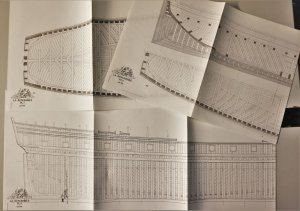

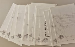

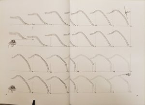

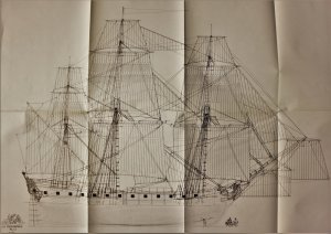

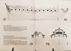

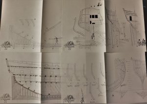

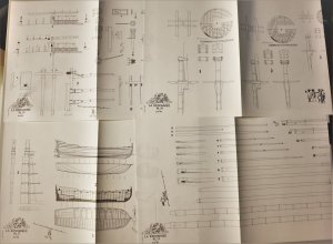

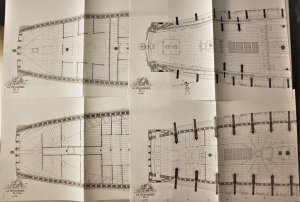

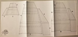

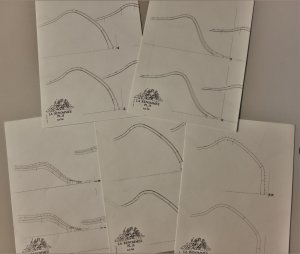

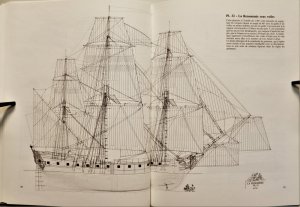

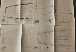

First a LOOK INSIDE of the planset with 32 full size drawings:
to be continued .....

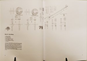

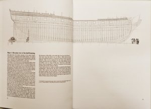

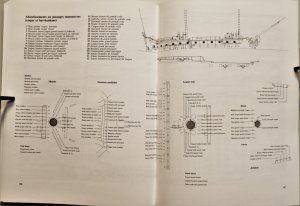

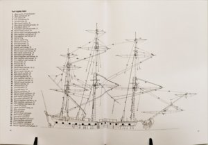

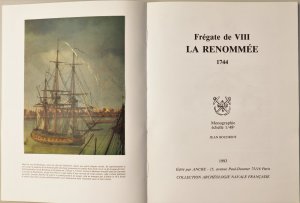

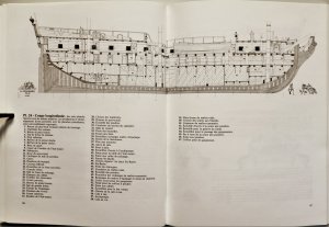

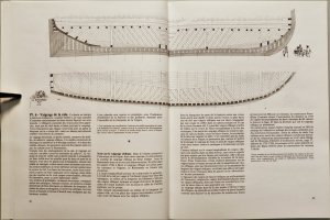

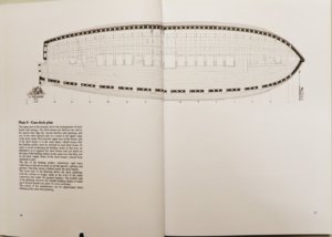

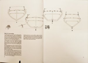

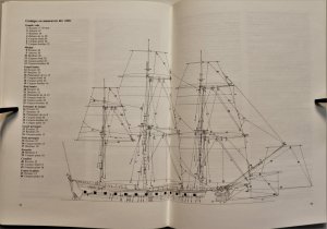

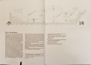

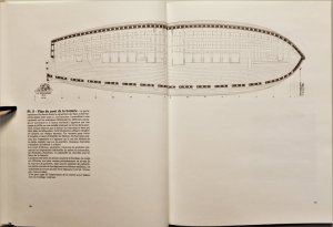

Part II - The Booklet - LOOK INSIDE

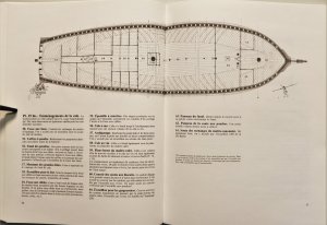

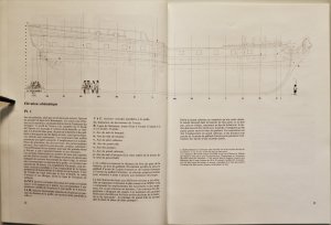

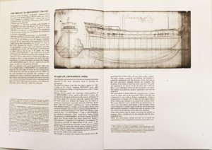

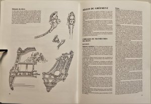

Some historic facts and information

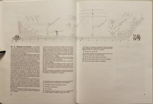

Explanations and descriptions of every single plate are given in the booklet

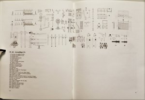

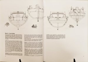

also information about the details of the interieur and the equipment and finishing

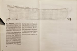

decoration are also shown

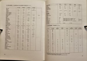

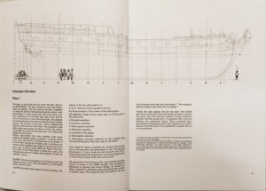

standing and running rigging details also with a belaying plan
list of all ropes and lines with dimensions

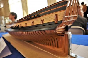

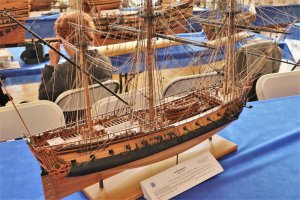

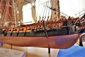

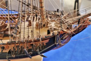

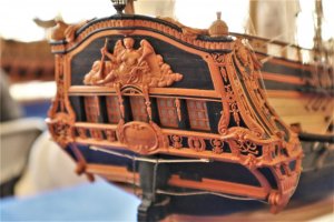

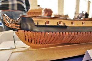

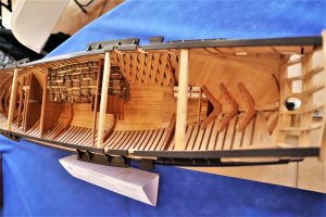

Based on this monographie from Jean Boudriot, our member Patrick Jouffrin aka @Péji is building a beautiful scratch built model in scale 1:48.
Please take a look at
https://www.shipsofscale.com/sosforums/index.php?threads/la-renommée-french-frigate-1744-1-48-based-on-monographie-from-j-boudriot.2677/#post-45919
for the detailed building log .
Here some photos of his model (in actual status of October 2018) which I made during my visit of the INTERNATIONAL CONVENTION OF MODEL SHIPBUILDING in Rochefort, France
A detailed report of the INTERNATIONAL CONVENTION OF MODEL SHIPBUILDING, also with other models (f.e. Le Saint Philippe ) you can find here:
https://www.shipsofscale.com/sosfor...nce-18-th-21-st-october-2018.2050/#post-42667

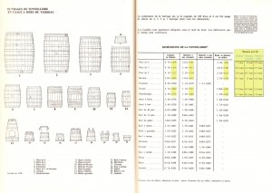

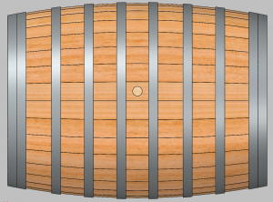

Hello,
If it helps, here is the document that served as the basis for my barrels. It is extracted from Boudriot's "Vessel of 74 guns". it is at 1/24, so print at the scale of "1". The small chart that I added gives the dimensions to 1/48 for the models that I chose to make. (You can also check against the drawing).

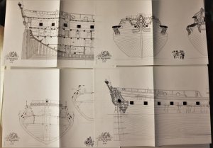

View attachment 65048 View attachment 65064
View attachment 65052 View attachment 65053
View attachment 65054 View attachment 65055
View attachment 65056 View attachment 65057
View attachment 65058 View attachment 65059
View attachment 65060 View attachment 65062

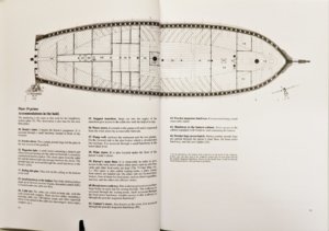

Content:
Sources and History
Reproduction of plates and comments
Note on diagonal braces
Note concerning the artillery
Note on painting schema
Note concerning the iron work
Pieces of decoration
Rigging rules
Melaying Points
Running rigging and blocks
Lower yards rigging
Looking Inside:

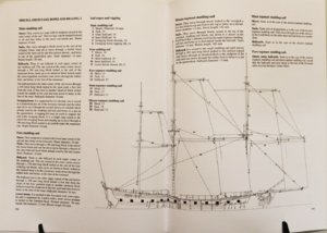

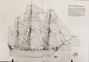

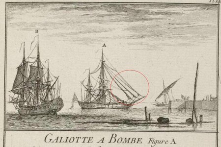

Hi all.
I'm out of one's depth but helping a friend who is constructing a model of "Renommee", I went in a search on how he could set folded jib sails on the bowsprit.
He was stuck realizing that, with all those lines guiding the antennas below the bowsprit, the sails, secure lines and many others, it would be rather difficult even for the crew of the real ship.
A search shown that the very few modelers who constructed folded jib sails, had followed the "traditional" method, setting down the sails skipping other lines...(p.e. lines on the stays, preventing the upper-top sails from chafing).
So I asked him the Monographie to take a look and I stayed on the painting of the cover (and inside). It is work of the marine painter Joseph Vernet (1714-1789) showing “Renommee” in the port of Marseille.
With my poor knowledge, I think the solution in there. As you can see the jibs are folded on the stays.
This makes me think that it could be some functional -managing "problem", folding the sails on the bowsprit.
I thought that the painter might has made a personal artistic touch on the paint but with an additional search, I found that this practice was shown also in other sketches-drawings, so it should had been something common.
Sketch from https://fr.wikipedia.org/wiki/Bombarde_(marine) and other sketches in the book “Bastiments de la mer Mediterranee” pages 35-37-42.
My French are non existence, so I don't know what in the text of Monografie is described but from the rigging plans, I don't see any recommendation on folding the jibs on the stays....
I would like to have any other opinion on that.
Many thanks
Thx
The French rigged their sails differently than the English, so the painting on the monograph's front is likely the correct configuration, especially since you found other pictorial sources of jibs rigged the same way. Also, the painting by Vernet on the cover of La Renommée: Frégate de 8, is not that of the frigate but one Boudroit found comparable to the frigate, actually an unnamed corvette. To my knowledge there exists no known picture of la Renommée, or the Renown after capture, and I've been searching everywhere (including abroad) for one for over fifteen years. The closest we can come to knowing what the ship actually looked like are descriptions of it and similar frigates built during the same period, such as la Medée and la Panthére (later the HMS Amazon). The British Royal Navy surveyed the ship a few times and there does exist a few plan drawings of its elevations on file at the NMM but without masts or rigging. The monograph by Boudroit also shows the decorative elements on the stern and bow taken from drawings by Charles-Philippe Caffieri, the Master Sculptor at the Brest shipyard that are archived there. In my opinion, rigging the jibs folded as in the pictures would be your best bet. Good luck with it!
