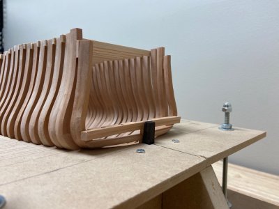

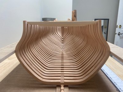

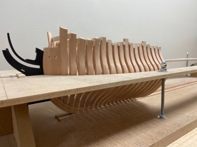

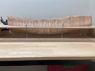

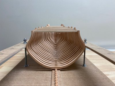

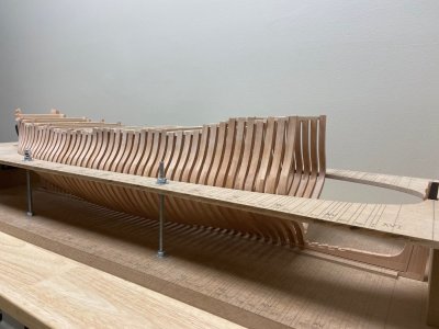

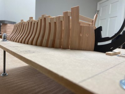

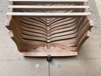

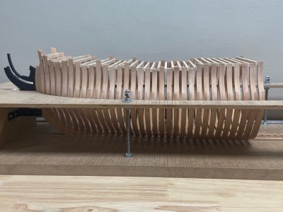

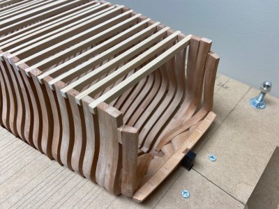

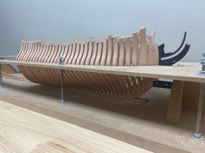

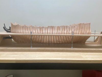

Thanks guys - I have paused the installation of frames at 49 to turn my attention to the wing transom and transom frames. I need room to work here to be able to check alignment. Next time I would have built this assembly first along with the hawse timbers before installing the frames
