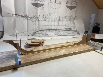

This was the start at 3rd of Oktober, where I inserted the keel to a "slipway"IMG_3975.JPG

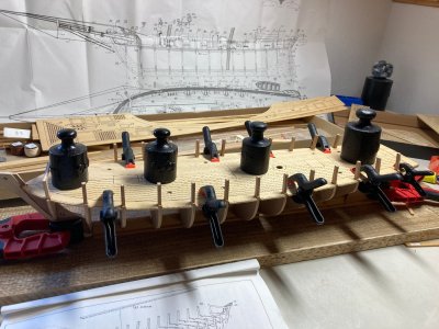

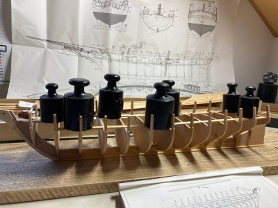

Next step was inserting the frames, which were seperated on the keel by small strips of differrent length. Remembering a lot of problems of fitting the deck building CUX87 last year, I cutted the decks and tried to adjust the frames. But two of them seemed to leave rectengular position. The mistake was the building description, wich says forut times strips of 37 mm twice 39 mm and than again 37 mm and so on. But deck and 1:1 drawing shows twice 37, twice 39 followed by several 37 mm strips. After changing that, I glued all frames in one step and adjusted them at the bottom by the keel strips and at the top with the deck.IMG_3977.JPGIMG_3978.JPG

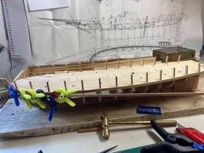

After glueing the deck, I am now working on planking the hull. The hull stripes 1,8 * 7,0 mm are long enough to cover the whole hull length.

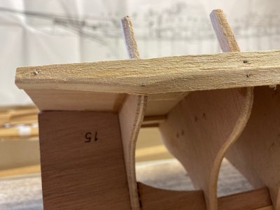

Most difficult is the stern with the second plank. The first is vertical at the end, but the second has to turn from vertical to horizontal from the last frame to the stern, which is only about 40 mm distance (see first picture). I took warm water and painted the plank several times to bend without breaking it. Also learned from previous CUX-build I took water resistant Ponal (last year I wondered why planks loosened again after glueing with classic Ponal)IMG_3989.JPG

Nice work! Looking forward to seeing your progress. I noticed you might have been in the weight business. Are they calibrated to S-1 standards? Ha ha. They appear to be 1 kilo. The old brass ones I still have in my shop.
Hello Gravman, I think you refer to the brass-hammer. It was a present from my company at an industrial fair about 1980. The interesting part was, that we had only software and computer hardware as products, but all mechanical engineers visites our both for getting this present.
