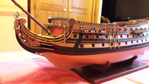

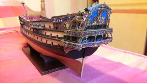

Here are two pictures that I stole from the forum Modelisme Naval Bois, made by mr. papykapi.
82978
82979
A lovely model without any doubt.
Altaya got a lot a bad critics with their Soleil Royal, bad design, bad wood and bad decorations. It seems that this model is very different and much better, they took a lot of care with it, and the moulds are not ancient moulds adapted, they are new ones made specifically for the Ambitieux.
It seems that the model was designed by Occre, if it is so, what a difference for better from the NS del Pilar. Two separate worlds. I hope it is what it promises. So far, no complains.

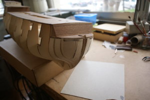

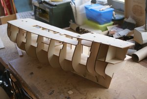

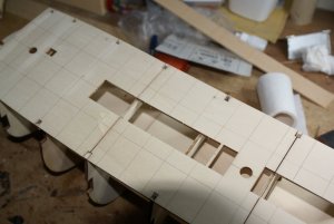

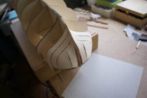

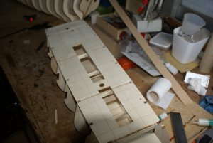

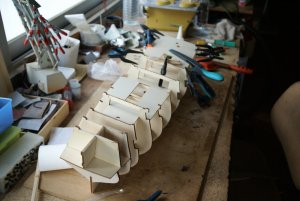

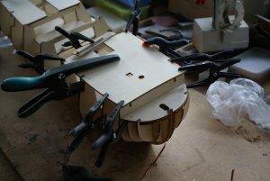

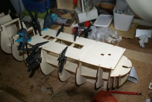

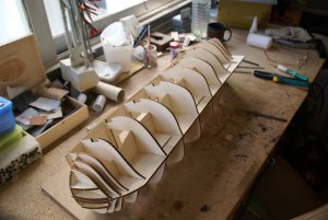

The fit of the parts is perfect and it almost goes without glue. Considering that it is designed to fit A4 measures of the issues, it turns out a very solid hull.
I am still on the hull structure, no hurries, it is going to take almost 2 years to get the complete model, so now and then to change from my other builds I give it some attention and a little advance.

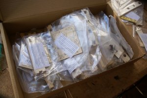

What you get for your money:
8300283020

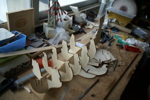

Some pictures of the building
8299082993829948299582998829998300083003830048300583006

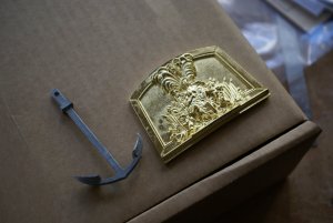

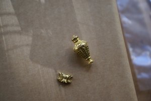

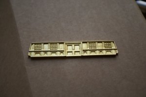

Metal pieces (note the details on the cannons)
830178301883019830218302283023

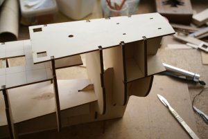

It is not easy to build a kit this way since you are never sure of what is to follow and despite having detailed photo instructions you never know if some future step is going to condition what you are doing at the moment.
So it is difficult to think ahead and antecipate alterations or problems. Being so I have just kept collecting the bags and not embark on any important step, since I may regret it later.
The lack of a plan or general drawing does not help also. You never know what is going to appear. Example: I only was sure it was a double planking ship when they started applying the secong planking and that was some 10 issues ago.

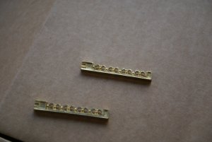

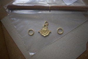

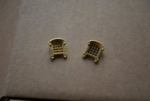

My feelings about this kit are mixed. For one part it seems well engineered, the fit is very good and it is suited for someone with less experience. The decorations are very good, in a yellow metal (not brass) with excelent detail (so far). On the other side the wood is mostly ply (good ply, but ply anyway). The rudder ios unpainted ply, and so is the stem. I know that the ship is supposed to be painted but even so the wood could be better.
---some fittings---

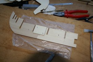

---delivery n. 64 - keel in ply and cannon---
Just a thought, if it is intended to be painted, what is the use of the second planking in sapelli?

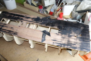

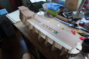

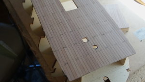

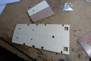

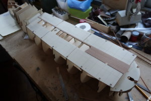

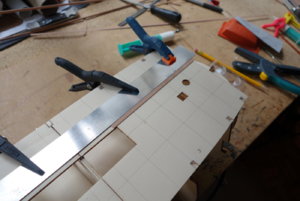

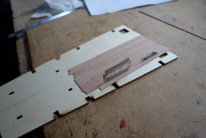

All this considered, I decided that I could start the deck planking without risking any nasty surprise latter.

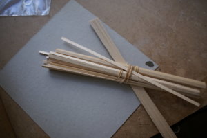

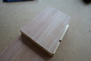

The wood they supply is of good quality but very pale, they advise you to paint it but I don't like painted wood to simulate wood, at least I can't do it, maybe there is some kind of paint that simulates wood but I have no knowledge of any paint able to do that. For me painted wood looks like painted wood and nothing else.

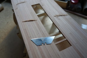

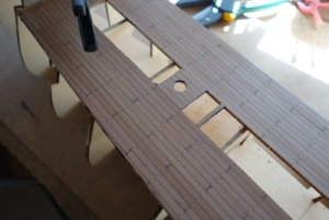

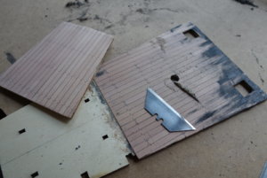

Being so and as I bought some wood from modellbau-holz.jimdo, namely pear and sapelli so I decided to use pear for the planking. Pear is a wondeful wood to work with, so far is the best wood I know and easy to apply. The pear planks varied a little in thickness, but a little scrapping did the trick and I ended with a planking that pleases me.

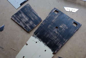

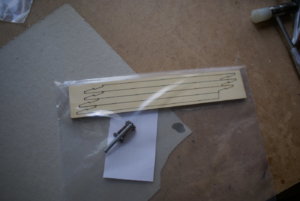

---using a razor blade to get an uniform interval between the planks---
---scrapping the pear since there was some difference in the thickness of some planks---

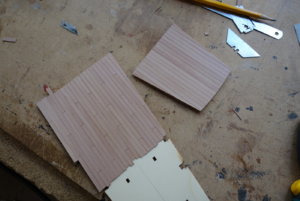

---marking the treenails---

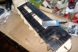

Then I used my method of pva plus black ink to get the caulking. This process is becoming easier and easier as I am getting some practise on it. Being a large surface it took a lot of scrapping, but I think I got a fine final result.
Then I filled the bow with balsa since it has helped me a lot in Nuestra Señora del Pilar and it is the bettrer way to get a decent planking at the bow (and stern).

What I am amazed with is the mfg has made the deck planking from pear. You order any milled pear! The stuff is beautiful to work with.
Rick
Yes, I bought some pear here: https://modellbau-holz.jimdo.com/startseite/zum-shop/holzleisten/
They sell it in 0,6x5mm strips ideal for planking (they sell it in a lot of measures).
And you are right, it is a wonder to work with.
