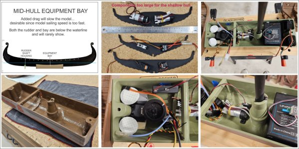

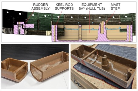

The hull design, with it's shallow draft, doesn't have room for the R/C equipment I want to use, even at this large scale. So an "equipment tub" will be added midships. It will only show below the waterline, and allows clearing the hull frame structure that is in the way of the equipment. Many other much smaller R/C longships have, I think, been built - I'm not sure how all the gear was fit in. My goal, as it was for Syren, is long hours of prototypical sailing on fairly large lakes (sailing from a kayak), requiring heavy duty design and R/C equipment.
Attached is an initial hull diagram showing some of the gear and design modifications to the Black Forge STL's. Build pics soon.

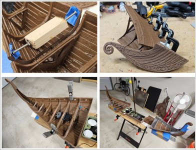

The 1/16th scale R/C build based on the Oseberg ship has made progress. The overall length will be 1350mm (53”) and beam 319mm (12.5”).
The hull is being 3D printed in ASA, a tough, weather and UV resistant plastic. The STL files for the hull were purchased from Black Forge Models, and compare very closely with the plans published in the Vibeke Bischoff Oseberg dissertation. The files were scaled up by a factor of 2.7 to produce the 1/16 scale size. 3D printed plastic was chosen for the hull because I no longer can build, or figure out how to build, the complex curved lapstrake hull. And having seen so many instances of large wood hulled sailing models exhibiting water damage over time, plastic became the material of choice. Finally, the 3D printer puts in the long build hours, requiring very little of my time or skill.
The model is so large that the hull files had to be broken up into 24 separate parts to fit the 300x300mm print bed. Dealing with the extremely large mesh STL's was painfully slow using Autodesk Fusion, eating up 32Gig of ram for processing. A few learnings along the way sped things up. The separate ASA parts are fused together with a solvent blend of MEK and acetone. Nitrile gloves and organic respirator were used, in addition to ventilation. The separate parts fuse and essentially become one.

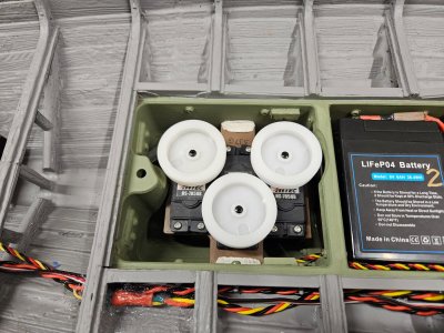

The sailing objectives for this model require a yard brace winch servo, two independent sail clew winch servos, a yard lift servo and a functional rudder servo. The use of one servo to control the yard rotation and one independent servo at each of the sail clews is based on testing using a full-scale dummy test rig with a large fan. The independent clew sheets allowed the best prototype “look” and control of the large square sail. That testing also allowed exact measurement of the line pull required for each winch servo, needed to calculate the rotation and diameters of the winch drums. HiTec HS-785HB winch servos will be used.
The yard lift servo may or may not be added, but after scores of hours sailing a 2 meter (six-plus foot) R/C brig on open water, I’ve found that the ability to douse the sails when gusts whip up or the model runs away is critical. On the brig, the fore and mainmast sails could be counter-rotated to stall the model, but with only one large sail on this model, I think the ability to lower the sail remotely will be necessary.

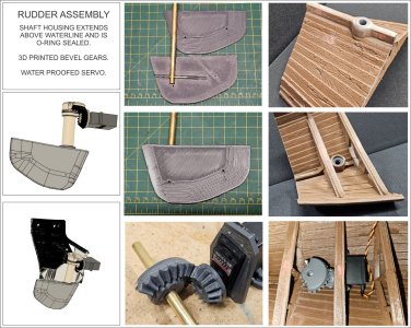

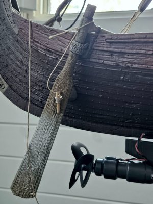

Given the length and mass of this model, the scale prototype rudder would likely not be effective, so an additional functional rudder was added to the hull. The initial shape may need to be changed after testing. The scale rudder will be static.

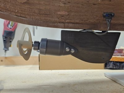

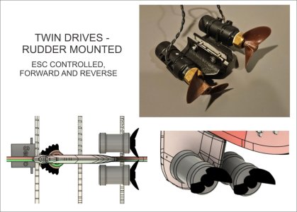

In addition, a twin-motor/prop drive will be mounted on the rudder. In our boat club shows on a small pond with many other boats around, the drives are necessary to maneuver in the limited sea-room and to avoid collisions. The motors also allow sailing past weedy shorelines out to open water.
Eventually, I’d like to add a rowing mechanism with crew. I have a preliminary design, but a lot of testing and development will be needed. And printing twenty 100mm tall Vikings that will likely weigh almost a kilogram, in addition to the mechanism weight, will be a challenge.

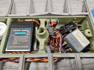

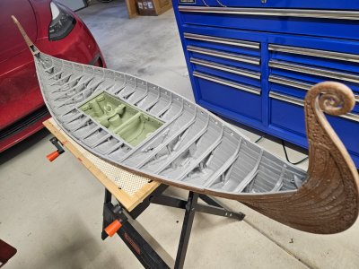

To fit all the above, along with a 6V,6Ah LiFePO4 battery, RX, ESC, rowing mechanism, etc., the very shallow draft hull needed to be modified. A midship equipment bay was added. It does not show above the waterline, and the model can be displayed without the external R/C modifications showing; the rudder can be removed and a stand and name plaque can hide the hull addition.
The two main build challenges so far have been achieving a suitable buoyancy-to-weight ratio with a lightweight hull and secondly, fitting all the R/C equipment.
Buoyancy: Because of the large, single sail area that can be very close-hauled, the hull weight above water needs to be kept at a minimum to allow keeping the center of gravity well below the center of buoyancy with a heavy and deeply suspended keel. That should help minimize knockdowns in gusty winds.
R/C equipment fit: Scale frames were printed early on to test fit the R/C gear. It was obvious that with the very shallow hull a deeper equipment bay needed to be added to the hull as shown in the pictures. The equipment bay structure will be under the waterline and should help lower the overall center of gravity.

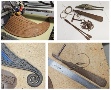

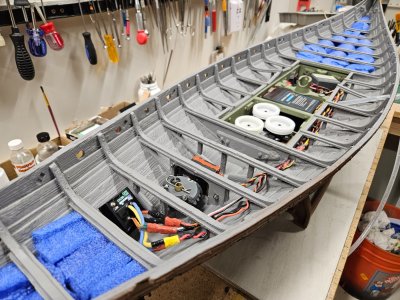

The hull sections take a long time to print – 8 to 13 hours each. They are printed in a 50deg+ heated chamber to prevent warping. Dimensional shrink has been about 1% and the hull sections have mated very closely, allowing tight fit joints for gluing and appearance. Clamps and a spreader, as shown in the pics, aligned hull sections for bonding. A fair amount of print support structure cleanup is necessary, with roughly a 70% part:30% support material ratio seen with the use of “column supports” in early print sections. Switching to “tree supports” in a different slicer reduced the print times, waste and cleanup in later prints.
The external surfaces of the printed parts are brass-wire brushed to somewhat smooth out the print layer lines and other print artifacts.
The internal structure of the 3D printed parts is porous (at 70% fill), so water intrusion needs to be prevented. Three solid outer walls are used and then the whole part is brushed with solvent to “skin-over” the surface. Multiple paint layers will also help. Krylon spray paint will be used - it has held up extremely well on my heavily sailed brig since about 2009 - 16 years now.
After the hull sections are all printed and assembled, the buoyancy will be tested, hoping for the best. The parts were printed at 70% infill and seem light enough, but if too heavy the whole hull would have to be re-printed – a tremendous setback. I should have given this more thought and research before all the printing – a real mistake.
The hull equipment bay is designed to support keel suspension rods, so ballast weight will also be tested with a detachable keel. For the keel, I plan to use a piece of flattened and shaped PVC pipe filled with lead pellets, sized and made after initial ballast testing.
The rudder, servo and gear mechanism has been printed, assembled and tested.
The twin motor drive from my R/C brig, Syren, will be used on this model. It only needs to be fitted to the rudder. The drive mounted on the rudder gives very high maneuverability on a large model, needed in small water bodies, around other models, to get to clear, non-weedy sailing areas and to get to shore if winds die or sail control fails.

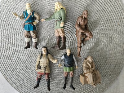

I'm still looking for STL files for figures to be used as Viking oarsman. I have one set, but there are only three different figures and they are in helmets and armor - an unlikely look for working oarsman. Any hints on sourcing a crew would be much appreciated. Thank you.
The hull, except for details and paint, is finished and R/C equipment temporarily fitted.
To check the waterline, the hull was floated on open water at sailing weight with all equipment, mast, yard, keel and external drive onboard. Since the decking wasn’t made yet, the open top hull was sealed with tape and plastic wrap. The waterline was good, but some keel weight will be removed to allow for deck, crew and on-deck detail weight yet to be added.
It was a windy, wavy day and the single motor/prop drive was a bit underpowered, so a twin drive unit will be made.

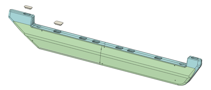

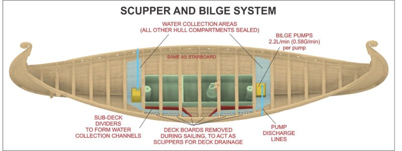

The next big issue to address will be how to remove deck overwash because the hull provides no way to drain water from the deck.
When R/C sailing, ship models are often “knocked over” by varying wind and wave. This hull, having both low gunwales and oar ports that are very near the waterline, will allow significant deck overwash as the hull heels over. Since the hull has no scupper or deck drainage system, overwash will lead to swamping and possibly foundering and sinking.
A swamped deck could hold (below the open oar ports) a roughly measured 3L, 6kg (0.8G, 6.7lbs) of water. That is more than half of the total model weight of 5.5kg (12lbs). Oar port covers will likely be installed to reduce water infiltration, and that will about double the volume of water that could be held on the deck if no drainage is provided.
The planned solution is to seal the decking so that almost all the below deck volume will be water/flood-proofed to maintain buoyancy. Very limited areas below the deck will be isolated to form water channels leading to fore and aft bilge pump chambers, as shown in the drawing (shaded blue). When sailing, the outermost starboard and port deck boards (dotted lines in the drawing) will be removed to allow water to drain quickly to the channels, to the bilge chambers and then pumped overboard.
The combined pump capacity is 4.4L/min (1.2G/min). That rate would clear a 3 liter swamped deck in about 40 seconds, a long time when sailing a model boat, but will hopefully be fast enough to handle typical overwash. The pumps have built-in on/off water sensors and reduce the water levels in the bilge chambers to less than 6mm (1/4 inch).
A promising feature seen in this model, with its very shallow draft, wide beam and heavy suspended keel (2.8kg (6.3lbs), is a very high resistance to roll. When first tested in the water, the mast was rocked side-to-side and the hull was very laterally stable. That will hopefully decrease the frequency and amount of deck flooding.
The sub-deck dividers will be printed and installed, the pumps and temporary decking installed, and another test sailing with manual deck flooding will be done next to see how this approach works.

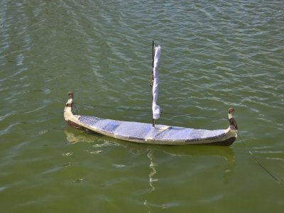

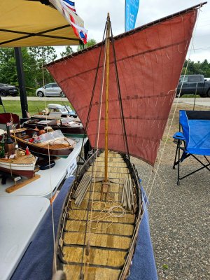

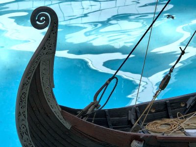

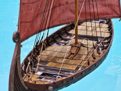

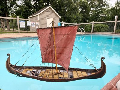

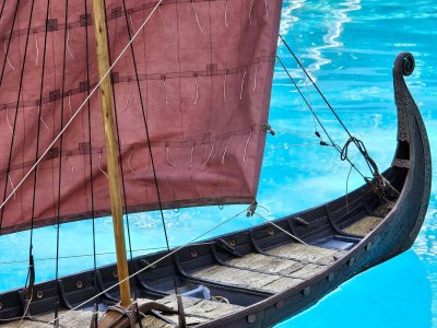

Failed to keep up with build posts, but now about 90% complete and pool testing successfully completed.
Not very good pics,with some deck panels still not placed, benches, figures, prototypical details, etc not yet added, and with no background staging, etc.
But the pics do show various views and parts, just to get some content posted.

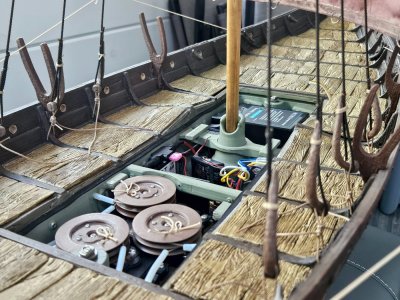

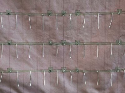

The 3 servo sail control scheme - yard rotation combined with separate sail clew fore/aft/stbd/port control - allows getting the single square sail into a semi-lateen shape that I interpret from the various videos and from a comment by the captain of the Saga Oseberg that the clews are never set wider than the beam. Testing on land outside in the wind confirms that a the square sail can be very efficient used this way, and can bear into the wind fairly well.

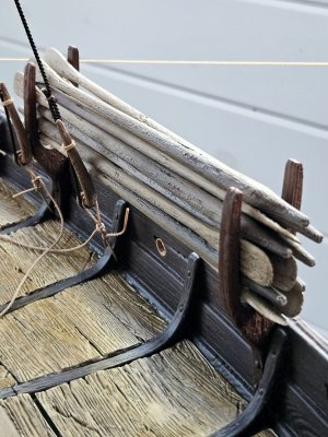

The sail control rigging catches in the oar racks and oars, so they are removeable. The racks snap into place magnetically - easy on, easy off.
The keel weight has been rebalanced and the hull is level in the water.

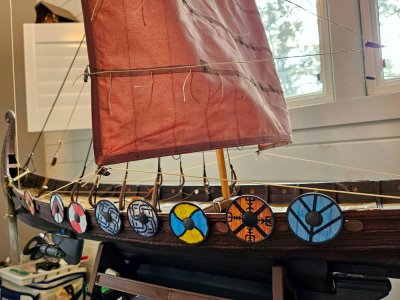

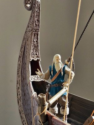

A few crew members have been printed using Meshy AI to generate the viking crew poses verbally described. I'm adding an old, seated woman, representing the old woman buried on the ship who was likely the ships owner.
A method to make shields with inkjet printed patterns. with grain and board detail and with separate detailed rims was used to make a first run of test shields.
The sail turned out a bit dark, but my experience with other models is that it will look much lighter in the open water in the sunlight.

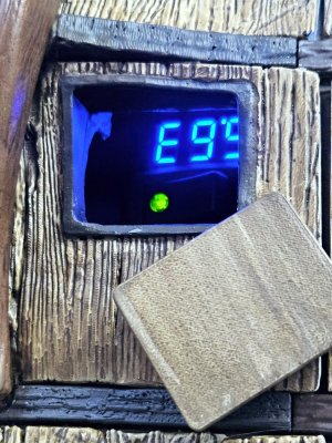

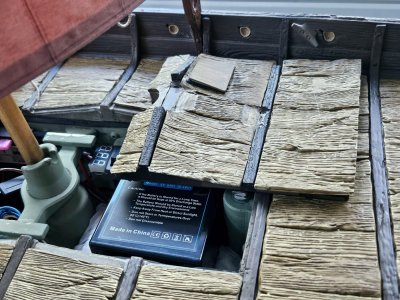

Sealing the deck panels that need to be removed for equipment access still needs a little work. The water leak alarms in each hull section and the bilge pumps work perfectly.
Stability to roll is better than I expected, likely due to a lot of weight below the waterline in the suspended keel and the equipment bay.
Maneuverability is acceptable with the enlarged rudder, and very good when the rudder mounted drive is used (as it will be in the small, crowded ponds of our club shows.)
The big question is how easy it will be to sail in varying open-water breezes and chop.
The build started about November of 2025, and I hope to finish by this November and start to learn to sail her.
