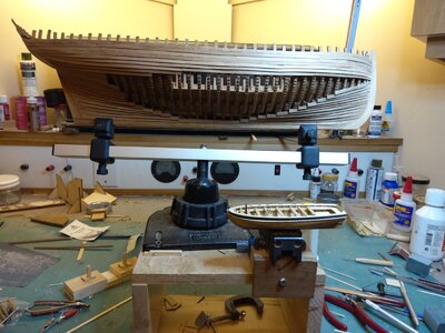

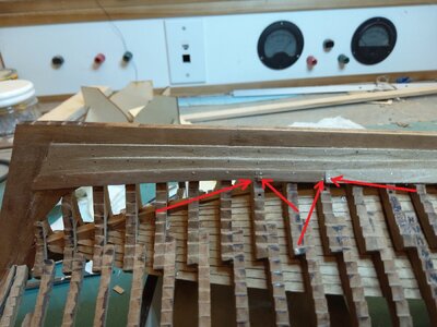

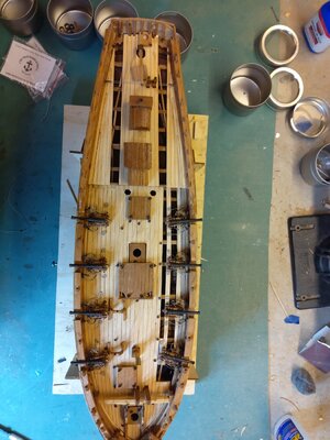

Your start of the planking with nailing is looking very good.
A small hint which will reduce some of your work.
On such clinker planked hulls there are only two nails at a plank-joint - one on each end of the plank
The second row of nails (here marked with the red arrows) is not necessary, due to the fact, that the plank was secured by the next row
I am very happy to see, that your break on the Coureur work ended !
Did you also finalize in the meantime the hull planking on the other side? very good progress - I know, that this work is really taking a lot of time.

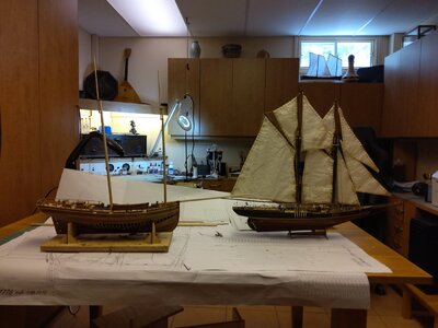

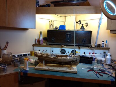

The boat in the front is not from CAF, I think. Who is the manufacturer? Looking very good
tks for your support
i got one question , my admiral is a quilter and would do my sail ,there are not much instruction ,is there instruction from caf or other source how to make sail.
from the photos of your sail we can not see the type of stich that was use . is starch ok ,
