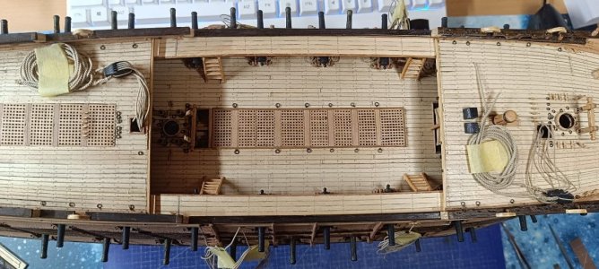

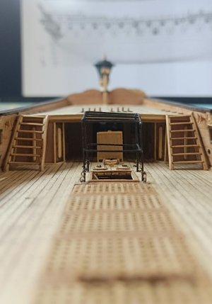

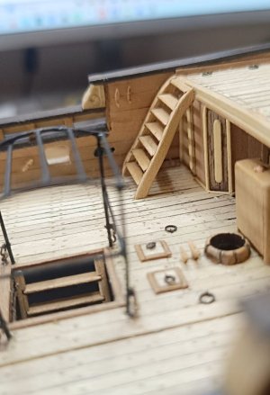

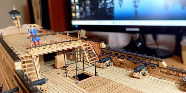

Slowly but surely the deck equipment is coming to an end. The last deck that I was missing was the Gangway and its stairs.

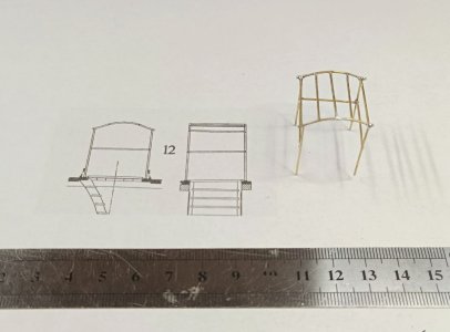

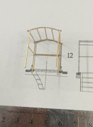

For me, soldering is probably the hardest thing. I'll probably never learn it, but I'm glad I managed to do it this way.

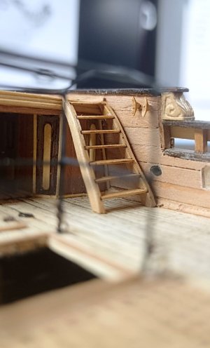

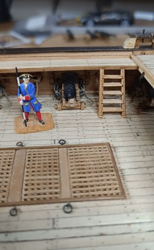

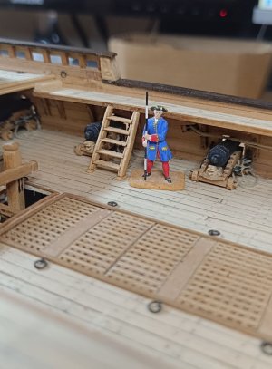

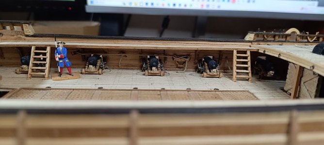

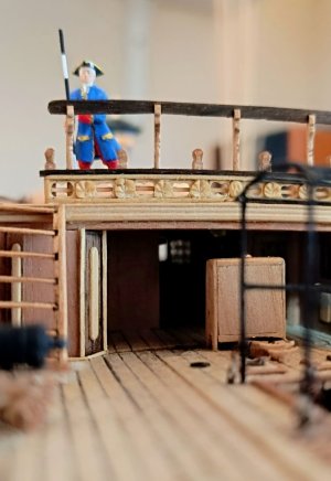

Well, here are the last two stairs (ladders) to the top deck.

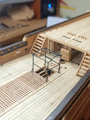

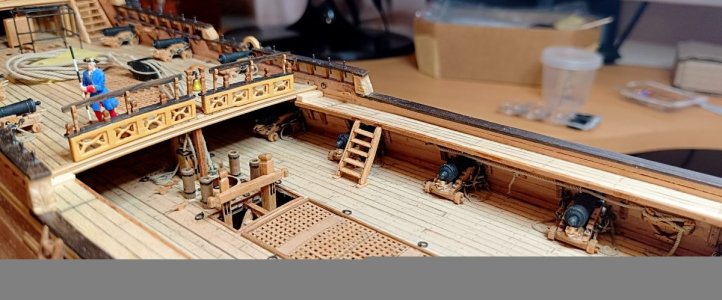

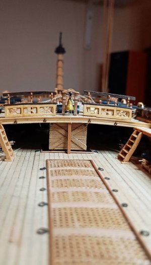

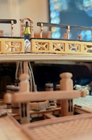

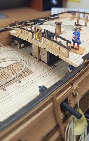

Since I had all the decks finished, I started installing the interior railings. First, I glued the previously made front railing, including the large bell.
Potom stredné zábradlie s malým zvonom.

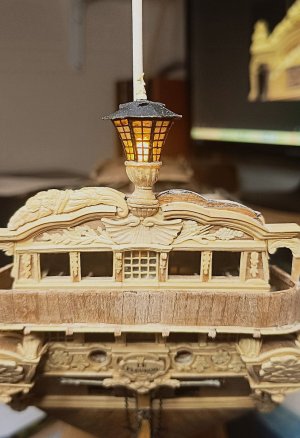

And finally, the last one at the back. That was probably the hardest for me. My imagination had to play a little, because my skill failed. The carved decorations are my invention and I strayed quite far from the original. I am convinced that there are people who can do it, but I am not one of them. But on the other hand, I am glad that it turned out this way.

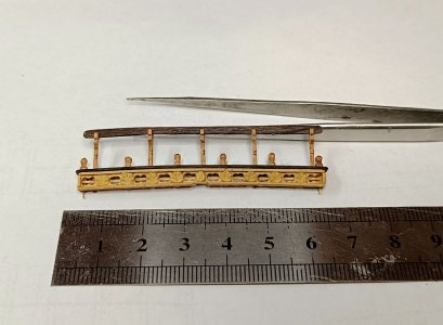

Just for comparison with a ruler.
Then a middle railing with a small bell.

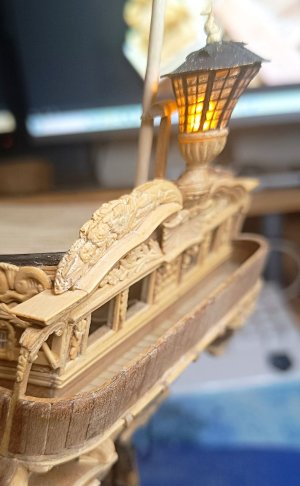

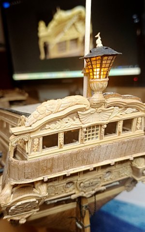

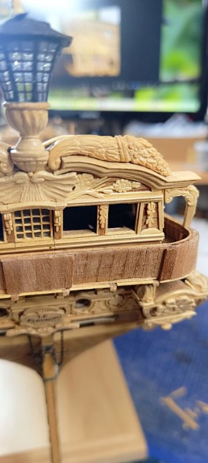

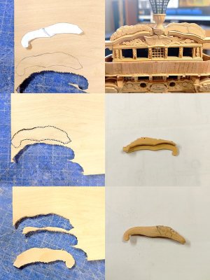

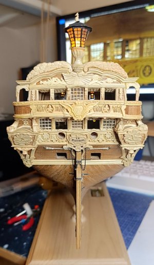

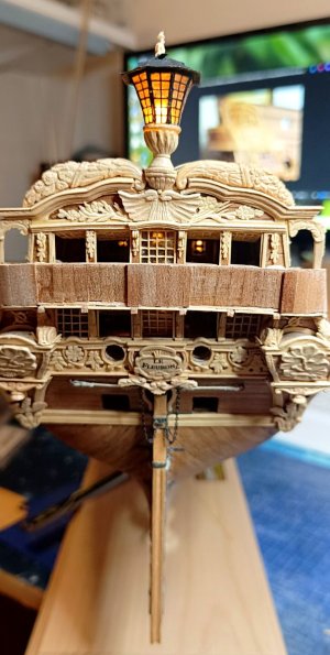

I finally forced myself to finish the second bouquet, which complements the back decoration by the lantern.
I don't really like repetitive work, I prefer to always do something new.
Here is a small overview of the work on the bouquet.
And here is the result

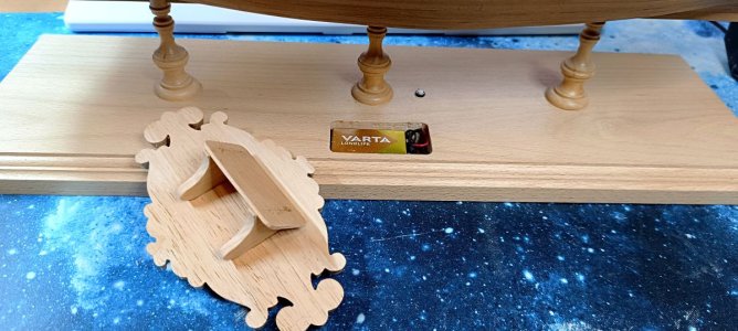

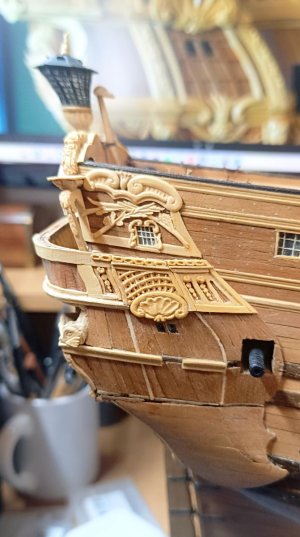

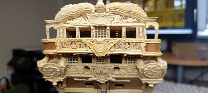

And now, I have thrown myself into decorating the side of the balcony. I wonder when I will get around to doing round two on the other side

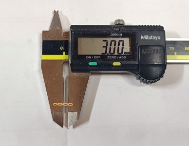

Just to give you an idea of the dimensions.
