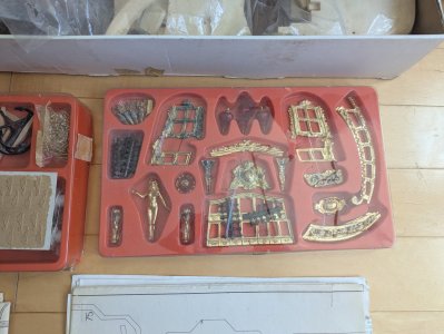

The kit seems very old and needs cleaning. The metal parts are losing gold plating, so painting is a must.

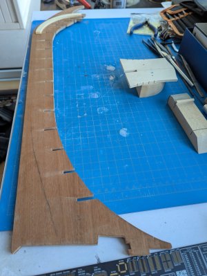

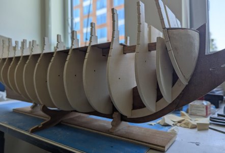

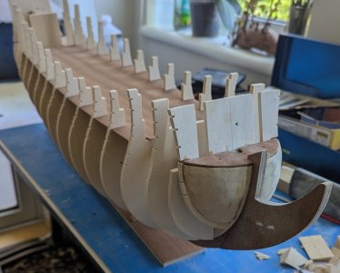

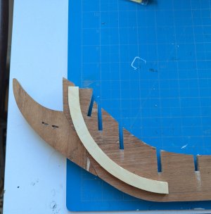

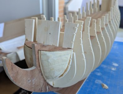

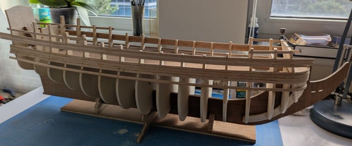

A little bit of progress, Shaped the fillers to fit the bow.

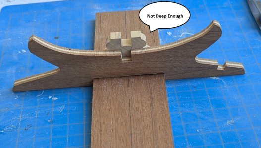

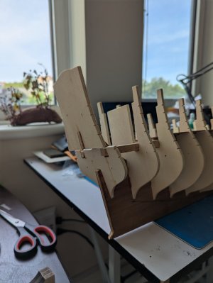

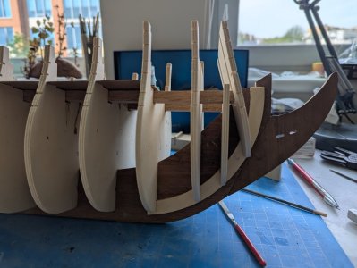

Decided to assemble the base to use it as a keel holder for now. After gluing the two ends, figured the depth of the center piece is much lower. So I decided to cut the two ends to make them the same height as the center piece. It actually works perfectly, and now I can use it to hold the ship while working on it.

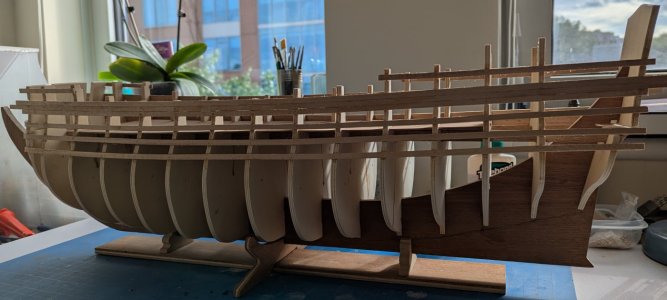

Got a chance to do more work on the model.

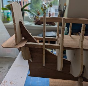

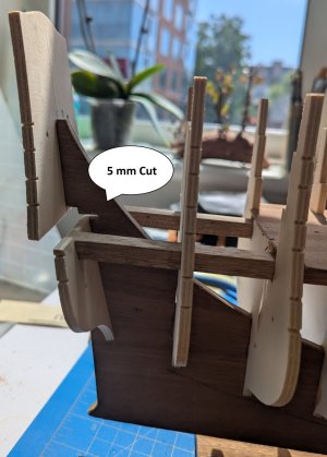

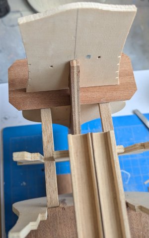

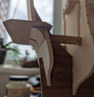

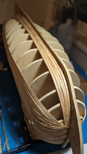

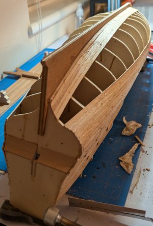

First starting from the stern, I noticed for the lower balcony to fit an extra 5 mm cut in the keel was needed. This was measured from the designs.

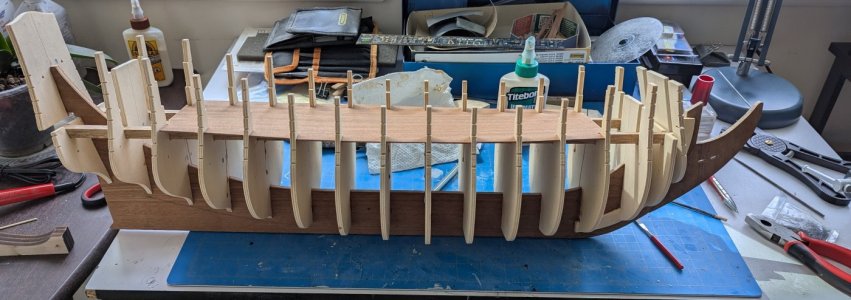

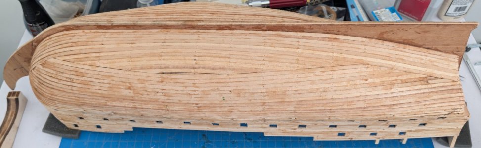

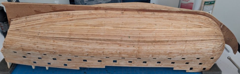

Then started with first layer of planking. On one side I followed the instructions, and on the other side followed my gut. The latter saves me more headache later on.
Side 1:
Side 2:

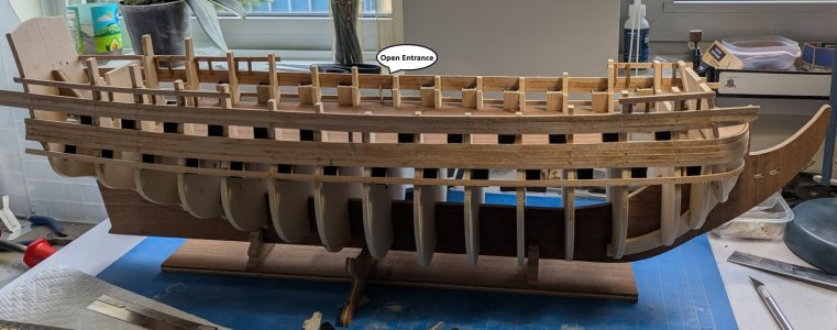

Then installed the gun ports. However, I made a change here. For the entrances, instead of using a closed port like the gun ports, I decided to have it open, and later on I will plank the floor to look nice.

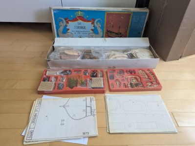

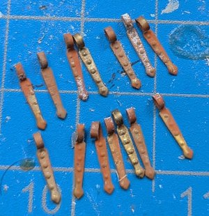

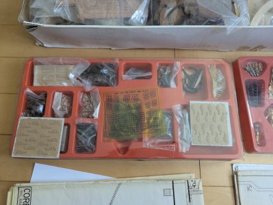

I bought Mirage from eBay about 2 months ago for $260. I think it was a good deal. It seems to be complete as far as I can tell, the only missing parts I noticed are the cloth flags. Also, I think the kit was kept in a humid area, because some of the wooden parts were bent a little, including the keel (which I could fix with steam iron), and the cannon door hinges show corrosion damage. I will try some acid or base to see if I can clean them, and if successful, will paint them.

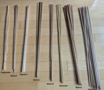

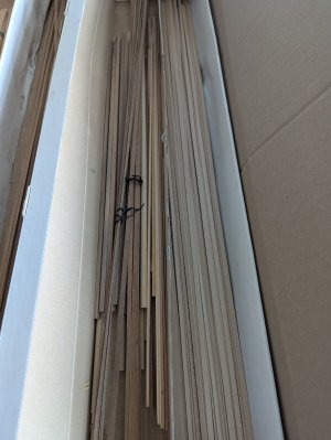

The wood stipes were mixed, and it was a little challenge to identify what I have. I tried to organize them and identify the types based on the instructions (not sure if I am correct):
And here is the rest of the wood strips in different thicknesses and also masts:

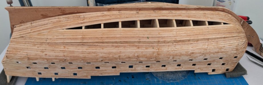

I had a little bit of progress during the past 2 months.

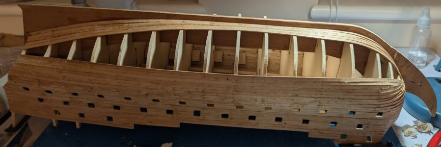

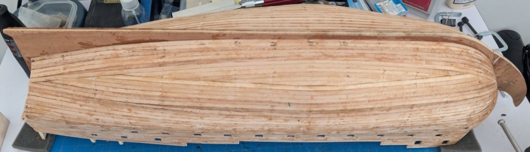

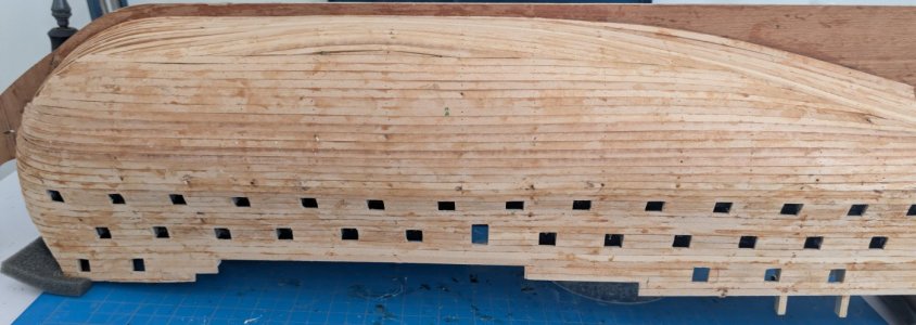

First finished planking of the gun port rows. Due to bad adjustment, some ports were narrower than the others.
Second, finished the front curve, and corrected the size of gun ports
And lastly, drilling holes for half gun barrels. Also in the process I learned that the 3rd gun port from the top row is shifted a little bit more, so did some cutting and gluing to move the port to the right location.
