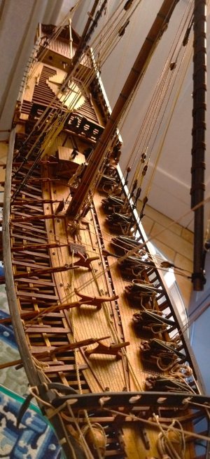

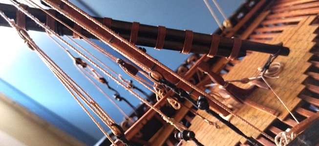

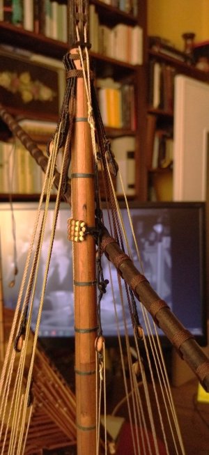

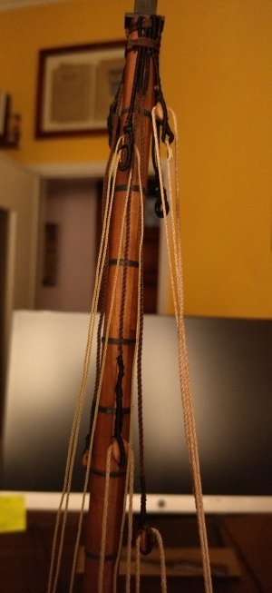

While still waiting for ropes to arrive, I began to work on masts.
Here is the initial build of the main mast: material to work on and the first building steps.
It is similar to the construction method in reality, like a puzzle of pieces joined together to form a square, from which must be obtained an octagon and finally a round pole.
I will make the octagon out of it using the bench saw and finally the round pole with the lathe.
However I'm wondering why a trimming of the mast is not foreseen for this ship. Hoping they weren't made as a single piece, right in this case which is the first time I'm building them this way. Thinking out loud, the length in reality was 23 mt., it was not possible to find such a kind of a trunk , but why all the versions of this model do not have the trimming, neither the one by Boudriot?
The octagon.
I made research about trimming of the mast and spoke with Carlo Cavaletto, a real expert about hystorical wooden ships (b.t.w he made the projects of Sovereign of the Seas for DeA, the most accurate drawings about that ship). So Went to look Boudriot drawings and trimming is absent, he spoke with some great modelers and they said they did not either thought to this detail as they all followed Boudriot's drawings but the issue is real. The main mast was 23 mt. high and had to hold a spar 36 mt. long, so there is no way to make a mast like this other than building it in sections, therefore it needs the trimming too.
SO I decided to make the trimming because it makes sense, it will be the first xebec with trimmed masts in recent history.Redface

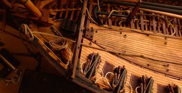

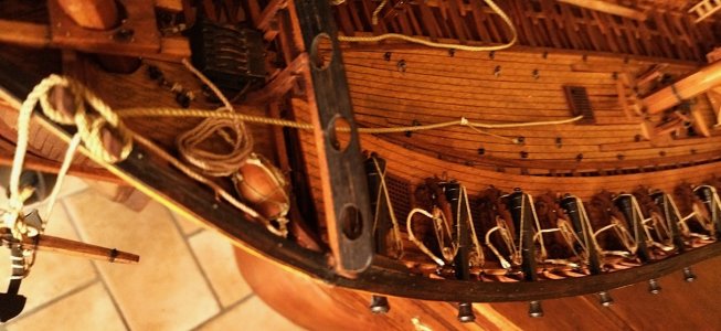

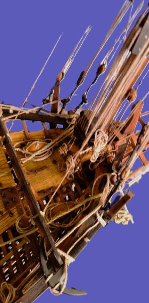

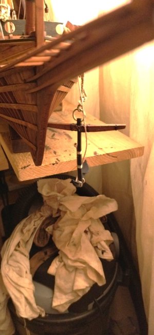

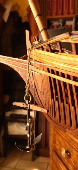

One of the anchors is finished but still not fixed yet. Well, the harness of the buoy got me crazy, I have to find a different method to make the other one.

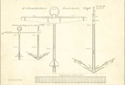

I have to say, I am truly impressed with the overall quality of your anchor. It is a fine piece of work. That said, I did notice that the stock seems to be positioned upside down. I hope you do not mind me pointing it out. Of course, it is entirely up to you, but I feel that such a beautiful model deserves an anchor with the stock placed correctly. If you ever consider a small adjustment, it could make a great model even better. ;) Here is how the stock should be placed.
Aaaah! I didn't realize of that, will try to fix it.
Thank you.
fixed. Thank you, it was a bad inattention.
