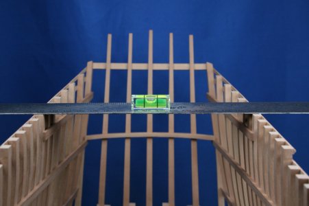

In order to provide some additional strength to the stern assembly I have now added the deck clamps. There are five formal decks on the aft portion of the Saint Philippe. From top down: a poop deck, a quarterdeck, and the 3rd, 2nd, and 1st decks. There are also some deck structures below the first deck, but they don't have deck clamps.
Each deck clamp is dimensionally different - and the clamp for the 1st deck is quite substantial (indeed, it had to be fabricated as a curved piece - bending it to the shape of the hull would have been impossible)..
Students of period French Naval Architecture know that the deck beams are joined with their respective deck clamps via blind dovetail joints. As you will notice in the images below, I have chosen to omit that detail. Once the beams have been installed the dovetail joint is invisible - and while I am not averse to including details that will ultimately be hard to appreciate (see my Kingfisher build) - the additional complication just didn't seem worth it.
Adding the deck clamps is a fairly serious matter and required careful measuring. I guess only time will tell if I got everything in the right place.

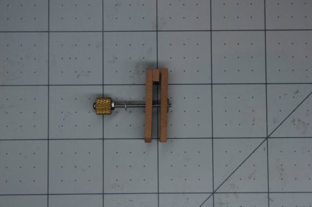

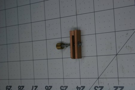

this is amazing. As always, indescribably cool and soooooo cleanly built. Respect. By the way, how did you make the clamp? A little tip would be great ...

Greetings, Gunther. The clamp is very simple. M2 threaded screws, a knurled turning handle, a nut to hold the turning handle in place, a washer, and an integrated nut. I have both 35 mm and 25 mm (roughly) screws and a total of about 20 of these clamps - that seems to be enough for the way I use them. The wood is just from scraps.
I can't imagine building a POF model without something similar.

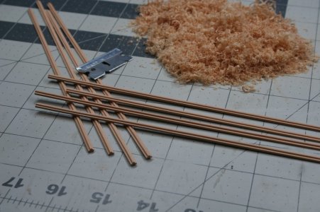

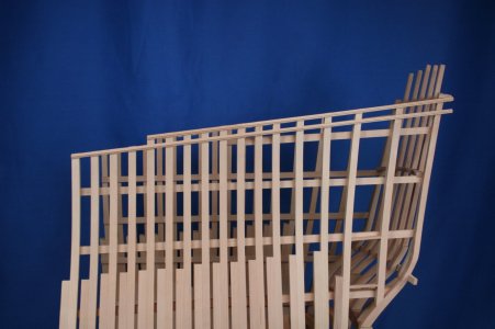

This week I completed the stabilization of the counter timbers with the addition of two rails. But not just any two rails - the rails that establish the top of the frames. Once again this required some very careful measuring - followed by even more careful cutting - followed by even more careful sanding to make the tops level and straight (without which the cap rail won't be situated correctly).
Of course, the rails first had to be profiled:
