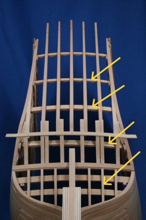

Over the past week I have continued to add components to the stern facade. Three more aft deck beams were installed along with six vertical stern counter timbers. I marked these elements with arrows...

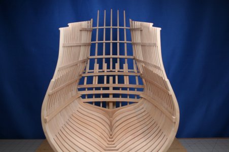

A keen eye will notice the apparent 'thinness' of the fashion timbers - especially on the starboard side. Here is a closer look:
This thinness is an illusion of sorts. While installing the stern counter timbers (again, the six vertical pieces) it became quite clear that I had the fashion pieces either fabricated incorrectly or installed incorrectly. I can't explain how - but relative to the wing transom (the large horizontal timber at the top end of the counter timbers) as well as to the rabbet in the sternpost - the fashion pieces were either too far forward or not wide enough (when viewed from the side).
I thought about taking everything apart and trying again - but then reason took over and I decided to just laminate a thin layer of wood to the aft surface of the fashion timbers. Since it would be virtually impossible to fair the inner/upper surface of the lamination, I made it narrower than what I was laminating it to. Once the counter is planked this will all disappear.

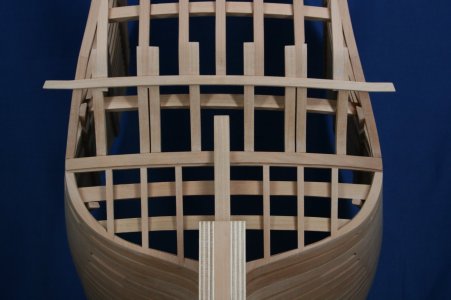

Here is a view of the lamination from the side - I think the fashion piece now has an improved appearance (more robust):

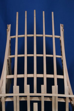

Here is a closer look at the upper counter:

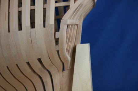

And now from the inside:

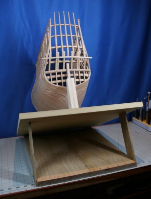

I have always struggled to work on the stern of the models I have made. On the Vasa I ended up standing the ship vertically on the floor with a pillow cushioning the bow - and on the Kingfisher I sat on a small step stool with the ship above me on my worktable.
I have LOTS of work to do on the SP stern, so I made this gizmo. I think this will be a good solution...

Sometimes there is a great lack of a large manipulator-holder of the model so that it can be fixed in any position. But as a rule all this is done on the knee ROTF
great job as always!
Yup. This one has a limited range of usefulness. But if all you’re making is a stern section…
Early experiences have been good. I’m sure I’ll modify it as I go along.
