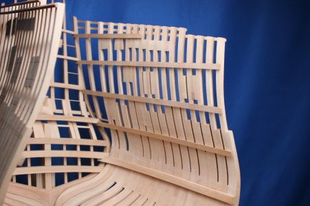

With all the filler blocks in place it was necessary to re-fair the hull (adding enormously to my level of dissatisfaction with this current operation):

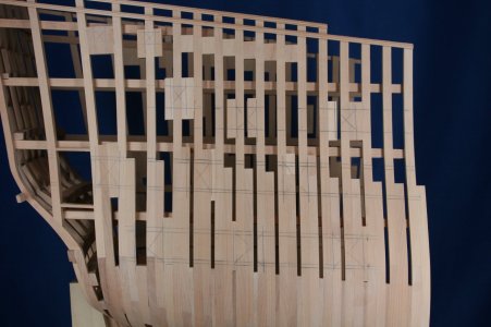

With that done, I could complete the layout of the gun ports and a few lights:
On the Kingfisher I really struggled creating accurate gun ports. I hope to improve upon that earlier effort this time around.
I would love to report on the magnificent progress I have made since my last posting - but mostly I have been installing 'fillers' that are a necessary addition to the framing to accommodate the gun ports. While necessary, I have found this phase of the build to the remarkably unsatisfying.

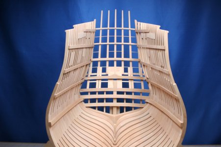

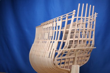

I have also roughed in the helm port and fillers associated with this portion of the framing:
This last bit will require some additional fine tuning (fairing / sanding) but that will need to wait for the fabrication of the rudder...

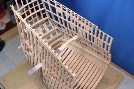

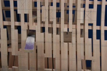

If anyone has a better / easier / faster way to do this, I'm listening...
Your method certainly looks effective. No matter how you do the rough cut out you still need a controlled method to fine tune the opening. Drilling a large hole then using a small model size reciprocal saw may speed up the process but you don't have that many to do.
Ah, a substantive suggestion... That would certainly be faster! Of course, you're right in saying I don't have that many to do: 18x gun ports and four small windows is all. But I feel like I am working harder, not smarter and find myself wondering if there is a better way (it takes me between 60-90 minutes for each opposing set of ports). People have done 100-gun ships at this scale - surely they aren't spending 50+ hours just cutting out the openings (never mind installing the sills...). Or maybe so...
