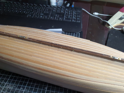

Check out my Endurance build. the Power source dose not have to be in the ship. It can be in the base and conduct through the base supports. I got this from another build on this site and it works. problem solved
Thank you so much! I saw your Endurance build and I think I understand how you did it. If I'm not mistaken, looking at the photos, you soldered the two terminals of the entire lighting system (positive and negative) to two metal plates attached to the keel. Then, connecting the two metal supports on the base to the 12V battery completes the circuit. This way, nothing is visible and the circuit activates simply by placing the hull on the base. Simple, effective, and clean. Congratulations!

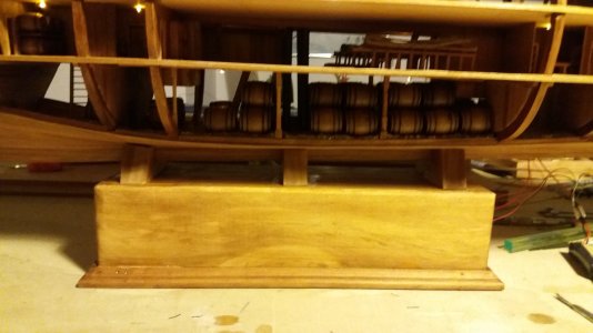

I put LEDs in the cutaway of the Soleiel Royal I did (I used LEDs from Evan Design). I used a hollowed out block for the ship base. The wires come down through the interior and the battery pack/on off switch slide into a cavity in the block. Normally a clunky base wouldn't work, but I also wanted height so it would be easier to view the interior.

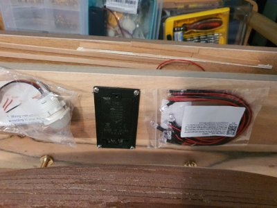

Funny you should mention a "remote Switch", because I also purchased a remote detector with the idea that the ship lights would turn on when you entered the room. Photo is upside down (as usual) so the detector is on the left
