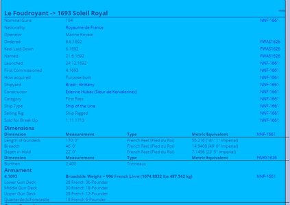

Just checked shortly the data written at three decks

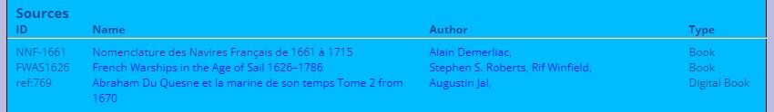

Here the length of the gundeck is mentioned with 170 Pied equivalent to 55,216 meter - source is
Nomenclature des Navires Français de 1661 à 1715 by
Alain Demerliac​
who wrote also
La Marine de Louis XIV, Nomenclature des vaisseaux du Roi-Soleil de 1661 à 1715​
which is also available as a print from ancre
