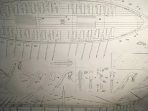

The kit comes with some nice quality lumber and finely cut laser billets. Rigging, hardware and a sewn sail are also included. Also new to this kit are newly written instructions and a detailed set of drawings to guide you in the build along with a highly accurate plan. I will try and show some of these drawings in this log in order to better help explain what I am trying to write.

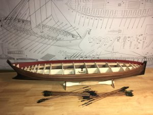

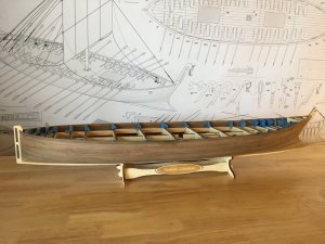

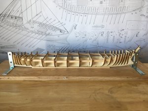

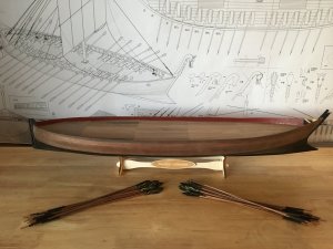

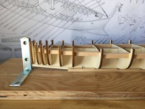

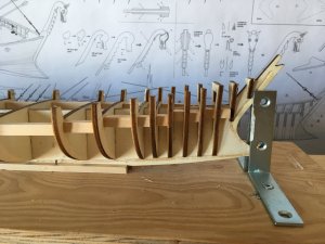

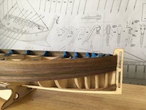

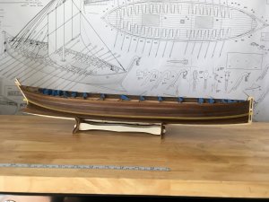

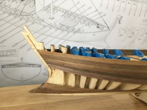

Keel has been glued together, rabbit cut and spacers installed. Spacers can be removed after fairing if you so wish

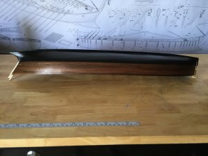

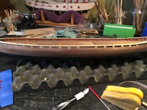

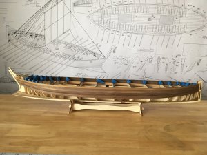

Masking off for the waterline

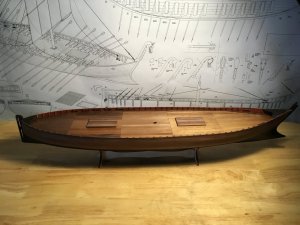

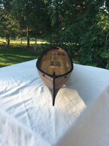

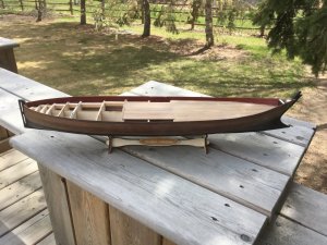

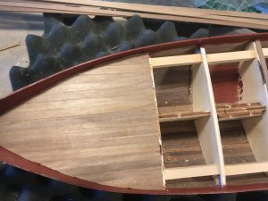

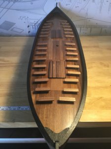

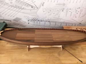

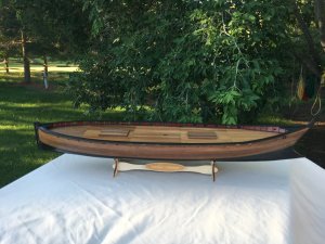

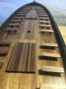

Deck planking has started, using 1.5 x 7 mm planks
Stanchions have been installed
A little off topic but after a hard day in shipyard what is better than some home smoked ham?
Hatches completed
Top rail installed

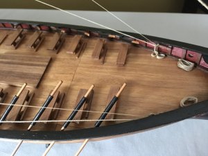

deck planking started using 1,5 x 7 mm walnut strips
After hard day in shipyard some homemade smoked ham is always a good thing

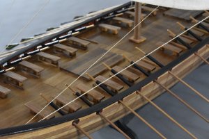

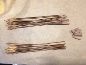

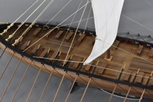

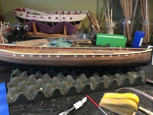

Cutting out the oar ports, I made a little stamp to show positions and shapes of the ports

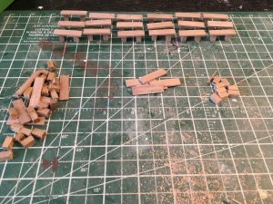

Making the benches
Benches installed

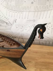

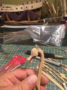

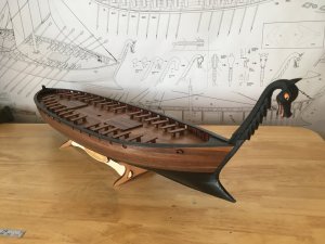

This step, making the figurehead, I did not document very well hopefully looking at the plans will help you understand the process
Not a very good picture but it is all I have

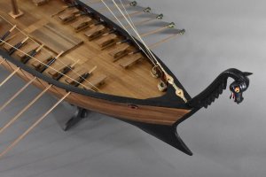

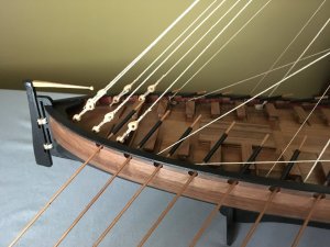

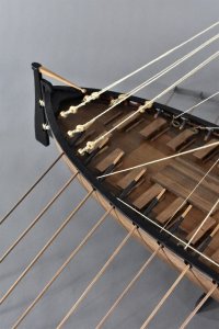

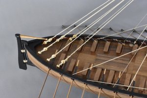

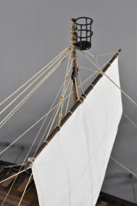

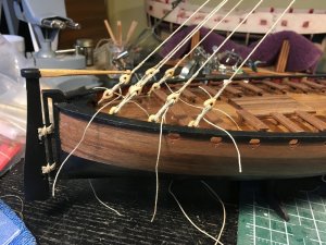

Rigging has started, along with installing the rudder

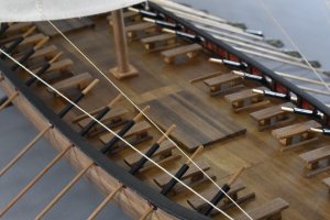

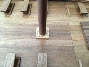

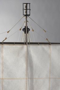

The mast foot

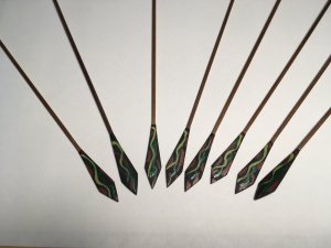

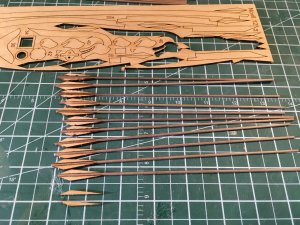

Standing rigging completed and oars stowed

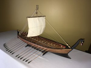

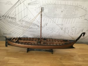

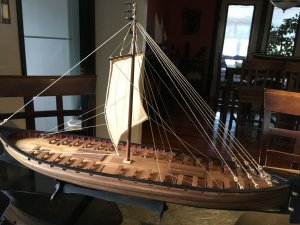

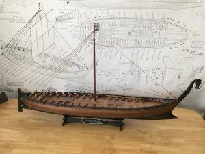

Rigging completed

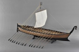

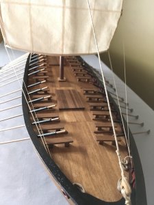

Novilara completed. I will stow the oars later this is just for pictures
Thanks for looking in and I hope you enjoyed
