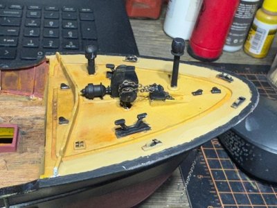

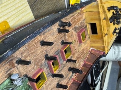

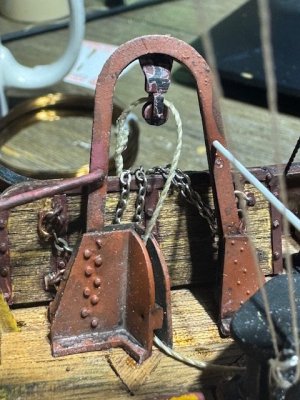

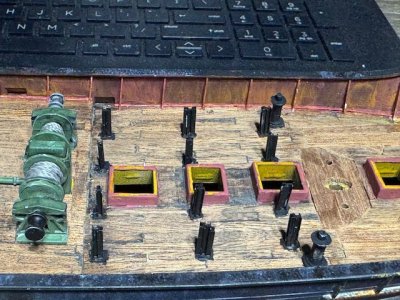

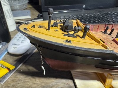

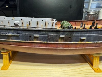

Good day. I started this ship a few months ago. It's an old kit which needs a LOT of work. Because I am not a ship builder when it comes to plastic models, i have to do a LOT of research on the subject in order to get the model built "right". As a result of that, I am learning a LOT about trawler fishing and what those men went through.

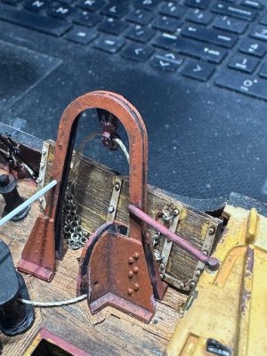

For the most part, i have shaved off kit details and replaced with scratch built items. I added a wood deck strip by strip, added chains, added the otter boards, which were not a part of the kit. Replaced lights with scratch built items and replaced the hand rails among many other things.

if you have ANY critiques I am more than welcome to listen. I am NOT a ship modeler and this is way outside of my comfort zone!

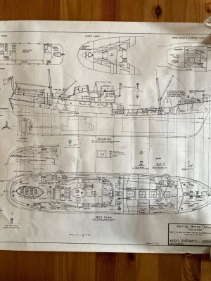

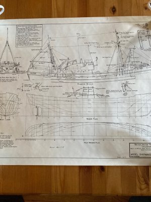

Nice detail and weathering! Let me present a bit of history on this kit. The model is of the British trawler Hildina, built in 1951. The original Model Shipways (Bogota NJ) produced a solid wood kit in 1/8" scale. The drawings from that kit are shown below. Pyro produced a plastic ripoff of that model, something they did with several Model Shipways kits. Eventually Lindberg acquired Pyro tooling and manufactured kits of the trawler. A photo of the Lindberg kit box is shown. Apparently, Life Like is now producing plastic kits. I built one of the Lindberg kits. It matched the Model Shipways drawings quite well. The major inaccuracy that I identified is that the plastic masts are flattened athwartship. The real vessel, unsurprisingly, had round masts. I assume that the masts in the kit were altered for easier plastic molding. I replaced the plastic masts with round wooden ones. As a bonus, a couple photos of the real thing are attached. Fair winds!

Wow! Thank you SO much for the details! I appreciate it. I can use the original plans better than the actual kit instructions! Through my research, I have found errors in the kit instructions. This helps - especially with the rigging!
Glad to help. Photos of the plans aren't very good but if there are particular parts that you are interested in and they are unclear, I can attempt to get better shots of those. Fair winds!
