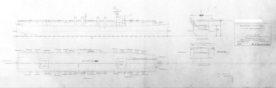

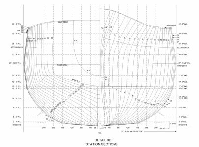

Looking for CVL-22 Independence Class lines plan for my next project. Other drawings have already been found (Booklet general plans). The only thing I could find was the body plane of the cruiser Cleveland. However, it is not attached to the keel and is therefore useless because it has a strange spacing (40 vs 150 original). But when it was converted into an aircraft carrier, bulges were added to the hull.

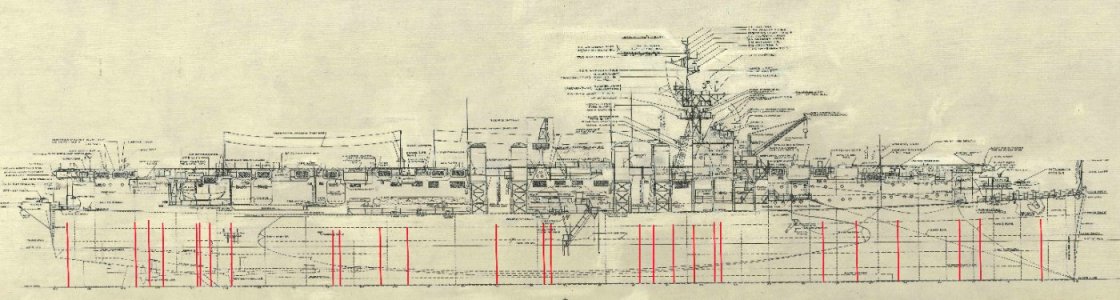

There are also drawings of the sections (shown in red), but they are inaccurate and create dips in the area of the boules in certain areas of the body, as well as fractures due to the inaccuracy (schematicity?) of the images.
I don't need a full drawing of the entire ship, just a line plan.
I'd be grateful.
Thank you!:)
