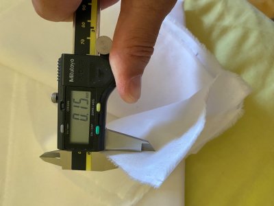

Hi, I am looking for a sewing machine brand and model for making sails in 1:96 scale. It should be not expensive but high quality sewing machine. It should be able to handle very light weight cotton fabric (batiste), have adjustable stitch length up to zero. No need for any but straight type of stitch.

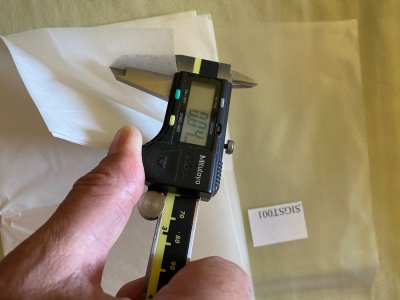

You'd probably be best off going with the silkspan and acrylic paint technique.

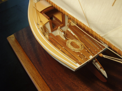

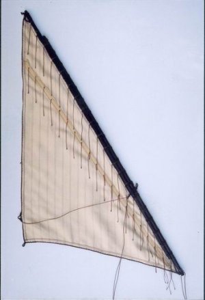

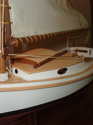

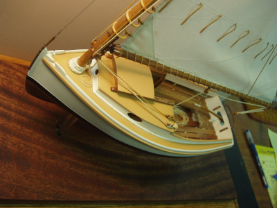

Below is a sail sewn with the finest thread and stitch obtainable on a standard sewing machine. The scale is 3/4" equals one foot. You are working at a scale of 1/8" to the foot or six times smaller. Perhaps this will give you some idea of the difficulty you will encounter. There is a reason nobody recommends attempting what you are contemplating.

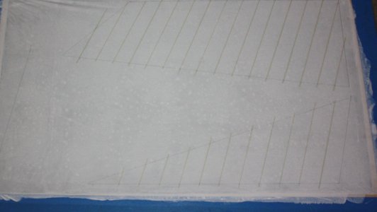

On the other hand, using silkspan strengthened with acrylic paint will provide a very realistic effect, whether furled or set, if the instructions are followed. For a more detailed description of the technique, you can purchase the sail making supplement to David Antscherl's The Fully Framed Model - The Swan Class Sloops for five bucks from Seawatch Books: https://seawatchbooks.com/products/...vised-and-expanded-edition-by-david-antscherl I recommend it highly.

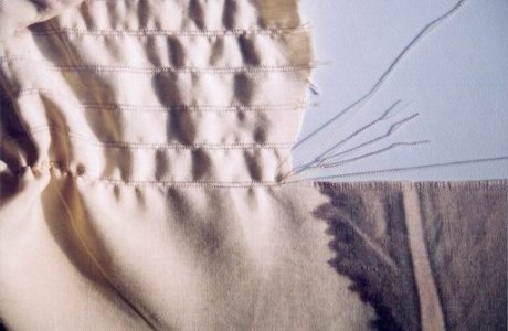

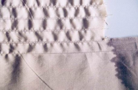

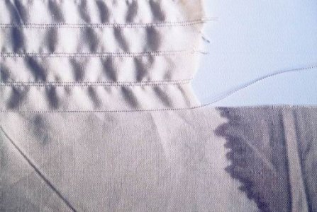

Hi Bob. I had seen description of some technique where part of fabric is being painted dark and threads being pulled out over unpainted part leaving a thin painted line instead of real stitch. I couldn’t fully understand how this works and what it looks like when completed. Any idea where I can get some better information on this?

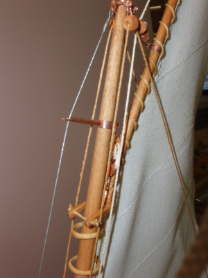

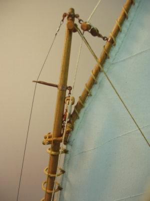

I've no idea. I'm familiar with teasing out a warp thread when doing certain types of canvas work at full-size, but not in modeling. It would seem near impossible at any scale size. The standard, and I think best, way to represent stitching in scale sizes is as Steef illustrated in his sail making link above, using a hard and sharp lead pencil to make a subtle light double parallel lines representing an authentic double-stitched lapped seam at the panel edges.

About the sails, I tried a lot of methods, even a darker thread with a needle weaving in the cloth threads. (Hope I say it right, just look in the clipper link under my name.) But the silkspan, or Japanese paper way is the best I tried. So easy.
