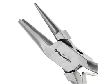

I own different types and sized looping pliers.The below given is my favourite one
