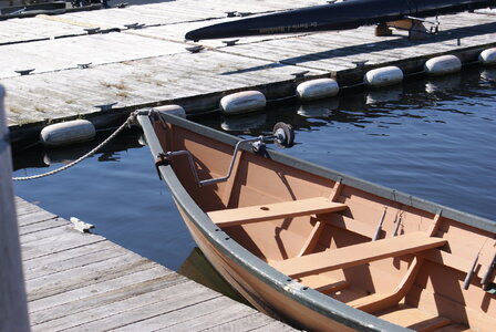

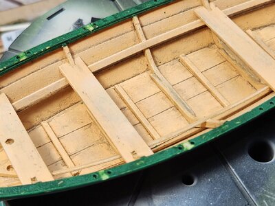

As a volunteer at Mystic Seaport Museum, I regularly pass a Dory exhibit and I thought it would make an interesting subject for a Diorama. My original thought was to recreate the scene in the photo, the boat tied to the dock. However, my biggest concern was modelling the water. If I mess that up, the project fails! Another option I considered was to build a scene of a Dory cradled on a Schooner. So, that's my plan.

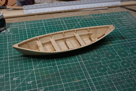

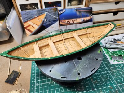

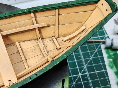

To start with, build the Dory! The Kit is the Model Shipways Lowell Banks Dory, "a beginner kit is not just for beginners"! No need to document the build, there are many Dory Build logs. So, fast forward, after few minor kit modifications, base painting, I started the weathering, still a work in process.
I mixed my own batch of base colors using enamel paints. For washes I use "only" watercolor paints". Not acrylic paints. Watercolor paints are much more forgiving, if you make a mistake, just wipe off with a damp cloth or paint brush. I never weathered a ship model; I'm having fun with this! Some dark grey wash, dry brushing and paint chipping, the detail starts to develop.
Once I'm satisfied with the weathering, I'll start on the fishing gear.

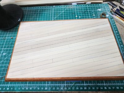

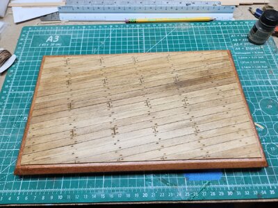

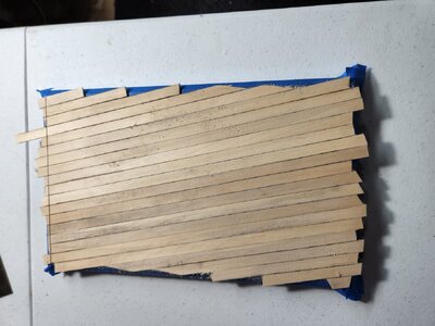

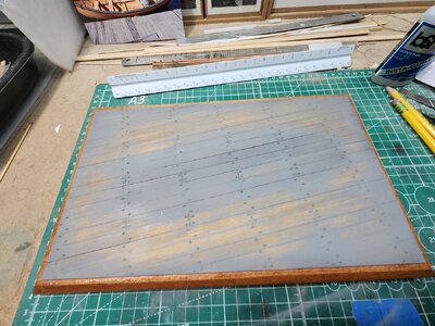

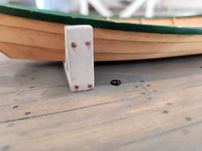

When building the base I wanted to try a different type of weathering technique to show wear and tear. Instead of the traditional use of washes and dry brushing, use sandpaper. Following the planking pattern of the Dunton, I glued basswood strips. Before gluing I ran a dark grey artist pencil along the edges to simulate caulking. Once trimmed and sanded, applied a coat of Oak Stain, then airbrushed a couple of coats of grey enamel. I decided to apply a light wash of watercolor dark grey to enhance the detail. When dried, started very lightly rubbing with sandpaper to simulate wear.

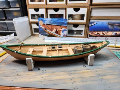

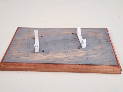

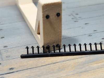

Finished the boat cradle/"kids" (can't confirm the correct terminology or design), added some detail, nuts/bolts, which are from Grandt Line. They offer railroad model detail parts such as lift rings, hinges, nuts, etc. which can also be used for ship modeling. Painted the cradle a toned down white, wash of watercolor dark grey, some rust stains.
Starting the fishing gear and while doing some research thought about adding some figures. Fortunately, I found some 1/24 scale figures in period dress I believe I can modify for the diorama.
Great idea for the base-plate - I like it very much

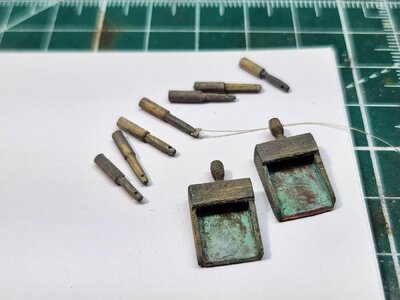

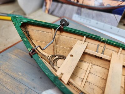

Some updates on the fishing gear. The item on the bow was called a "Hurdy-gurdy" a/k/a gurdy. Used on a dory to haul trawls in deep water. Still playing around with the placement of all the gear. Waiting on a couple of more figures. This project has taken longer than expected, anxious to get back to my whaleship.

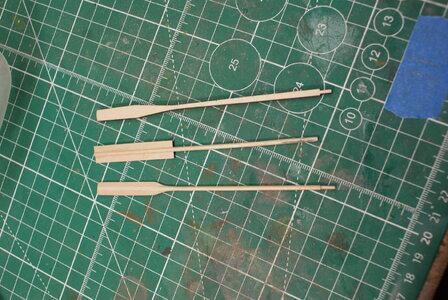

Tried shaping the laser cut oars supplied with the kit but found them difficult to work with. So, went "old school", a dowel and basswood strips, glue and shape. I find this process easier to work with, a good technique for beginners to learn.
