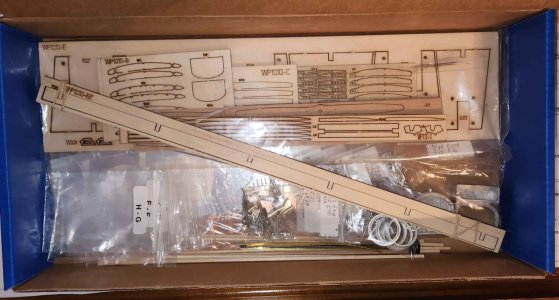

I was getting a bit burned out on my Fair American, so I wanted to try something a bit different. After seeing Donnie's Sopwith build, I decided to break out the Jenny,

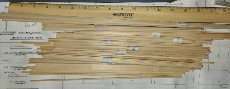

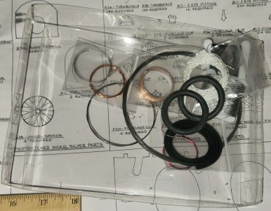

I went through all the parts, following Donnie's build thread and glad I did. The Britannia castings are not very good at all. Also, the wood strips do are not very accurate to the sizes listed.
I have sent a replacement email order for some missing and damaged parts, but they have not shipped out yet.

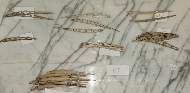

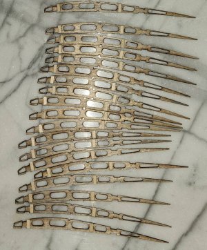

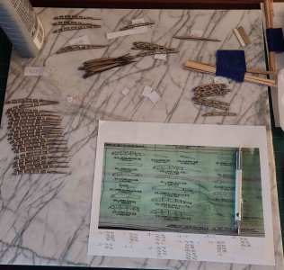

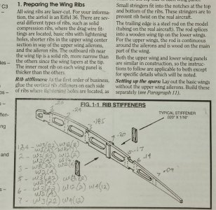

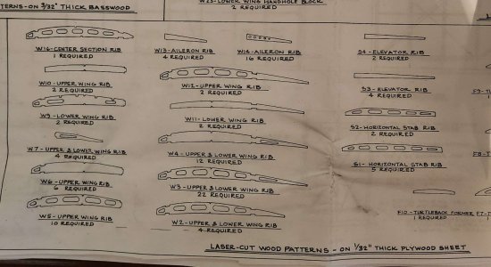

After reading the instructions a bit and checking the plans, I started removing the wing ribs from the laser cut sheets, I tried sanding the charred coating, but that black soot gets everywhere. I smoothed them up as much as possible without damaging them. I then began cutting the rib stiffeners from the stock strips provided. Once again, the strips are not the size shown in the plans or parts list.
I have cut about 50 - 60 of the stiffeners to .20" in length and glued them to the ribs. I have many more at many different lengths to cut.

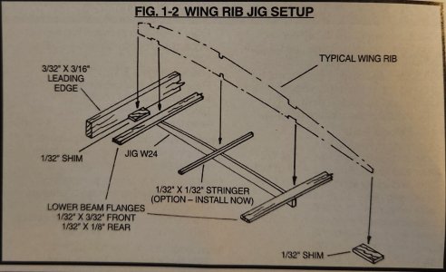

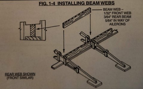

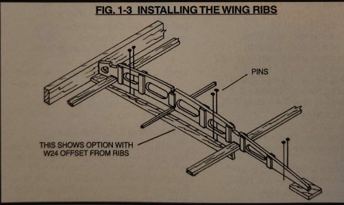

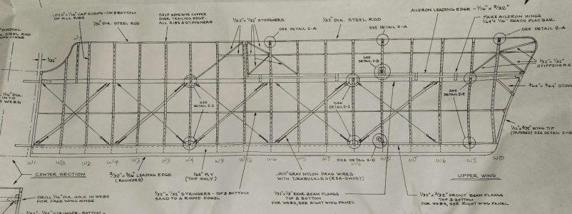

I think I have all the rib stiffeners cut and glued to the ribs. Part 2 says to set up the wing spars using a heavy main front and rear beam, two small stringers, a trailing and leading edge. It shows a wing rib jig setup, but it is not very clear how to set this up.

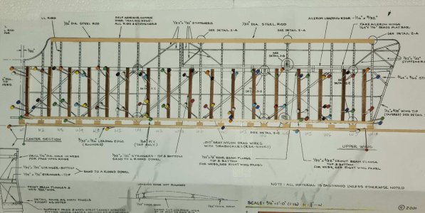

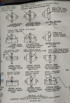

Any idea where the details showing strut location pad layout goes on the wing? For example, when it shows Upper Wing inboard rear bottom and Upper Wing inboard rear top, the drawings do not appear to show exactly what you would be seeing. Shouldn't you be able to see the Pad from either the top or the bottom of the upper wing inboard strut locations? If you look at the Upper Wing outboard front top and bottom, you can see the hidden lines of the pad structure. It seems like they are missing on the inboard section.
If I understand your question correctly, my guess is that the outline of the hidden part of the lower wing inboard was simply omitted from the detail drawing. Looks like all of the front pads are sandwiched in the leading edge.
