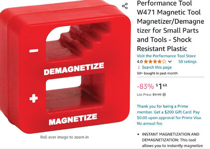

Get yourself a degausser machine…available in Amazon…you do not need one of the expensive ones…they work by placing tool on the machine and it is demagnetized…or degaussed…prices range from $10 to hundreds. A cheap one should work for you…

I have the same, but I put it down to using magnets as pick-ups for when tools 'jump' off my work desk! Pity they don't work on wood!!!!!!!!! I also have a 'thingy-ma-jig' for magnetising & demagnetising.
