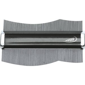

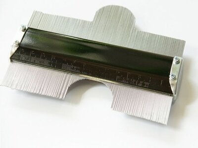

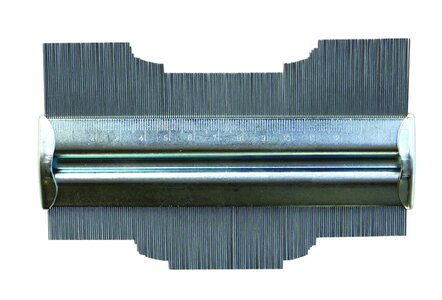

There is a small tool existing, which I know only under the german term "Formenlehre" / "Profillehre" or "Konturenlehre"I want to make bulkheads to go inside a Minicraft 1/350 Titanic's hull to strengthen it.
Is there a tool I can use to get(measure) the inside hull shape?
A handy tool. This is how I compare the hull lines along the sides.There is a small tool existing, which I know only under the german term "Formenlehre" / "Profillehre" or "Konturenlehre"
I have one with metal pins, but there are also plastic ones existing
View attachment 258296 View attachment 258297 View attachment 258298 View attachment 258295
Yes - I usually use this tool also mainly for the outside hull form, but I guess, when the small pins are fine enough, you can use it also inside a Plastic hull for taking the forms of bulkheads....... Otherwise cartonage with "trial and error"A handy tool. This is how I compare the hull lines along the sides.
I agree with you UweYes - I usually use this tool also mainly for the outside hull form, but I guess, when the small pins are fine enough, you can use it also inside a Plastic hull for taking the forms of bulkheads....... Otherwise cartonage with "trial and error"

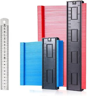

In English it is a "Contour Gauge", many tradesmen also use them. For instance, a tiler to get the correct shape to fit a tile around a pipe.There is a small tool existing, which I know only under the german term "Formenlehre" / "Profillehre" or "Konturenlehre"
