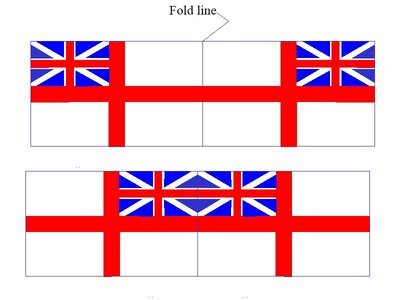

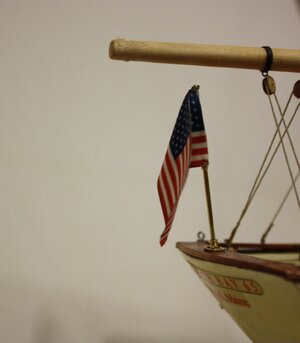

The problem with printing on cloth is that there is no cloth that is to scale unless the thread count is at least 2000 to 6000 for common scales and that does not exist as far as I have found. 600-1000 count cloth does look pretty good for scales of 1:48. As a result, silkspan has become a go-to for many modelers as scale is not an issue. A drawing can be printed on silkspan at home for a few cents in any size. I do a drawing with a mirror image as the ink will bleed through at times. The flag is then doubled at the fold line and glued together with matte medium or diluted PVA. I prefer matte medium as the flag can be shaped to drape while the medium is still wet. An example of a drawing I use is below. If anyone is in need of a particular flag drawing and wants to try this method feel free contact me and I will try to help with a drawing. The last pic is a draped flag made with the method described and cost less than 5 cents in materials.
