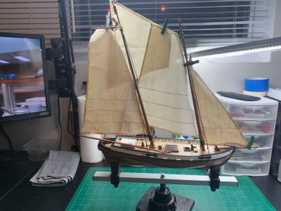

Thanks everyone for the advice. I just bit the bullet and jumped in with both feet and a sewing machine. Got the sails sewn and hanging (temporarily) on the ship.
I will start rigging them in place tomorrow
I think they turned out pretty good.

I think they look great. On larger vessels with more complex rigging, it makes sense not to display sails. But on a ship such as this, I think they do a lot to complete the presentation. You should be very happy with those sails.

Neatly done job. Hard to see in the photos, but did you sew the bolt ropes into the seam or will you add these by hand so you can hang the sails?
Some find it easiest to glue it on with white PVA or matte medium then hand stitch so the loops at the tack, clew and head corners stay in place.

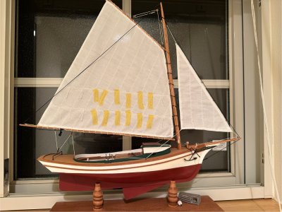

Here’s a photo of my lobster smack with some of the reefs highlighted
There are a few ways to do reefs. One is to cut your reefs to length and glue one end to the reef points on each side of the sail. Another is to run the reef line through the sail and then secure the top end with a single stitch. The latter is more authentic, but also more work.

Add them on as I rig the ship. I wasn’t sure of go long to make them
Justin, since you went to the trouble of stitching in the reef points, do you plan to add reefs? They would not be difficult and would add a lot of pop to the sails. If you are not familiar with the term, reefing the sails was a process of shortening sails to catch less wind by tying short pieces of rope around a boom or spar.
