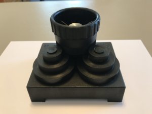

OK. What's the secret using this little gadget. I've soaked several 2mm X 3mm planks in very hot water for various times. I can't get them to feed through the unit let alone bend them.

Ive tried different methods to bend planks. I'm still at the novice stage in wooden ship building, so everything I experiment with is a learning experience. The Mantua Bender was a gift from a friend, without any instructions it was a failed experiment. But I looked at it this afternoon and had the "Eureka" moment. I was trying to get the planks to bend up around the big knob roller, instead of feeding the plank through the two bottom rollers.

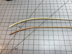

the top piece is a piece of 1.5 X 5mm Birch, the bottom piece is a piece of 1.5 X 3mm Mahogany.

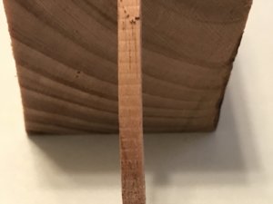

I managed to run some more planking strips through the little machine. I find it difficult to set up no matter the thickness of the planks. The planks to be bend need to be wet and very pliable. Inside or outside curves can be done but all leave the same marks on the plank being bend.

Leaves very noticeable marks (though not as bad as the blade crimping version. Both consigned to the bin in utter disgust) There's no substitute for proper bending.
