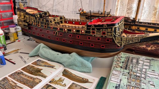

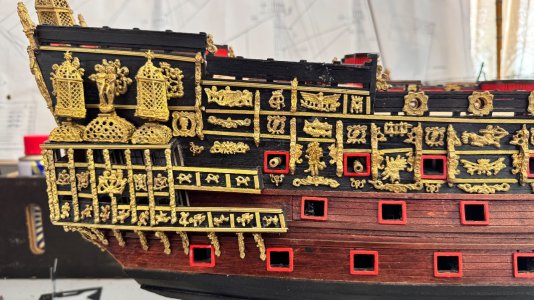

⚓ Back at the Sovereign of the Seas⚓

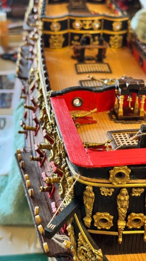

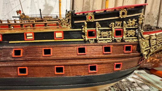

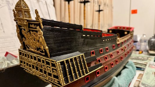

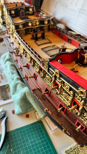

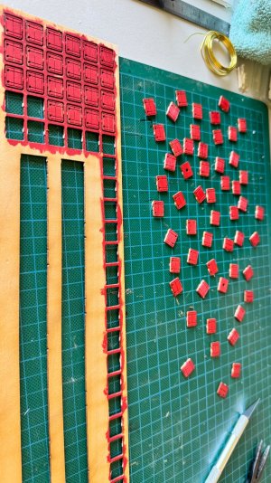

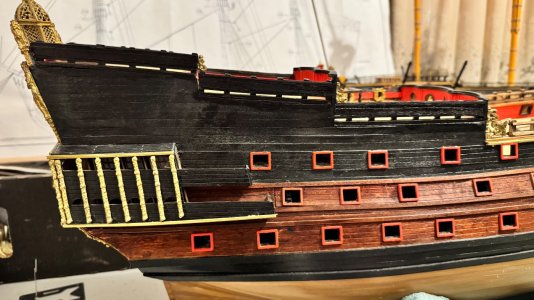

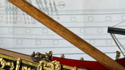

Today I picked back up on my Mantua Sergal Sovereign of the Seas 1:78 scale model ship, and I’m really pleased with how things are taking shape.

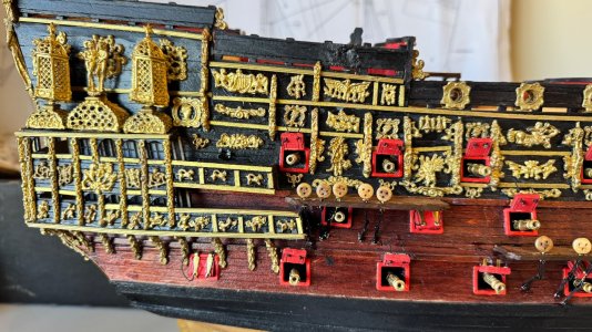

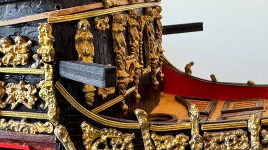

One of the main achievements today was completing the balustrade work on the stern, which adds a real sense of grandeur to the ship’s rear galleries. The Sovereign of the Seas was known for her incredible detail and extravagant decoration, and these balustrades really capture that opulence.
I also pressed on with adding more of the brass fittings and ornamental details along the hull and stern. Each piece has to be carefully placed and aligned to bring out the symmetry and richness of the design. Slowly but surely, the golden embellishments are transforming the black and natural timber structure into something that really echoes the majesty of the original 1637 warship.
The contrast between the dark hull, rich wood tones, red gunport linings, and gold detailing is starting to come alive now. Every new fitting seems to elevate the overall look, and it’s exciting to see the ship becoming more ornate with each session.
This stage is all about patience and precision—but when you step back and see the progress, it’s incredibly rewarding.
Plenty more fittings and decorative work still ahead, but the Sovereign is steadily turning into a centerpiece model full of history and detail. ⚓✨

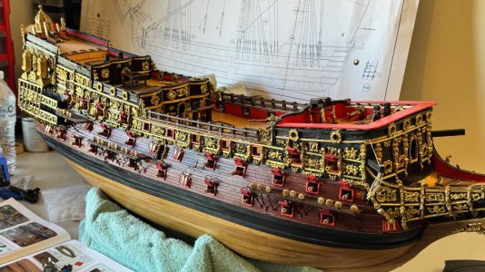

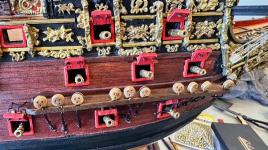

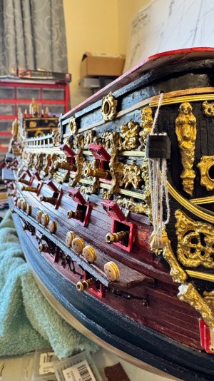

⚓ Sovereign of the Seas – Build Update ⚓
Today I’ve made some exciting progress on my Mantua Sergal Sovereign of the Seas 1:78 scale model!

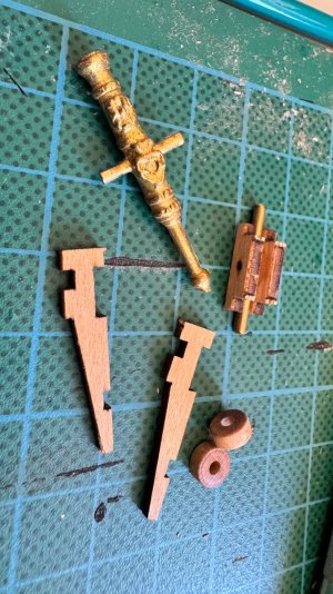

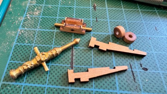

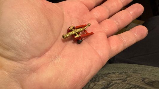

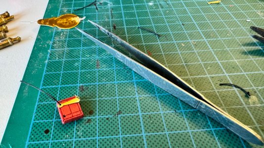

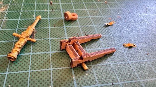

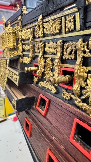

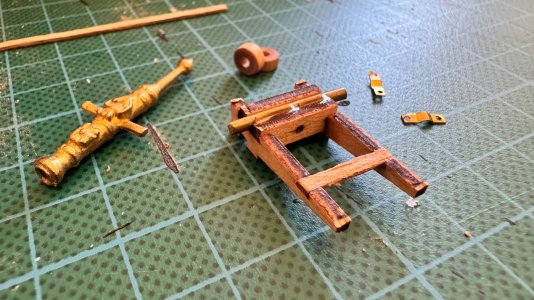

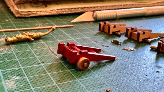

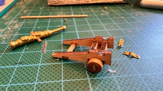

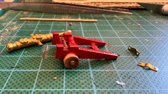

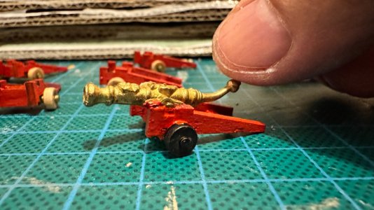

Cannon Construction

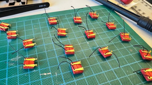

I started assembling and painting the ship’s ornate cannons. Each one is built from multiple tiny wooden and brass parts before being carefully painted and mounted. The barrels themselves are richly detailed, capturing the grandeur of 17th-century naval artillery. The carriages are painted in a bold red, which really makes the gold detailing on the cannons pop. These will eventually be rigged with miniature blocks and tackle, just like the real thing, so they could be hauled into position on deck.

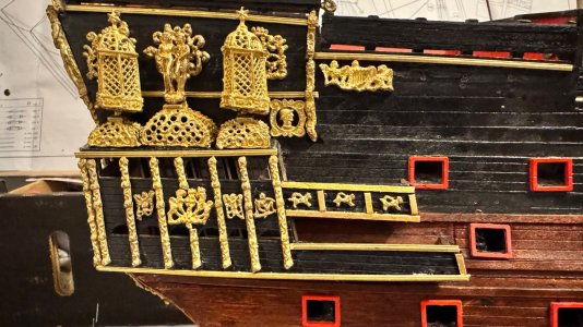

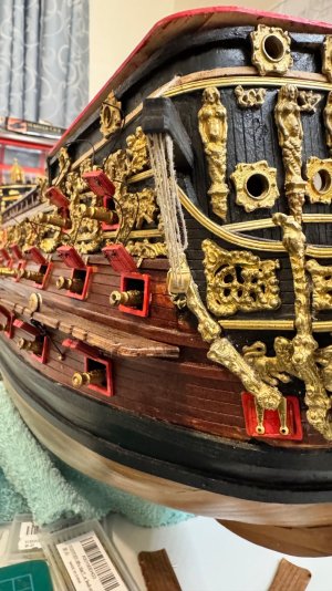

Gold Ornamentation
I also added more of the lavish golden decorations to the stern. The Sovereign of the Seas was one of the most extravagantly decorated ships ever built, and every little flourish of detail on this model brings that legacy to life. From the sculpted figures to the ornate lattice lanterns, each piece tells the story of the ship’s majestic and intimidating presence on the seas.
Why This Matters
The cannons and gilded decorations are iconic elements of the Sovereign of the Seas. They don’t just add to the ship’s beauty—they represent its power and prestige in the era of King Charles I. With each completed section, the ship becomes more than a model; it becomes a window into maritime history.
Sharing a few pictures of the progress so far: the cannon builds in hand for scale, their placement on the deck, and the glorious stern details now gleaming in gold.
This stage is both challenging and rewarding—lots of fiddly small parts, but seeing them come together is well worth the effort. Slowly but surely, the Sovereign is taking shape! ⚓✨

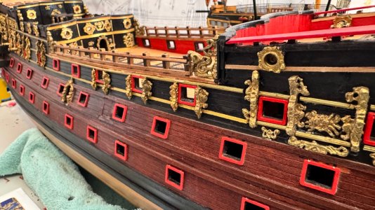

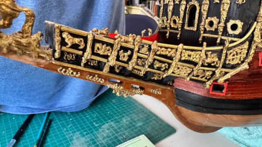

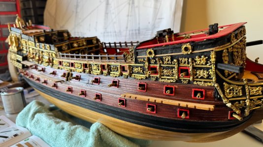

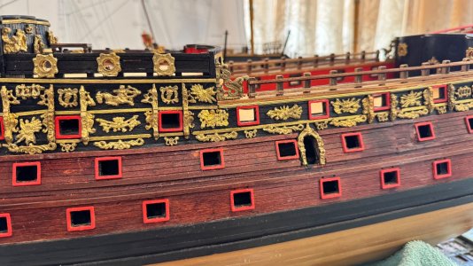

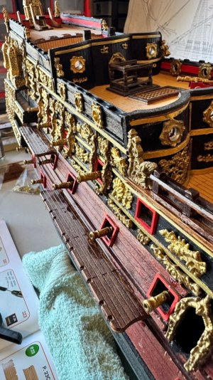

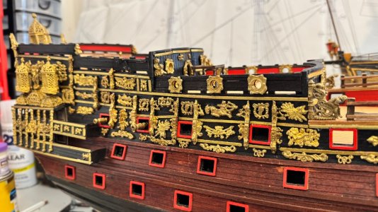

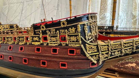

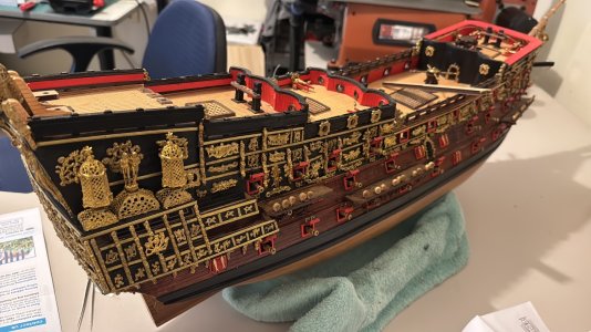

✨ Sovereign of the Seas – Gold Ornamentation Completed! ✨

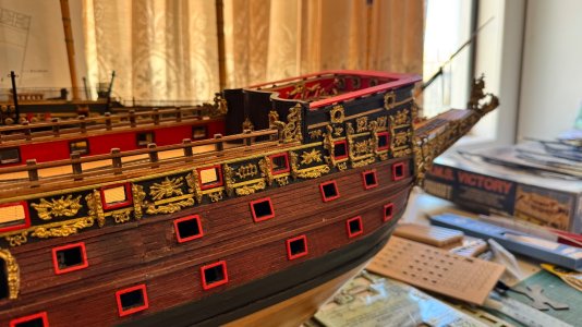

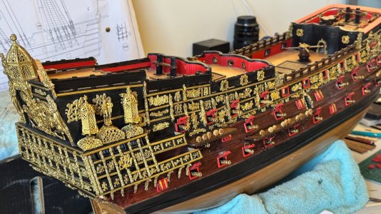

Today was a massive step forward on my Mantua Sergal Sovereign of the Seas (1:78 scale) build. I’ve officially completed mounting all of the gold decorative ornaments across the ship’s hull and stern – and what a job it turned out to be!
Every inch of this legendary warship is now covered in that unmistakable baroque splendor she was known for, from the intricate scrollwork and crests along the gunports to the lanterns and statues that crown the stern galleries. The detail on this model is simply staggering – each little piece tells its own story, and together they capture the grandeur and intimidation the original ship was designed to project.
It wasn’t a quick job either – I went through almost a full bottle of super glue getting all these ornaments in place. And of course, true to tradition, I managed to glue my fingers together more than once along the way. A proper modeller’s badge of honor, I suppose!
Now that the decorative stage is complete, the Sovereign is really starting to come to life – she’s beginning to look less like a kit and more like the proud flagship she once was.
⚓ Next up: moving further into the fitting and detailing stages as this golden masterpiece gets closer to full glory.
Thanks for following along – can’t wait to share the next steps with you all!

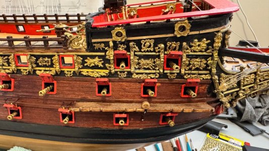

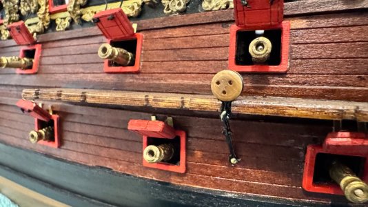

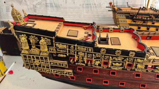

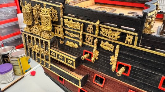

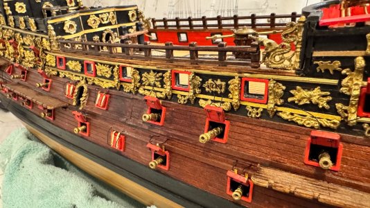

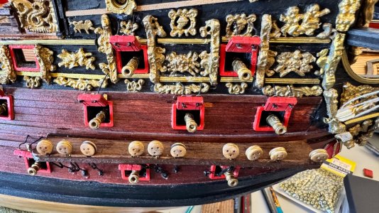

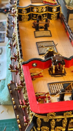

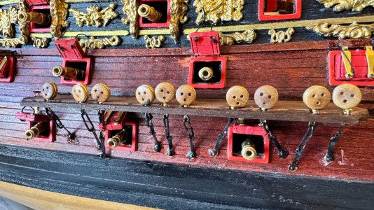

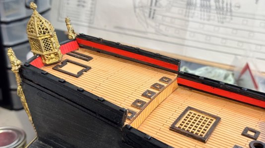

Shipyard Update – Sovereign of the Seas ⚓

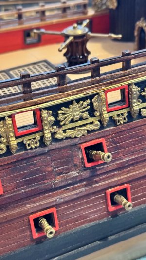

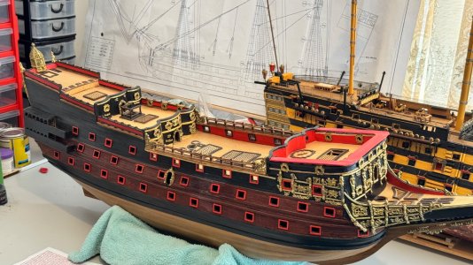

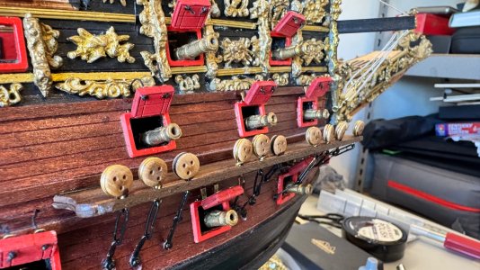

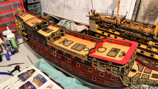

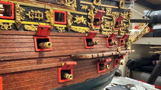

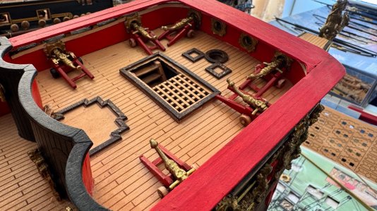

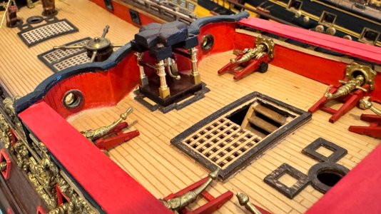

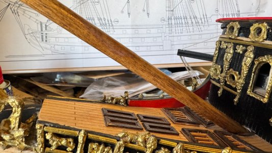

Progress continues on my Mantua Sergal Sovereign of the Seas (1:78 scale), and today was all about adding life to the decks and starting to arm the ship.

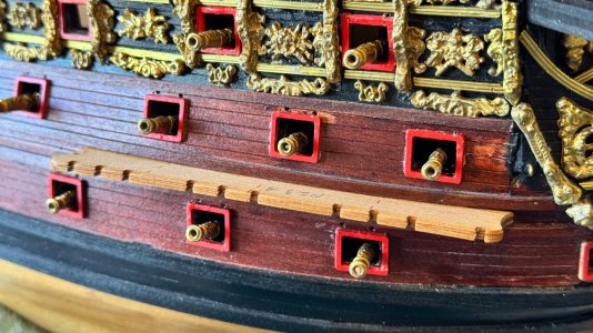

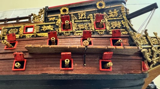

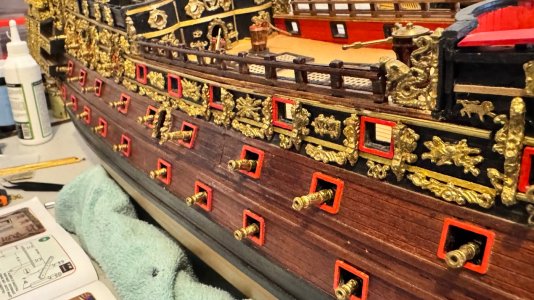

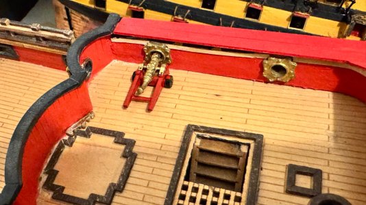

Cannons Installed – I mounted the first run of cannons on one side of the hull. Each sits neatly in its gunport, framed with red trim, and gives a real sense of the firepower this mighty warship carried. Seeing them lined up in sequence along the side really transforms the model from just a hull into a proper man-o’-war.

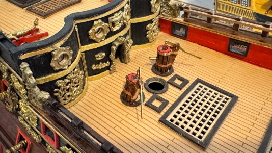

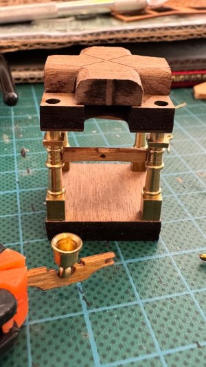

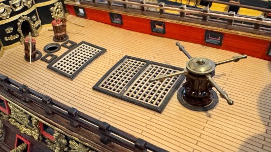

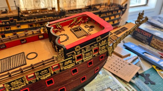

Deck Fittings Taking Shape – I’ve also been working on the deck details: the capstan is now in place, along with companionway gratings, winches, and barrel fittings. Each piece adds more character and functionality to the ship, and it’s satisfying to see the bare planking now beginning to look like a working warship’s deck.
Carved Details & Ornamentation – The ornate gilded decorations continue to bring the ship alive. Against the dark timbers and red bulwarks, the gold carvings really stand out—this ship was designed to impress as much as to fight, and that’s definitely coming through in the build.
Every step adds another layer of history and detail. The Sovereign of the Seas is steadily transforming into the majestic vessel she was in the 17th century. Still plenty of cannons, fittings, and rigging to go, but the ship is definitely starting to look the part!
⚓️ Next up: more cannon decks, finishing touches on the upper works, and then eventually the rigging.

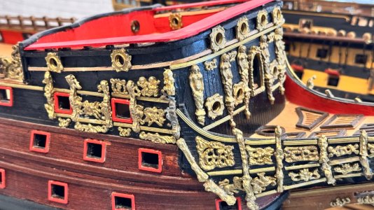

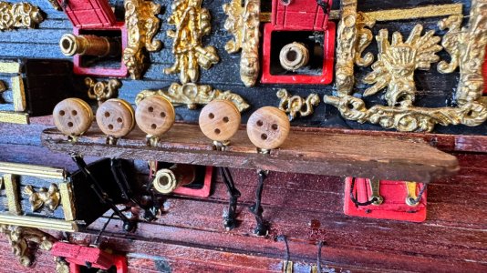

Looks awesome, I like the color contrast you picked. Very rich looking. Did you use gold paint over the metal ornamentation or use as it was out of the kit? I'm looking forward to seeing all of the cannons poking out of the gunports, purpose for such a grand and formidable warship.
I will be following you build closely so keep posting your updates. I have the same model kit and will start building it later part of next year. I have two models I'm working on now, need to finish them. Keep up the great work.
Some people do not like the Sergal and Panart Mantua kits, but I like them for the size of the ship. The larger the ship the easier it is for me to build. The metal gilded parts at times need trimming and some filing, but overall, I think they look great once installed on the model.
Keep posting your progress.
The metal ornaments is how they are out of the kit, no painting.
There is no updates to the build today. Spent the day relocating to a larger room. I’ve outgrown my 3rd smaller bedroom I been using.
I have 4 ships ongoing. And about to start a 5th.
I own 2 Mantua kits, this one and the HMS Victory.
The Sovereign of the seas has excellent step by step instructions included. I have no complaints.
The Mantua HMS Victory is lacking in the instructions. But does have excellent plans.
Not sure why people don’t like the mantua kits. Probably because there not the simplest kits to build. I’m not finding them to difficult.
The Metal guilded parts in the Sovereign of the seas. I use side cutters to cut the unwanted metal parts. It’s quick. But you do need strong wrists. There was only one I had to cut with a hacksaw.
I managed to glue on a whole side within a day.

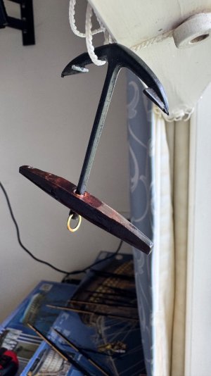

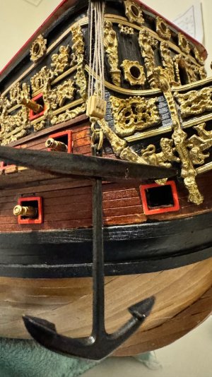

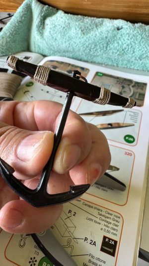

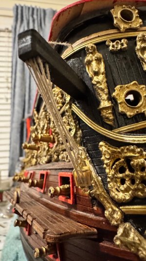

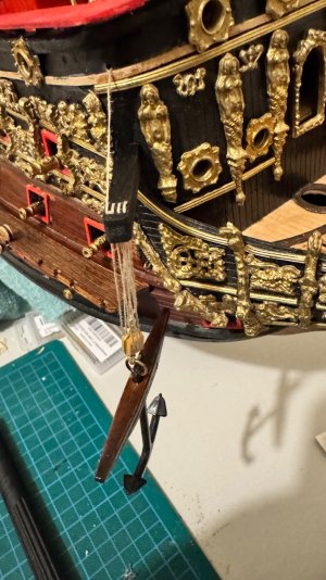

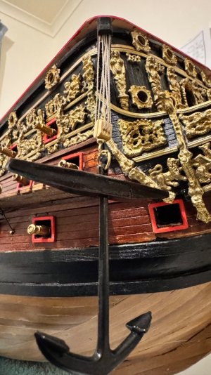

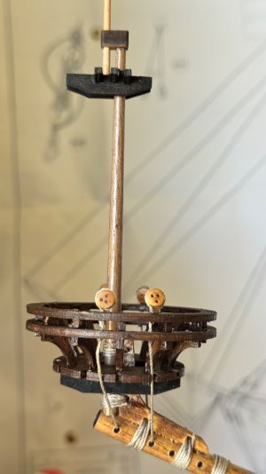

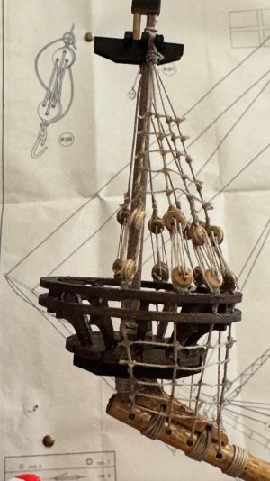

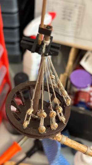

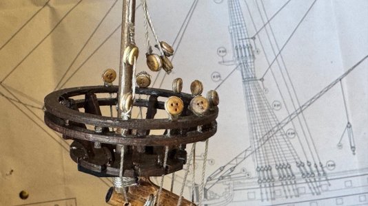

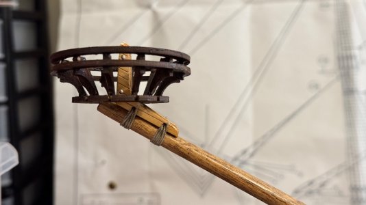

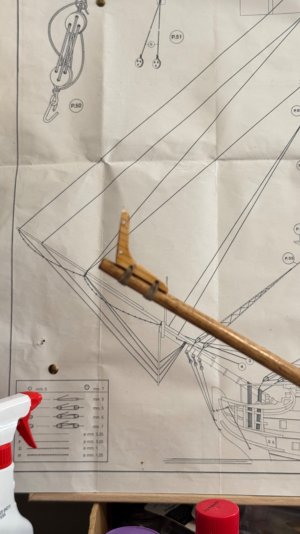

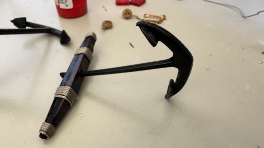

⚓ Sovereign of the Seas – Anchor Work & First Rigging! ⚓
Today was another exciting step forward in the Sovereign of the Seas build. I’ve started work on the anchors – there will be four in total once completed. Each one is built up with its wooden stock and fitted with ironwork detail, giving the ship that authentic 17th-century warship character.
With the anchors underway, I was also able to begin the first stages of rigging! This marks a big milestone in the build – the ropes and blocks bring the ship to life and start tying the whole structure together. you can already see how the rigging adds both strength and realism to the model.
The ornate golden carvings along the stern really frame the anchor rigging beautifully, making this ship look every bit as grand and imposing as her reputation in history. Seeing the black anchor and wooden stock hanging properly from the side of the hull gives a real sense of scale – as though she’s preparing to drop anchor in some distant harbor.
There’s still plenty of rigging to go, but this first taste of it has really transformed the model. From here, each rope and block will continue to add both complexity and historical accuracy to the build.
Step by step, Sovereign of the Seas is getting closer to her full glory!
