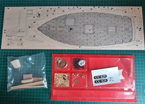

Laser cut plywood sheet, all the little fittings for the deck and rigging

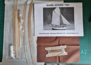

All the masts, sails(plus extra fabric for different color sails), rigging thread, plans
76521

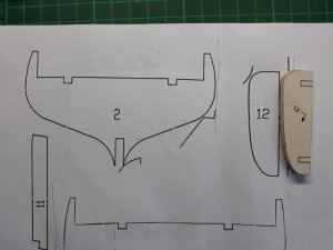

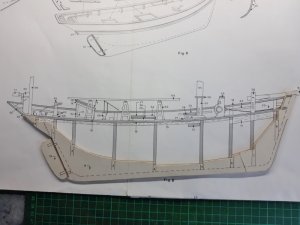

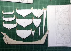

I used the plan drawing to get the shape of the keel and the rudder.
Luckily Billing Boats included a picture of the missing plywood sheet in their instructions(not to scale)Capture.JPG
I used the rudder as a template and enlarged the picture on a copier until the rudder fitted the picture, a very rough way of doing it, but beggars can't be choosers!
And Bob's your uncle, a full set of frames and a keel cut out of scrap plywood
Looks like it's going to work!

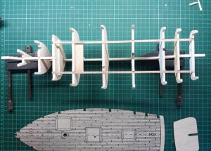

Some progress on this little beauty:

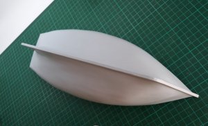

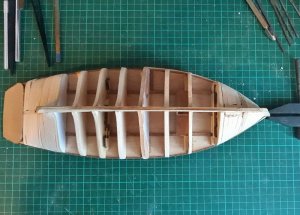

The false deck fitted quite well considering. My bulkheads were about 1mm too wide, so a lot of sanding has been happening in the shipyard!

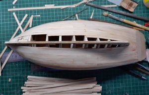

79659
I have added balsa filler blocks to the bow and stern to help me getting a better idea of the shape of the hull79661

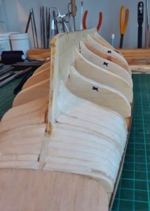

79662
X marks the spot! I have also added extra balsa bulkheads marked with the X to aid with the planking process
79660
The next couple of days will be spent shaping the hull, then planking can start

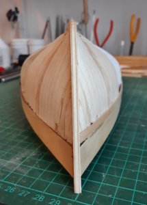

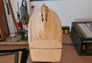

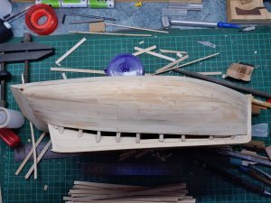

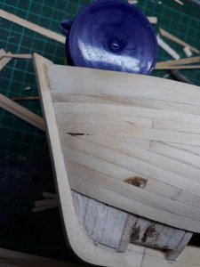

Been planking away for a while now.
At the bottom of this pic is my planking material, coffee stirring sticks made from Birch wood, which I get for the equivalent of $7 a 1000 over here.
She is taking shape nicely, starting to look the part. The hull will eventually be painted, so not too concerned about the planking pattern.
A rabbet line helps to straighten things out
The Birch wood bends very easily with a bit of heat from a cheap curling tong and sands very smooth

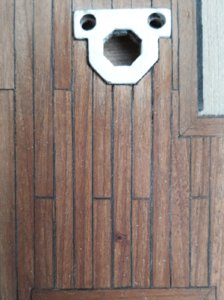

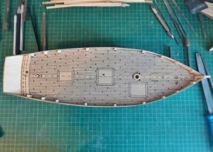

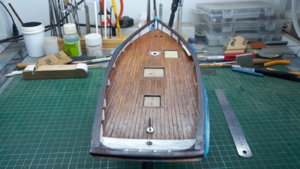

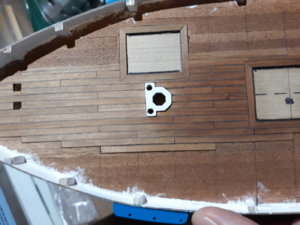

And yes what technique did you use for your deck caulkingQuestion-Mark
Jolley Roger
Well-Known Member
Sep 4, 2018
72
103
Johannesburg, South Africa

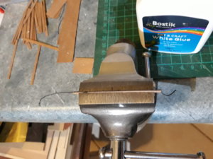

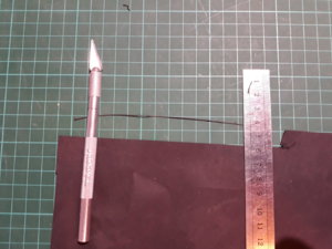

I use black paper sourced from the local stationary store. I have seen other builders using the same or similar technique( for example - the excellent La Jacinthe by Kortes, using plastic film - La Jacinthe)
First cut a paper strip roughly the same thickness as the planking strip - 0.5 mm
It looks like a tedious process, but after I've done a couple it is getting easier and easier.
Then glue to the planking strip which is kept firm in a vice (apologies for the quality of the photo, had to rush before going to work this morning)
and dry fitted at the bottom
Uwek
Admin
Administrative
Blandford Group Build
Dec 25, 2017
10,414
828
Vienna, Austria
I am also often doing the caulking with black or dark grey paper, which works well, especially if you use wooden glue. Due to the fact, that paper is also produced out of timber, you can also sand the deck surface very easily.
One small hint to your way:
We can see, that you cut the paper on the thickness of one plank, and glue this one very small strip on the single plank.
I am usually prepare a pack of several planks of the same length (f.e. 6 planks), glue the black paper with the width of the thickness of the complete 6 planks.
After drying, you can separate the 6 planks with a very sharp knife, cutting through the paper longitudinal - it is working well for me and reduces the work......hope you understood my explanations
