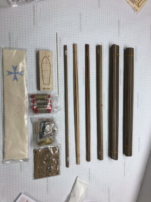

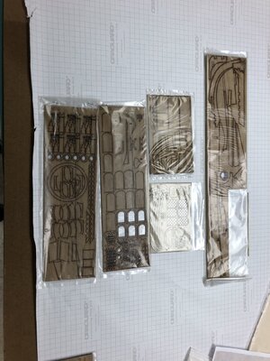

This is the kit that I will be posting my build log.
D40BD8B3-9F21-49CB-8C13-C06CC5F85BE2.jpegDA546D1A-E85C-48EE-989D-A0F31BA92D24.jpegB6925353-A187-45E3-9D19-04CE3F505486.jpegFE5B0721-401E-4769-9576-B89D37D91EB2.jpeg0A49EFB2-15FC-41DF-A002-B3D484763F16.jpegB391D0CD-761C-4F81-BF2A-C9A0749ABC82.jpegBABFACE5-D079-4887-85A4-3A5C143D57F7.jpeg80D075C9-ED57-4D0A-9DCB-4D91DB038444.jpeg

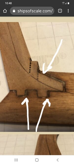

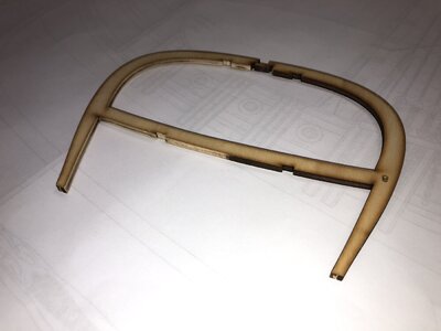

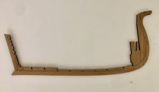

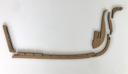

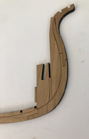

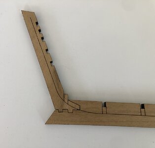

Building the keel was my first bump in the road.
The laser cuts for this parts were not at 90o.
Nothing mayor but you have to correct this minor setback.
But Zoran fixed the problem and I received a new set of keel components.
It fits nice and tight, hardly need any sanding at all.

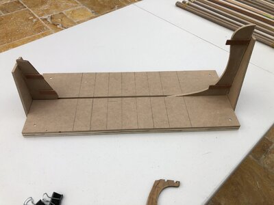

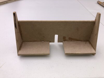

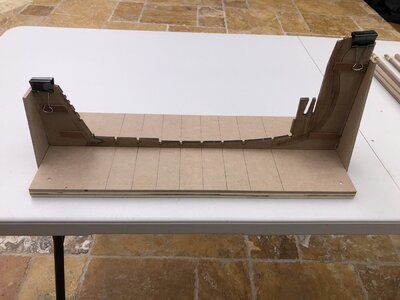

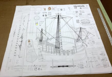

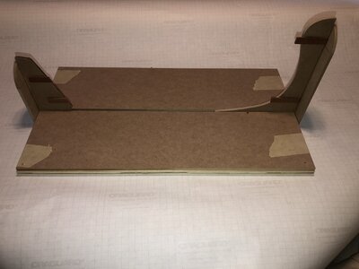

I also created a building jig by tracing the blueprints for the bow and stern.
D5FC5427-BCDC-4A74-AEA6-2B48DF7E8877.jpeg44B06473-7653-4844-8F30-ADA8BAA90DA2.jpeg6819ABA4-A8F2-4A42-885A-711698C718AB.jpeg8005EBE6-D018-4824-9142-D67D42138AE4.jpegAF146A20-3E60-4990-936B-BDBFC3B43737.jpeg1B8A149F-275F-4FEA-A8E1-58DDD980D3E6.jpeg8ED3B130-A67E-4939-A2F7-7F059884270C.jpeg

I fixed the off angle issue by carefully filing it back to its correct angle. In some joints I couldn't go too far, so I used a mixture of walnut wood dust with white glue to create a filling putty. The pictures show those particular joints filled with the putty.

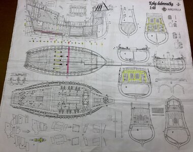

Those were the main reasons why I was eyeing this model. Unfortunately Marisstella do not have pictures of the interior. So I will wait with anxiously your built to see how it looks. Are those sections depicted in the drawing plans. If Yes, can you post a picture.

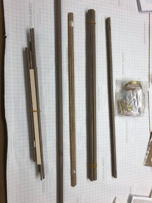

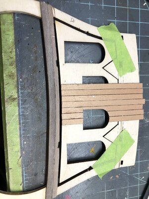

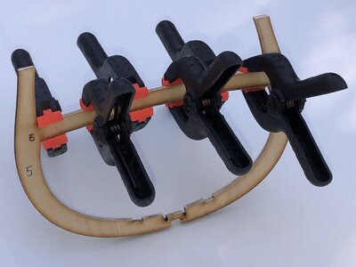

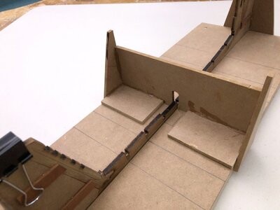

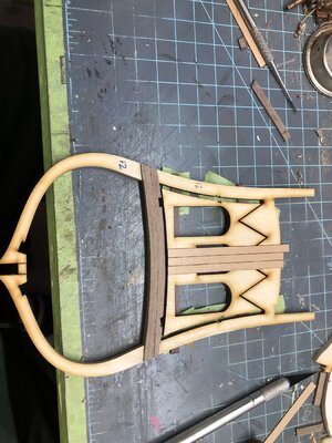

The fist steps after the keel is done is to prepare the bulkheads. Like I mentioned before, I always try to clean off all the laser burned edges that will be later glued.
Also you have to trace all of the bulkheads to later use them to shape the vertical side pieces.

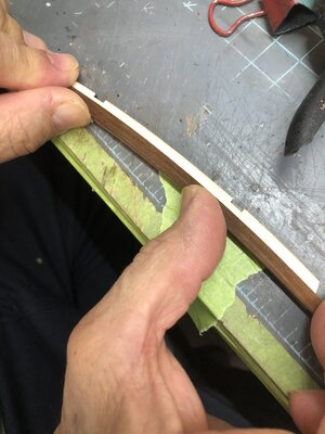

Once that is done I glued all of the bottoms of the support beam with 0.6x5mm strips.
Next step was to cover the faces all of the supporting beams. Again this is done with the same material as the bottoms.

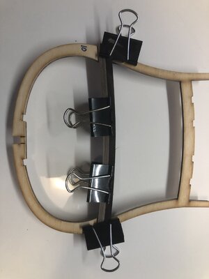

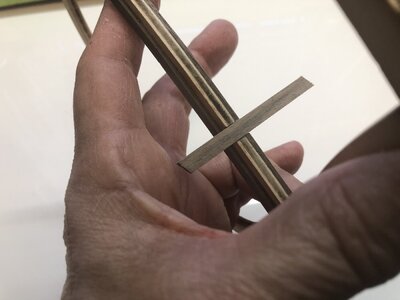

I had a heck of a time trying to bend this extremely hard walnut. I left the strips on a pipe full of hot water for two days and still they were hard to bend.
I also tried to wrap them in a wet towel and heat the in the microwave for three minutes with just about the same results.
So I was forced to used Cyanoacrylate wile holding the needed bent shape.
FF30DACF-74BC-4AC2-8EE2-EC222F90CBF0.jpegCCA13D51-3660-40E4-A459-FAA074466660.jpegFBAC4CA8-5137-47D8-B173-7CD366BFA6C3.jpeg48B998AB-BCE9-453B-A92F-CBF871D97729.jpegFF4328DE-9A97-4AA4-807E-16C85D779A5E.jpeg

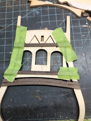

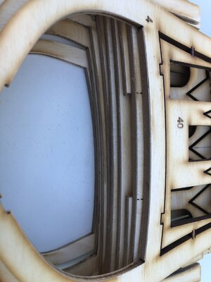

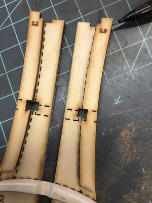

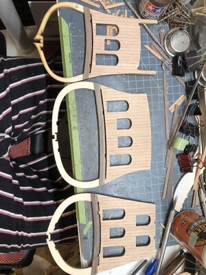

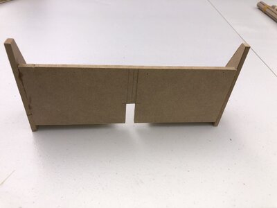

After that it was time to install all of the bulkhead in the keel but before that you have to prepare the first one in line from the bow, that will be #2.
You have to add three pieces before assembling.
As you notice, the middle pieces you have to build a groove to accept the bowsprit.
Make sure 2.2 and 2.3 makes a perfect square hole.
Also before assembling the bulkheads, you will have to panel some of them.
I like to paint the edges with brown markers before assembling just to get a ni es finish look.
Now....I don’t recommend the markers because they bleed and I had to sand off the mistake. Maybe some brown color pencil would have done a better job.
I’m an artist and do oleo paintings so Ibtry to take good care of the finish aspect of all if my models models .
062882E6-F285-404E-9B0C-CD7F1915BB57.jpeg7DB2332C-8188-49ED-80AA-B08102E4D807.jpeg41317536-482E-41DB-8648-6C669C7B3641.jpegFC8C34A8-5BC9-495C-AC76-52C4EEA49C04.jpegFEBDBFBB-48C1-4E16-8AB4-D2400F47D437.jpeg
