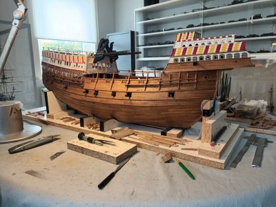

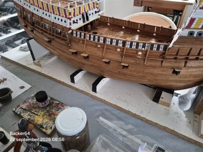

Mary Rose "Your Noblest Shippe" 1545 scale 1/50

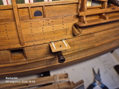

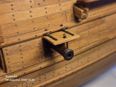

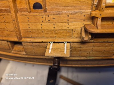

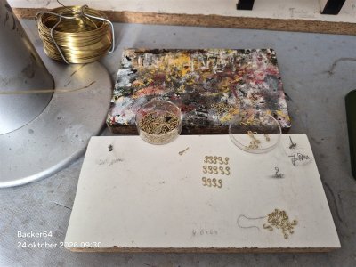

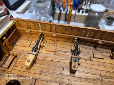

The cannons

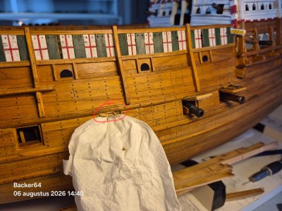

Below is an overview of the quantity, with a hypothetical distribution across the ship.
This may be correct, or it may be wrong—but the ratio between bronze and iron is accurate.
The 2 bronze half-cannons in the bow need to be replaced with iron ones.

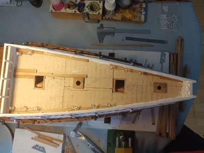

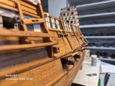

Work in progress.

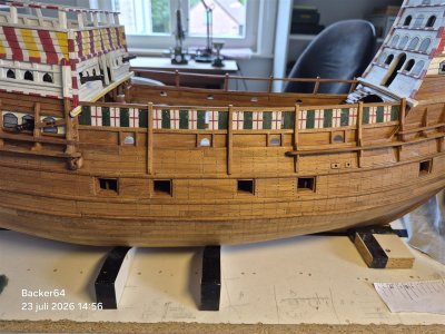

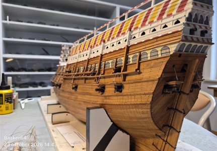

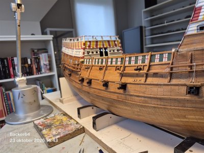

And a test for the positioning and rigging.
Yes, the rather ugly keel is wood with 7 lbs of lead flashing rolled up and glued and screwed on then smoothed? With filler. I was going to replace it but never got round to it. It's rather shallow isn't it. The thing sticking out of the hull near the keel is a propeller shaft with folding prop. The round thing on the rudder is for fixing on a rudder extension. She did sail quite well but like the original not very well into the wind, also I found that with all sail set she tends to come up into the wind. The spritsail and mizzens are too big and as this was nearly 20 years ago I made the after castle too low!
