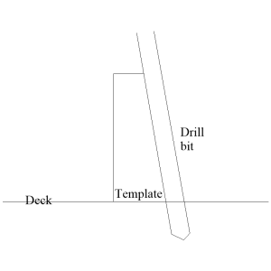

Make a 10 degree wedge and temporarily glue it to the deck so the drill bit will be centered where it should be. Hold the drill so the bit is against the wedge.
10 degree template is below. Print it on label paper then stick it on a half inch thick, or thereabout, piece of wood and cut the wedge. Or print it on plain paper and glue it with white glue or rubber cement to the wood then cut to the lines.
