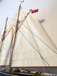

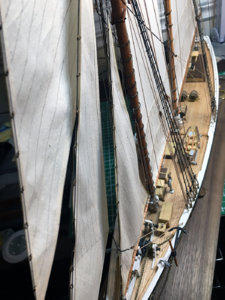

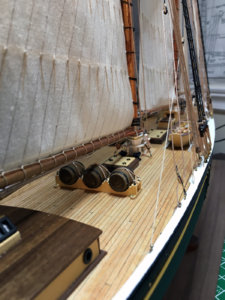

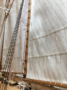

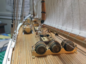

Here is the method I used on my Bluenose. It is used in the same way for both attaching the sail to the mast hoops as it is used to attach the sail's to the booms and hanks. It works really well, also is easy to do because it uses one long length of rope with out knots in between. The finished result is great, everything falls into place as you tighten it the hoops will line up perfectly. You can give it a try to see what you think
.1559726352_5618_FT33665_sailboom.jpg1564963806_5618_FT33665_img_1791a.jpg1564963948_5618_FT33665_img_1832a.jpg1565096005_5618_FT33665_img_1949a.jpgIMG_1756ab.jpg
Here found a pic while tightening up the hoops hopefully shows it a little better...
.View attachment 123957View attachment 123958View attachment 123959View attachment 123960View attachment 123961
Great photos of a well finished build. I"ll be following in your wake in a month or so after finishing off another schooner rigged pilot boat for which there is no identified scale. . . old Constructo kit from 1970, and tricked up for needed items found on an actual sailing vessel. A lot of detail depends upon the size of the model and what is visually in scale and practical to craft. Well done.
