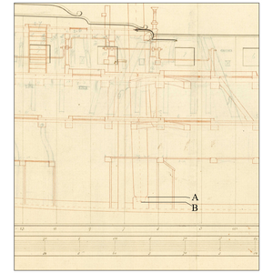

The below is of very little consequence overall, but I am curious. Is the length of the mast from the top of the mast to point A or point B or elsewhere on the drawing below?
Thanks
