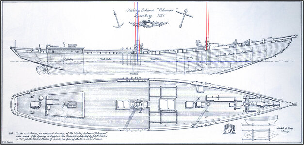

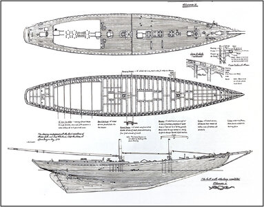

Hi Gary,
For the build of my YuanQing Bluenose I used this picture for some detailing:
The side and top view of a drawing of the original Bluenose of L.B. Jenson in his book: Bluenose II, The Sage of the Great Fishing Schooners.
His book is for the BN-II, so there are also drawing of that one:
Perhaps this will help you.

Hi Gary. When you see the location of the mast in the drawings, why then the measurements?
Both masts, by the original and the BN-II, are positioned between the 1st and 2nd shroud. See the chainplates / deadeyes on the hull.
If you want measurements: measure your model from bow to stern and scale the drawing to that. Then you can measure everything on the deck.

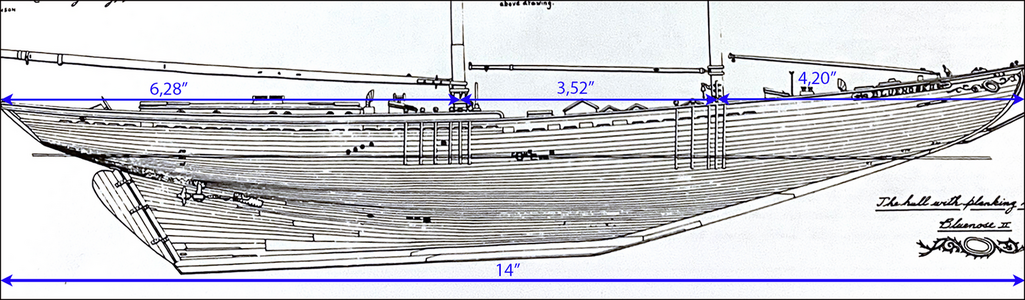

Hi Gary. As you wrote in you post #3, you needed the measurements between the two masts. Perhaps I can do some scaling for you.
And convert that indication on the drawing of my Bluenose and post it here.
The scale of your model 1:115 is correct?
Is it correct that the hull of your model, from bow to stern / from to end (without the bowsprit) as on the drawing below is +/- 38,19 cm / 15 inch?

HELLO AGAIN. THANK YOU FOR THE FAST REPLY. MY BOAT IS ARTESANIA LATINA BLUENOSE 20001,1:115 SCALE AND I MEASURE RIGHT AT 14" BOW TO STERN,
THIS KIT IS DATED 1988 AND I'VE HAD IT FOR YEARS AND NEVER OPENED IT TILL LAST WEEK. I CAN LOOK AT THE DRAWINGS AND GUESS AT WHERE I SHOULD
DRILL THE MAST HOLES, BUT I'M TOLD IT IS IMPORTANT THAT THEY ARE IN THE RIGHT PLACE ON THE DECK.
THANK YOU VERY MUCH FOR YOUR HELP, GARY.
HELLO PETER.
THANK YOU VERYMUCH FOR THIS, EXACTLY WHAT I NEED.
