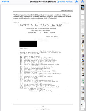

I too have seen this schedule of colors frim S&M Dated some time in 1970. It does not state the date that those colors are based upon so with frequent out-hauling's for repairs during her years between 1921 and 38 these were likely some changes made but the primary elements/colors remained fairly standard. The old photos only show the consistent white ones but it is a challenge to see how the bowsprit may have changed. BNII is herself and with her own colors. After your research I would recommend using the colors that come best to your eye and end satisfaction an let "perfection" pass by in the wake. Rich (PT-2)This is from the Bluenose Practicum Standard, page 135, hope it helps:View attachment 255199

The letter states the colors specified are from the original Bluenose. Like you Rich, I have some reservations, especially since the letter was send 7 years after the build of BN II. So not necessarily not accurate, but no guarantees.I too have seen this schedule of colors frim S&M Dated some time in 1970. It does not state the date that those colors are based upon so with frequent out-hauling's for repairs during her years between 1921 and 38 these were likely some changes made but the primary elements/colors remained fairly standard. The old photos only show the consistent white ones but it is a challenge to see how the bowsprit may have changed. BNII is herself and with her own colors. After your research I would recommend using the colors that come best to your eye and end satisfaction an let "perfection" pass by in the wake. Rich (PT-2)
