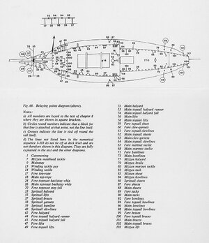

Here are some belay points from the Noel CL Hackney book "Mayflower: Classic Ships Their History & How to Model Them", published in 1970 by Patrick Stephens Ltd.Mayflower Rigging Points.jpg
Exact rigging plans of any ship model does not need to be the goal. Instead look for a consensus of rigging plans for ships of similar rig and period. Why? Every ship’s Captain had their own ideas on how to best rig their ship for the best performance. A stay anchored here rather than there…a running line belayed there instead of here. Therefore small differences in belay points can still be historically “accurate.” One need not be always “exact!”

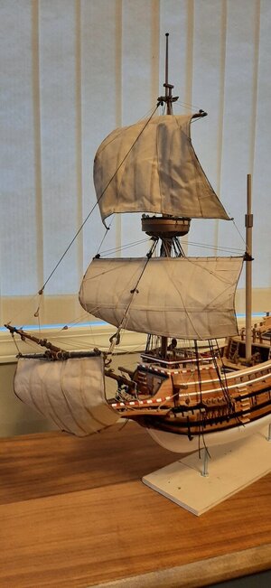

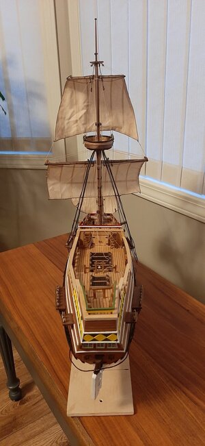

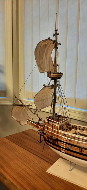

thanks peegee. i checked it out but at 70$ canadian plus not great reviews i will take a pass. i am using anderson book "the rigging of ships in the days of the spritsail topmast n1600-1720" as a guide and for the most part it jives with other publications and plans. like danielsje posted earlier one does not need to be exact as the captain rigged a ship as they saw fit to maximize efficiency. 20220228_174226.jpg20220228_174134.jpg20220228_174250.jpg20220228_174338.jpg20220228_174226.jpg20220228_174134.jpg
Pictures look really great! I had no idea that the Baker book would be that expensive. I do not blame you one bit for not getting it, besides R. C. Anderson is a wonderful resource as well.
