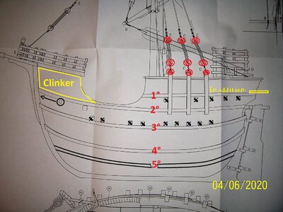

After examining the plans and looking for images of contemporary boats, I decided to make some changes:
1) the hawseholes must be moved forward.
2) the yellow marked area will be "clinker working".
3) the upper beams will have a smaller section, differently positioned and will be more numerous.
4) the lower beams will be more numerous and differently positioned.
5) some wales will be differently positioned and one more (5) will be added.
6) the frames and the bulwark stanchions will be more numerous.
8) stern deck extended (in yellow).
7) the rigging will be totally changed, following that of the Nao of Matarò at:

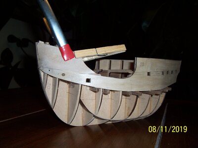

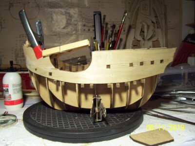

After glueing frames and fills to the keel, it is time to insert the lower beams 5X5 mm. I started following the instructions and after I modified them. It is also possible, however, to prepare the seats in the keel beforehand for their final arrangement.

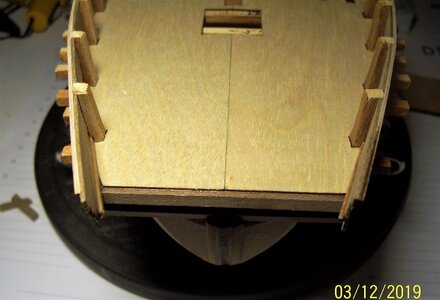

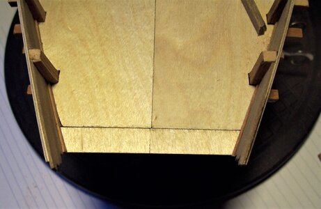

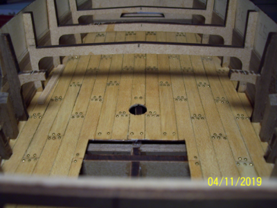

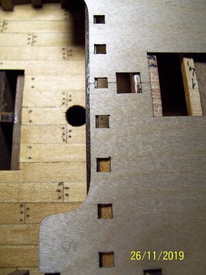

After the lower beams, it is time to glue the plywood that will support the main deck. It consists of two pieces, left and right. I couldn't fit the two pieces so I divided them in half perpendicularly to the keel. The cut must fall on the top of a frame, to support and glue the edges. When glueing, it is important to press the plywood firmly onto the frames, especially in the middle, in order to avoid the cusp that may be formed along the joined edges. The main deck can then be surfaced with sandpaper and covered with the suitable strips.

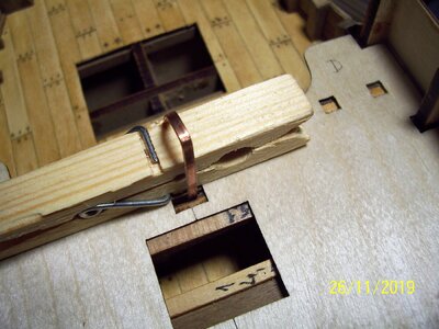

The strips must be cut to a length specified in the instructions. However, make sure that you do not end up with too short strips near the deck openings: in such cases, it is better to leave them longer. I learned it too late, as you can see near the opening for the main deckhouse.
I have tried different types of nailing, but have regretted it. If I could start again I wouldn't attempt it. Perhaps a dot made with a very sharp pencil would be acceptable, or very thin copper or brass wires inserted vertically and then sand-papered.

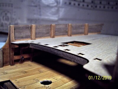

Here we are!
In the previous picture, the portside wall has been glued to the frames along the deck edge in contact with the beams. Now all the plywood sidewalls are glued to the frames and deck:
The lines are drawn in pencil to mark the limit to which the upper beams, 3 - 3.5 mm square, will be fixed.
As they must be aligned with the existing beams in the frames, it is natural that they should be placed close to the top line.
The next steps will be to glue the waterway (not planned in the project) all along with the hull, to cover the bulwark inside with 1x4 mm walnut strips, to add some bulwark stanchions and to plank with walnut strips (0,5x8mm) the visible side of the frame (visible from the bow and the stern)
This is the side towards the bow, with some added stanchions bulwark and the planking of the wall and the visible side of the frames.

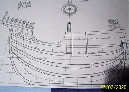

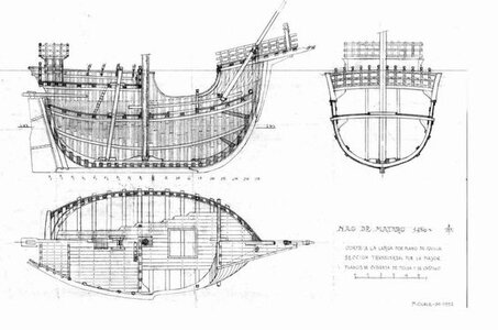

Dear all,
here are two images (among many others) that inspired me. Unfortunately, in the beginning, I used to collect everything I found in a rather disordered way and now I don't know the exact sources (very often Pinterest).
Anyway, you can see the different size and position of the high and low beams; it's clear also the most advanced position of hawse holes. The greater number of visible ordinates is also evident in the following image:

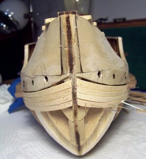

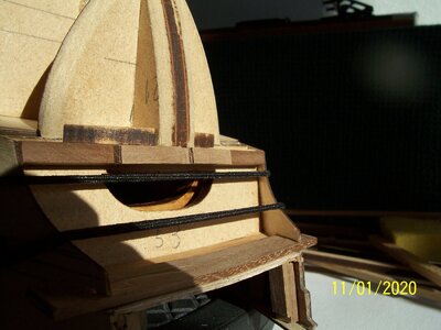

Looking towards the bow, we make the holes for the hawse-holes and the previous ones will be closed; obviously, the holes must be not under the main deck :

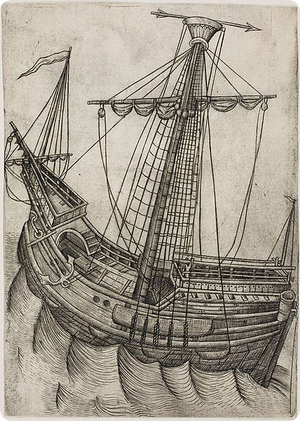

Don't shoot me, but the ratlines in the first drawing of you're last post are incorrect. In these years they didn't had ratlines, they came somewhere in 1550 or so on the ships. In those days before that time they use a rope ladder to climb to the top of the mast. (Source R.C.Anderson) Please correct me if I'm wrong.
Hi Stephan,

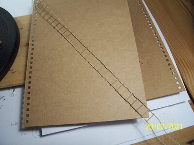

I've already prepared the "Jakob's ladder"! ;)
Anyway, the "Nao of Matarò" doesn't have the ratlines (neither the rope ladder, but nearly six centuries have passed and it has undergone numerous alterations). Therefore I won't be using ratlines either on my ship.
I've studied the problem and it seems ratlines could be older, before 1550. As an example, Xavier Pastor in his marvellous book "Anatomy Of The Ship -The Ships of Christopher Columbus" wrote on page 15: << Ratlines placed on the mainmast shrouds are based on early sources such as the seal of the City of Danzig (dating from 1400)>>.
I've also found some interesting drawings in the wonderful book of Heinrich Winter "The ships of Columbus":
1) The ships of Modon (today Mothoni, in Greece), from a codex of 1486 :
2) a Spanish gold medal of XV century, now in Madrid:100_1580.JPG

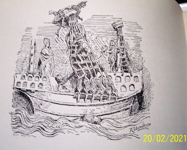

3) Altarpiece of "Saint Ursula and eleven thousand virgins" by Joan Reixach (1411-1486), Spanish painter and miniaturist. Dated 15th century:
100_1584.JPG The man cannot climb a rope ladder; the ratlines are just omitted, as are the port shrouds for artistic reasons, of visibility, I suppose.​
4) Finally, the 'Demonic Ships' by François de Cologne in the church of St Nicholas in Burgos (1505):
The first has the ratlines, the second seems to have a rope ladder, even if it's difficult to understand where the sailor will place his right foot...maybe ratlines were erased?
Looking at all this documentation, made me think that it would not be wrong to apply ratlines even before 1500.

Anyway, going back to our Cocca, we have seen that the number of frames is higher than the one set by the manufacturer.
A couple of false frames has already been added to the bow (see post #5).
At the stern, we've also some additional beams that must be added, in order to arrive at a similar structure:
As a consequence, some other false frames must be glued under them. Here the holes for the upper beams have been prepared (3x3 or 3.5x3.5 mm; also 4x4 if other sizes are unavailable):
In this way, we can achieve greater precision in insertng the false frames; the new beam is only inserted, not yet glued:

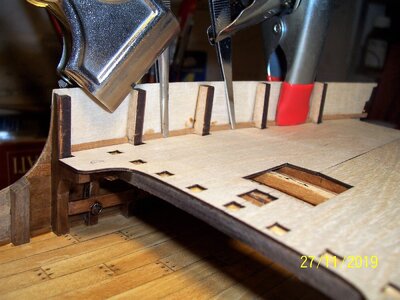

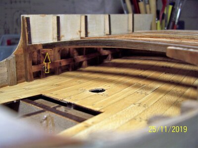

Now, beams of smaller cross-section and larger numbers are added in place of some of the original ones. This photo shows their position:
False upper deck beam hanging knees have been glued underneath the beams (yellow arrow), to conform with the existing ones:
The new beams are more bent than the previous ones, and the deck above them will rest on them. The pre-existing beams are not a disturbance and can remain where they are:​
Now the false plywood deck is laid and a support is added to help support the rack:

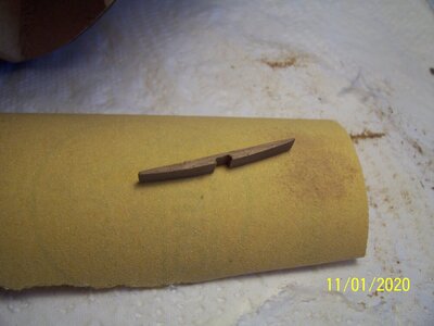

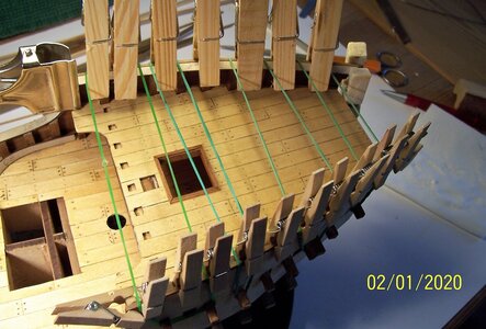

we now glue two walnut strips 4x4 mm on the stern board wall; the upper must be bent like the deck:
As I wanted to insert a balcony, I glued another strip on top, to have a sufficient base to enlarge the glueing area:
Now it is time to planking the deck, adding the false frames as a continuation of those below and to paint frames and bulwark:
Now we can also cut the beams for the deck opening and build a border around the edge:
See you next time!

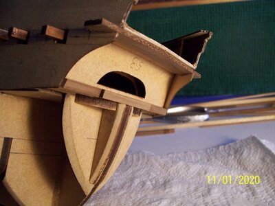

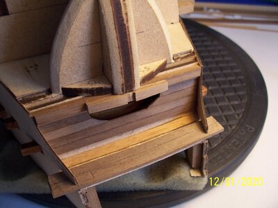

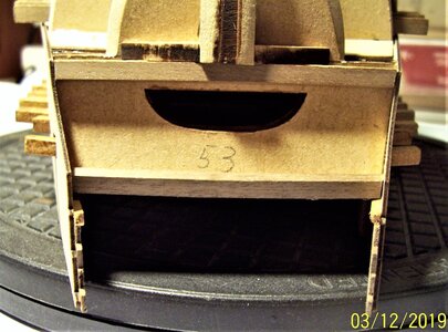

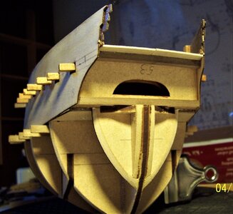

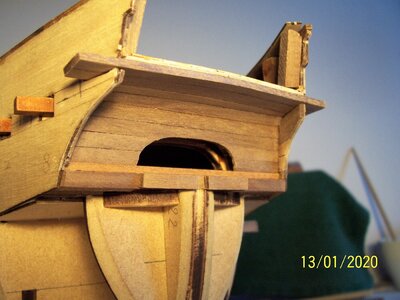

The stern should now be refined. First the balcony under the deck and then the transom, a little different from the instructions:

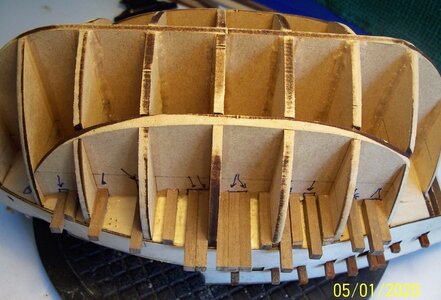

Dear all,

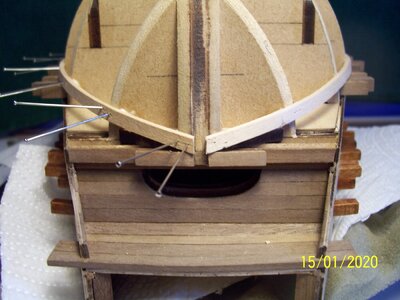

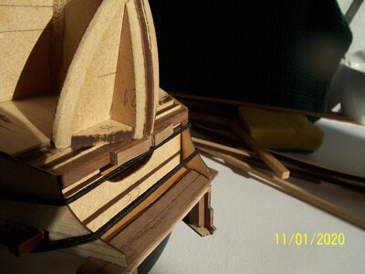

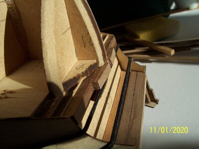

now we have to modify the arrangement of the lower beams. The preexisting ones will be cut flush with the frames and deck.
In the following images, the arrows indicate the added beams:
View from above:
Now we can start thinking about the first planking.
See you soon!

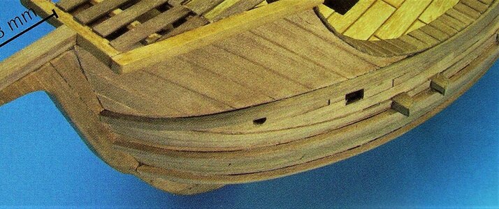

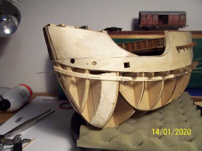

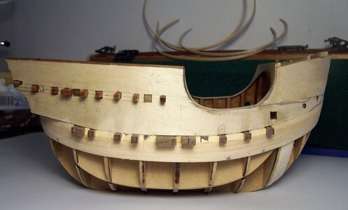

Following the instructions, we have to lay the first planking, then the second and finally place the wales. Both plankings are made with pieces of the strip to simulate the real planks and the result is very nice::
In this way, the wales (glued afterwards) will not be flush with the adjacent planks:f.jpgd.jpg c.jpg
But in real practice, the wales were attached to the frames first and then the planking followed; we'll try to follow the real method in order to obtain this result: a.jpg

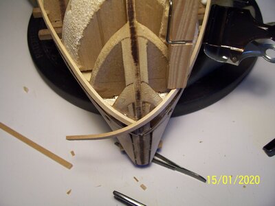

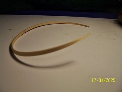

Beginning of the 1st planking with basswood laths:

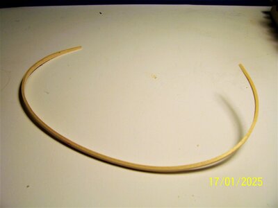

The 4x2 mm strips are great for this work, they bend well on all sides and their thickness will make it possible to correct all imperfections with sandpaper. It is preferable to curve them both lengthwise and upward at the bow (more) and stern (less). The work will be easier if they are curved more than required because then they will be forced against the keel by keeping them pressed against the frames.
I soaked them overnight and then curved them with the iron of my wife on full power. Here is the result:
and this is the final result, with the remaining strips:
Towards the bow, it's preferable to put two shaped blocks of balsa wood to gently accompany the curvature of the strips, that would otherwise be more straight:

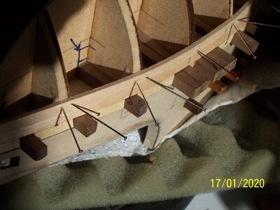

The first lath is glued leaning against the lower beams, at a constant distance from the bulwark, if possible. At the stern the strip ends leaning against the transom:
It's very important to maintain as much symmetry as possible and getting off to a good start is the first step:
For the filling strips between the beams, I chose another type of linden, lighter and wrinkled, to be fixed with a spacer to help maintain alignment:
After that, we proceed by putting more strips towards the keel and always trying to maintain maximum symmetry; the first three courses of planking were not tapered:
