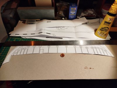

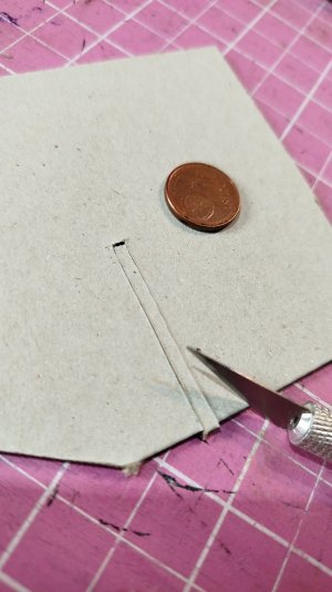

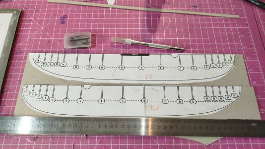

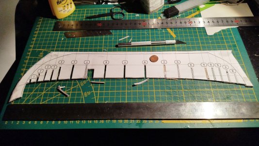

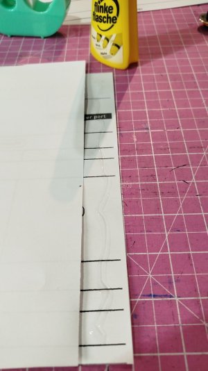

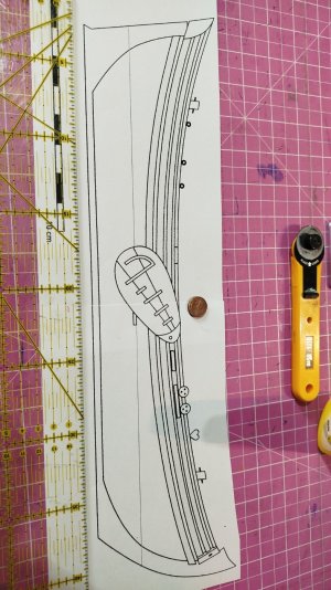

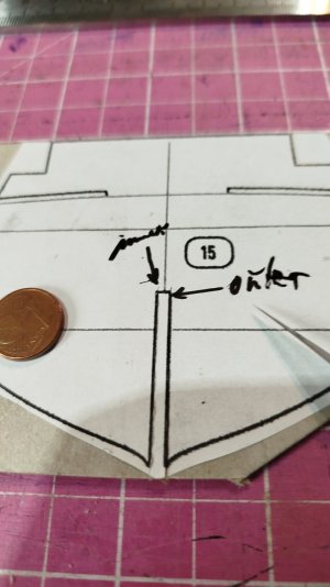

I ordered DIN A2 bookbinder's cardboard and the spine doesn't fit - even laying diagonal by some millimeters.

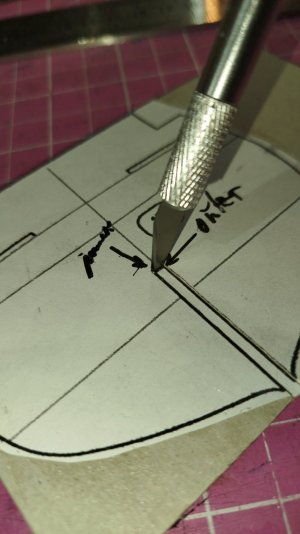

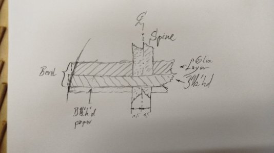

So I cut the spine into two and placed her on top the 1mm cardboard:

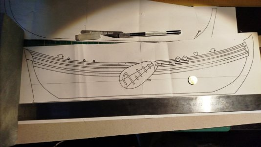

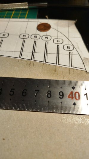

I could not go to bed this night before the very first layer was cut out. The next layer is cut near bulkhead four - and so the laminated spine-parts do fit together giving a stiff 5mm thick centerboard. Being glued together, than the slots for the bulkheads will be added by the use of my trusted Proxxon table saw.
So this night I worked it out this way:

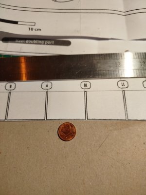

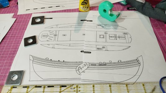

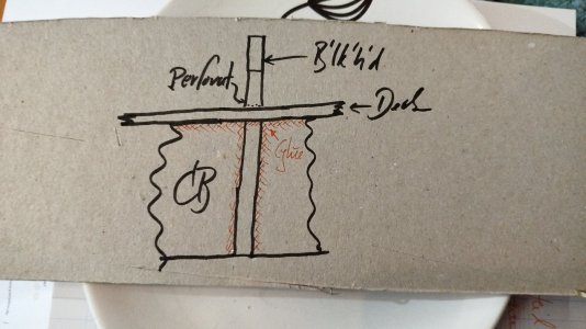

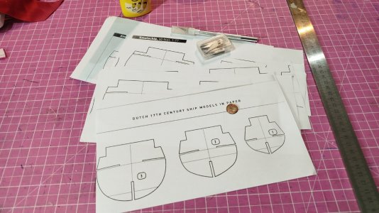

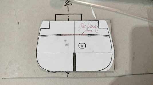

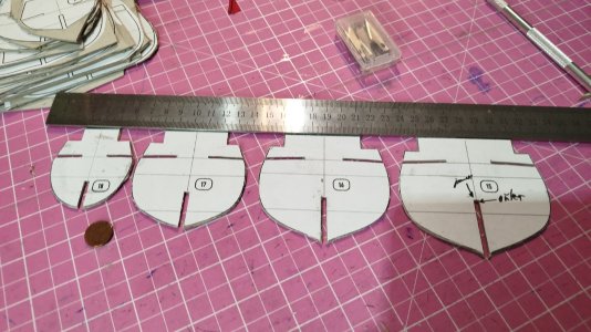

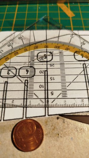

Hello colleauges, fast steps foreward are a great thing to have - after my experience in 1/44 a lot is easier here in 1/33 scale.

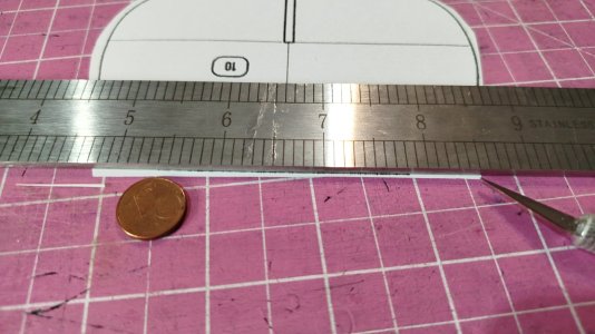

Today I worked with the spine. As my centerboard is a bit longer than the DIN A2 sheets - I decided to change to my pile of 2mms bookbinder's cardboard. By this the hole 5mms thickness is build by three layers.

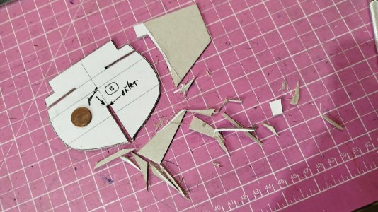

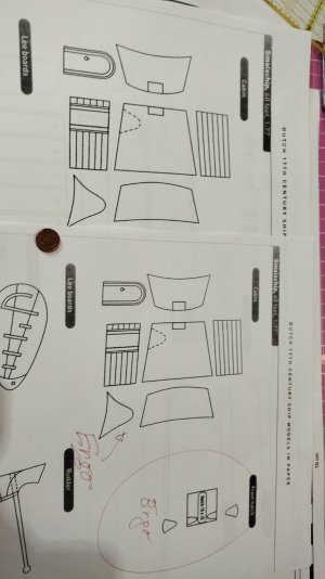

I also was in need of a single sheet per part:

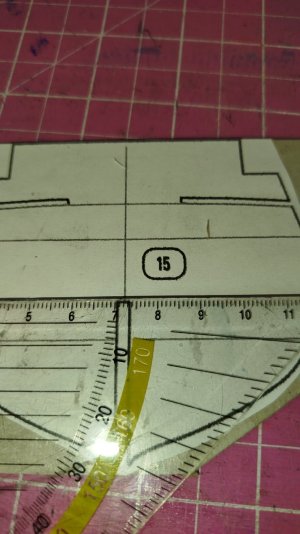

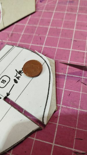

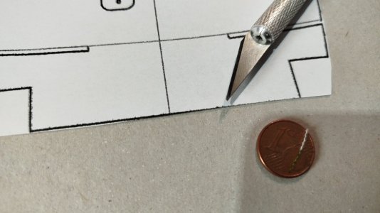

I positionated the parts in an overlapping pattern for more stability. I measured the mid between stem and stern and took there just the very half at 162mms for my slots outside:

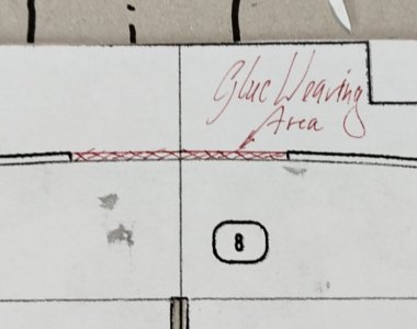

and also added the stand's pair of slots of 5×10mms stanchions to keep the boat upright:
So now I am awaiting my glue to bond.

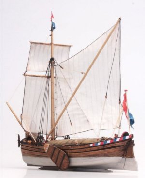

@Ab Hoving
Dear Ab,

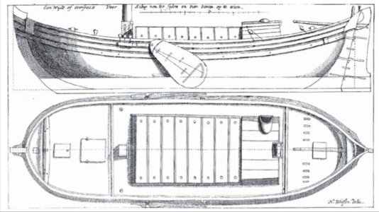

progress is fast in this "semi-kit" by your drawings. So as I want the kick of the struggle of a rigging I would like to ask you for your mast plan and rigging details - because I think when reading to literature I cannot figure it out by myself...
Certainly there is the question WHERE to strengthen the hull tontake the righings' forces.
