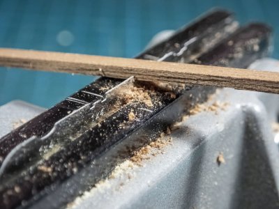

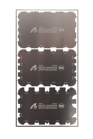

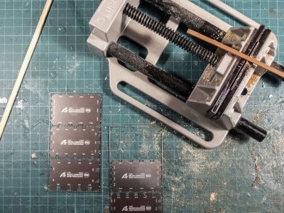

I have the set, and you have to hold low to bottom edge being used, or mount in vise with top side for use and hold strip with top board to apply pressure to help mold the strip.

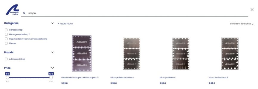

I will just order a set and give it a try. Elsewhere on the web I have read that it works better with the harder types of wood, contrary to what I assumed, also depending on the grain.
Look for the right one you needed, Mike. There are 2 sets.
I used them also on softer wood. Then you have the scrape with less pressure are more moves.
With a blunt knife you can then compact the fibers slightly in the groove again.

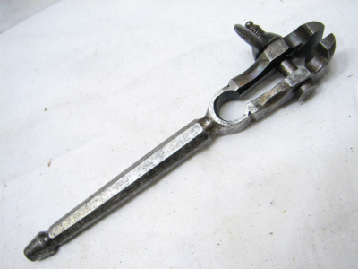

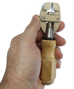

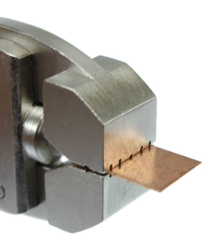

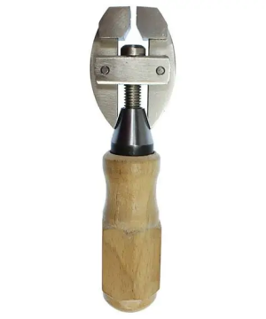

I use a jeweler's hand vise to hold the Artisania scrapers and others like them close to the scraping edge. This significantly strengthens the thin scraper sheet metal and also makes them a lot more comfortable to use.
