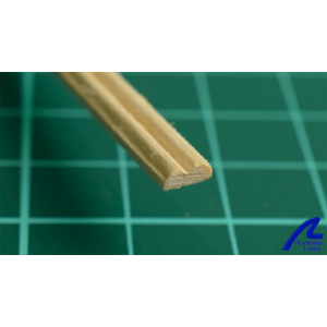

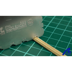

This set of micro shapers allows you to shape / profile wooden and plastic strips. It is perfect for creating moldings with different shapes to decorate their models.
Each set consists of three plates with about 15/16 shapes per plate, so you can get more than 45 different reliefs and designs on your miniatures.
The tool works by scrapping the shape along and over a wooden or platic strip. You can watch video tutorial below.

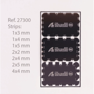

The measures you can find in the micro shapers type A are:
0.040''x0.118'' (1x3 mm)
0.040''x0.157'' (1x4 mm)
0.040''x0.196'' (1x5 mm)
0.078''x0.078'' (2x2 mm)
0.078''x0.157'' (2x4 mm)
0.078''x0.196' (2x5 mm)
0.157''x0.157'' (4x4 mm).
The measures you can find in the Micro Shapers type B are:
0.059''x0.118'' (1,5x3 mm)
0.059''x0.157'' (1,5x4 mm)
0.059''x0.196'' (1,5x5 mm)
0.078''x0.118'' (2x3 mm)
0.118''x0.118'' (3x3 mm)
0.078''x0.196'' (3x5 mm)
0.196''x0.196'' (5x5 mm).

I have this set of tools and they are fantastic. They are very thin so using a lot of pressure will distort the shapes if you let the tool do the work over many passes you will get the best result

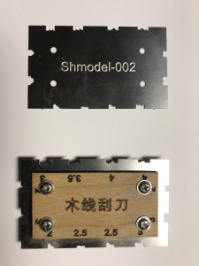

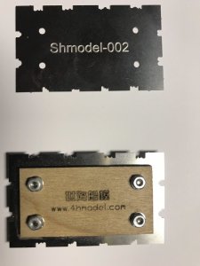

I think for experienced modeller make a scraper shouldn't be a problem. I made my own out of an old\brocken hacksaw blades. I will discuss the method of creating those scrapers in my Charles Royal Yacht log. For those who cannot make one I found those on e-bay. They are 1.5 - 3.0mm

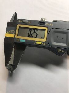

I would not consider those as a quality tool. Convenient - yes, cheap - yea. They were made out of steel, but what kind of steel? I took my needle file, and file along with the edge. Indeed, I was able to file a corner. This is definitely not a machined steel as you would see on hacksaw blades. The scraper is 0.25mm thin, I don't see you can sharpen it, and don't think it worth the try. looks like it is a stamped part, and it doesn't have a proper cutting angle. For basswod, the result might be OK, but any hardwood most likely fail.
