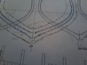

HI GILLES AND MIKE, I AM GOING TO POST A PICTURE IN THE Le ROCHFORTE LOG, FRAME No. 25 through 32 and SOME FRAMES IN THE BOW SECTION ALSO MY PLAN TO DO THESE TYPE OF FRAMES IS TO MILL THE NOTCHES as a a one piece section for where they go once i have the notches milled where thbelong i want to cut the vertical ito the 2 pieces as shown on the FRAME PLAN I KNOW THERE ARE OTHER WAYS TO DO THIS BUT FOR ME AND SKILLS AT THIS TIME (AGE) I FIND THIS ABOUT THE BEST WAY TO DO THIS, AND LOOKING AT THE MINI-CHOP SAW NOT GOING TO WORK AT ALL, RIGHT NOW THINKING ABOUT USING MY BAND SAW WITCH HAS A FINE TPI BLADE AND USING SOME CLAMPS AS HOLD DOWNS OR SOMETHING SIMULAR TO THEN MAKE THE VERTICAL CUTS AS NEEDE THE OTHER PICES OF THE V FRAMES DO NOT PRSET A PROBLEM AS I DO NOT HAVE TO WORRY ABOUT THE NOTCES AS I CAN OVER CUT THE VERTICALS AND FINISH THEM ON THE DISK SANDER, ANY OTHER IDEAS WOULD BE A BIG, BIG, HELP I will post frame No.25 with this message and then re post in the log. THANKS ALL don20200318_211905.jpg
Hi Don,
In this case, You really can make the cut with any saw. it does not even have to be perfectly straight as the 2 parts will fit perfectly as long as you do not do anything to any of the surfaces to be glued: if you see what i mean.
G.

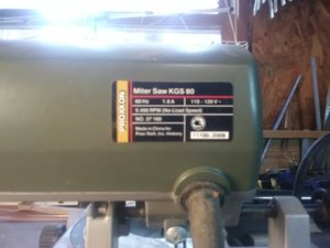

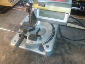

I have a Proxxon, mini-chopsaw that I got from Micro Mark about 10 years ago. I bought it for use at work then kept it for use at home. It has since sat around with very little use. The saw blade has 27 teeth and cuts quite smoothly. There is a finer-toothed blade available but I don't have one., I do have 4 abrasive cut-off wheels (2 for ferrous material and two for non-ferrous) and two diamond cut-off discs. Attached are some photos of the saw. If you care to have it, pm me and I can arrange to ship it.
OH YES INDDED I WOULD IWOULD ALSO COMPENSATE YOU IN ANY WAY, I WILL PM YOU NOW, AND GIVE YOU DETAILS AND EMAIL ADDRESS> THANKS SO MUCH SO MANY WODERFUL MEMBERS HERE THE WORLD SHOULD TAK NOTICE OF THIS FORUM AND HOW PEOPLE INTERACT. DOM
