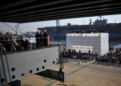

In this photo from the decommissioning in 2012 you can see that the drain holes are plated over. Compare that side view to the one below.

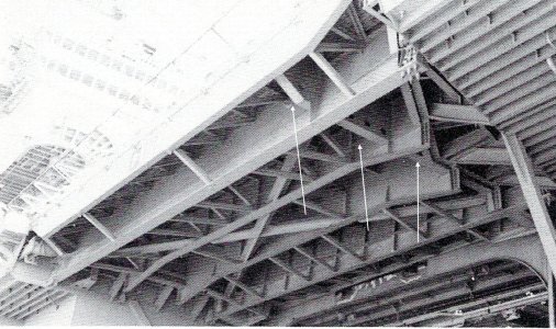

This photo of Elevator 1 from the same time as the one above shows the construction of the support system very well. The white arrows are pointing to the bisecting frame.

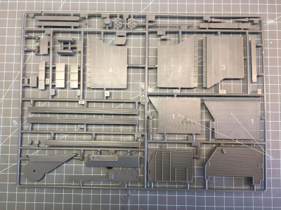

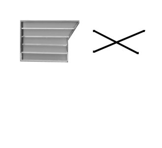

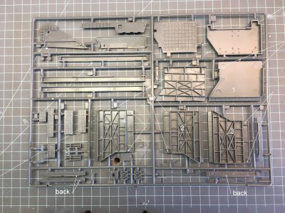

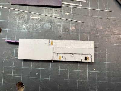

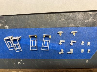

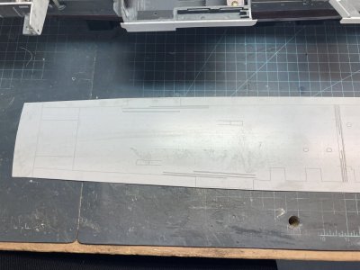

Sprue C (2).JPGSprue C
The upper side of the kit elevators, the arrows point to the 2 kit parts for Elevator 1. These are the parts you will work with.
The underside of the 4 elevators. The arrows point to the 8 openings in the sides.

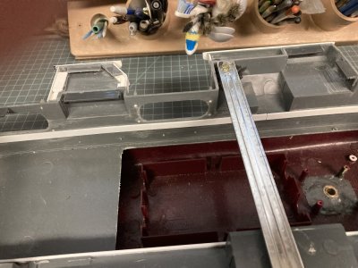

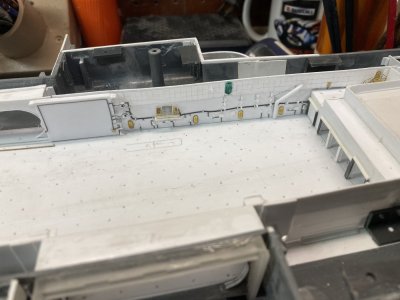

On the model I intend to have the starboard elevators all up and number 4 on the port side down. Each elevator will be as accurate as I can make it. The elevators in the kit have an approximation of the support structure but if you want to accurize them a good bit of work will be required. The grated deck plates that I purchased from Gold Medal Models are very nicely done. They fit very well. But all of the existing deck on the plastic parts must be removed to use them. The fore and aft beams in the under structure match up with the plating on the Photoetched deck and should be retained but they were on the thin side. The other braces were just not correct.
I determined that the best way to proceed was to use a razor saw, drill and burrs to remove the material and then sand or replace the beams. In the end I only retained one beam out of the 4 elevators. If you just try to thin the deck by sanding it, you will lose some of the vertical height of the elevator, (around .060”) and this will have to be replaced. I did have to sand the molded grating off the elevators. As a result they were not thick enough for the 2 support trusses to fit in the under deck area and I used a .040” X .040” strip between the elevator and the truss to get the spacing right.
This photo shows Elevator 1 opened up between all the beams and they all have been replaced along with the back wall. The side gaps are also filled. It is dry fitted to the opening. So far, so good.
The elevators all need to have the inside or rear wall added except Elevator 1. It is a separate “L” shaped part for 2 thru 4, but is part of the insert for Elevator 1. For the other 3 it adds more material just under the deck that must be removed. It is also too wide because of the kits mounting system. There is a portion of the outer fore and aft wall (side wall) that is cut away on both sides of each elevator between the rear wall and the last beam on the kit parts. I could not find any photographic evidence of this gap. My research shows this to be solid like the rest of the outer frame. I used scrap plastic to fill this on all the elevators. 8 patches total. On Elevator 1 the under structure is a separate part. I was going to glue this in place and then treat it like the other three elevators but the 4 beams don’t fit tightly. They didn’t touch the side walls. I ended up cutting the deck away and replacing all the beams. I used the photoetched deck to get them located right.

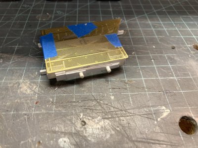

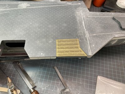

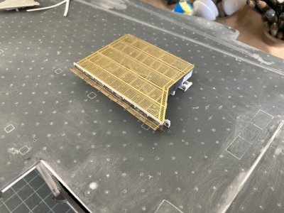

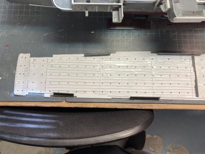

Here I have checked the fit of the deck plate to the opening.

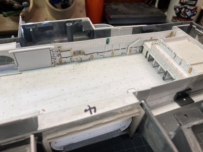

The Tamiya kit has elevator 1 molded in place with the flight deck. In this case I was glad that I had the MHM kit vice the Tamiya. All of the Tamiya elevators have a separate structural part that is glued to the underside of each elevator. I just had to deal with it on Elevator 1. The separate structure is molded on a flat plate that would make twice the thickness of deck to remove. I read an article and saw some in progress photos where a modeler drilled out, filed and sanded to remove all the plate material just leaving the structural parts. It is a lot of additional work and most of the structure isn’t correct anyway. He also used the photo etched deck. He had to remove the entire deck surface of the elevator too. It would be difficult to use the photoetch grates on elevator 1 of the Tamiya kit without removing it from the flight deck. If you leave it in place you will have to remove material from the deck side to compensate for the thickness of the photoetch. It doesn’t make much sense for Tamiya to have just one elevator molded in place with the flight deck.
With Elevator 1’s deck removed and new transverse beams in place I checked the fit to the flight deck and the fit of the photoetched deck to the elevator which was pretty good. A small strip must be added to the angled section and another to the inside edge of the elevator opening for a perfect fit. I wanted to add the X shaped cross brace that I could see in photos and then the Eduard photoetch trusses. Two of the beams have trusses attached which extend past the edges of the elevator frame. These are the supports and connections for the Elevator cables. They are not provided in the kit but the Eduard Set Part 4 has them for all 4 elevators. The cross brace runs between the two beams with the trusses corner to corner. It is a T Beam structural part. It is welded at each corner and where it crosses the two center beams it appears to be cut and welded to each.

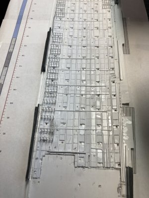

This is the scanned image of Elevator 1 and the drawing of the cross brace I made.
I scanned the underside of the 4 elevators and then drew the cross brace on the scan in Corel. I only kept the drawn part discarding the scan. I printed the drawing on card stock. The Elevators are almost the same except Elevator 4 which is a mirror image of the other 3. Elevator 2 and 3 are virtually identical on the model. In real life none of the elevators is the same, they are distinctly different. My drawing worked for all 4. I put wax paper over this and taped it down. I could lay the plastic strip on the wax paper, tape the pieces over the diagram and glue the individual parts together. On the longest section I used a full length of .015” plastic strip. The remaining legs were two separate pieces. On the upper side (the visible side is the lower or under side) I added a rectangular brace at the cross point. Then on the underside I glued a thin strip to the center of the pieces to represent the T Beam. This time I used a full length piece over the leg with multiple parts and short pieces for the other two. It gave the assembly some strength. I let them dry overnight and I lifted them from the wax paper as an assembly. I made each leg longer than needed to make sure I got a good fit. I even remembered to make the Elevator 4 brace as a mirror image of the other 3.

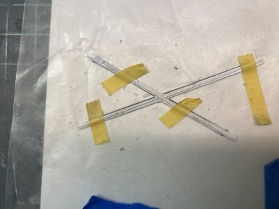

This is the beginning of the assembly.

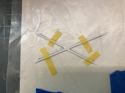

I have added the thinner strip and assembled one of the cross braces.

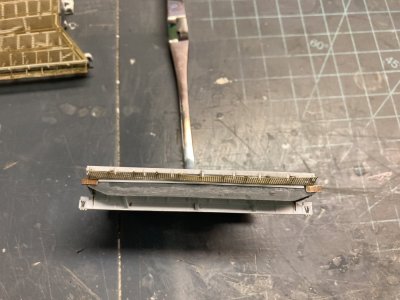

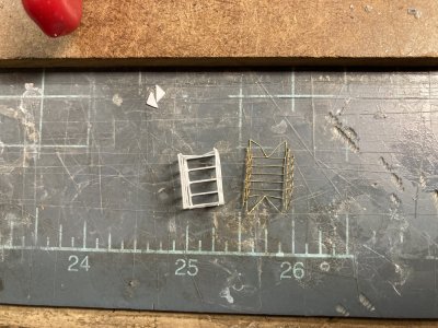

I removed the first 2 Eduard parts from the fret to make the outer truss on Elevator 1. This will be glued to the bottom of the elevator at the first transverse beam inboard of the outer plate. Assembly was extremely fiddly and using CA would get it together only to have it break at the slightest twinge. I decided to remove all the CA and solder it together. It took a very frustrating hour to do this. I would have gotten better with the soldering but when I put it in position on the elevator, it didn’t extend past the edges like it should! I rechecked that I used the right parts and followed the instructions correctly but Eduard made it wrong.
The assembled truss isn’t wide enough.

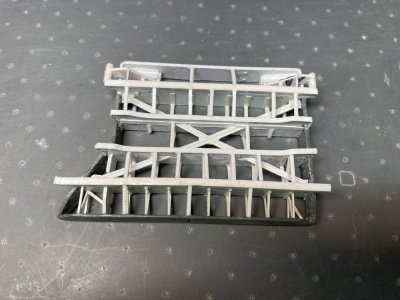

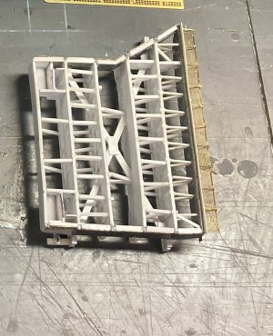

On Elevator 1 I made these trusses out of plastic strip. I fit the elevator to the flight deck attached to the hull to get the width right. Rather than mess with the photoetch for the two inner trusses, (which fit poorly anyways). The kit parts have a cut out on the underside which the Eduard parts are supposed to follow. I just went ahead and made these from plastic as well. This turned out to be a good decision since I had to modify both of these to fit over the cross brace. It was markedly easier to assemble too.
The trusses have been cut out and glued in place. Note the inner center truss has the .010” X .060” strip and the outer hasn’t been fitted yet.

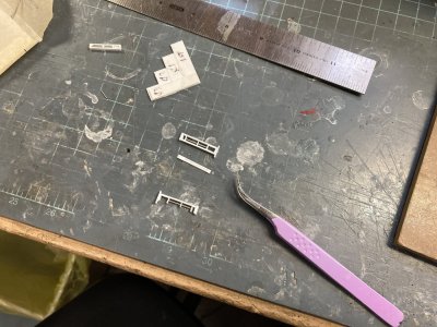

I made the trusses for the two support beams just like the Eduard parts using them as templates to get the sizes right. A .040”X.080” beam was wrapped with .010” X .060” strip on the bottom, ends and then HO Scale 1X6 strip on top. This is heavier than the Eduard parts but it matches the elevator beams I made. These were glued to the bottom of the elevator with the smaller strip up. Various sized strip was used to detail the parts. The two inner beams were done in a similar way using the Eduard parts with the curved outer edge for a template. These only received the .010” X .060” strip on the bottom. They were glued to the center beams. When I added center beams I made them straight across, when I added the curved portions it was easier to mate them up. The 2 center beams are a solid part on the real elevators. Notches were cut for the cross brace and then the 2 parts were glued together. Some filling and sanding was required on the beam faces around the cross brace.
I used the Eduard parts meant to detail Elevator 2’s forward and aft frames as a drilling template for the lightening holes on the sides of all the elevators. This worked well but you need to make sure you drill inboard and outboard of the beams. Don’t just place the template and start drilling. There is also a row of openings just under the top edge of the deck. They are represented on the Eduard piece but aren’t open. I cut down the plastic between the transverse beams on the side walls. I used some vertical ladder material from Tom’s Modelworks to frame the openings. Then I added a piece of strip to reinforce the photoetch at the top. You can see these drains looking up at the model with the elevator raised.

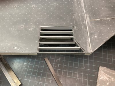

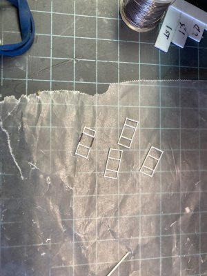

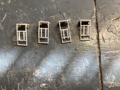

Here all the drain openings are framed with the photoetched ladder material.
Now I have capped the openings with strip to give the ladder more support.

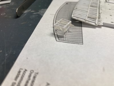

The bisecting frame I made in 3 parts rather than trying to notch the beam that was already in position. This angles up like the sides and has the lightening holes also. I made it only as high as the upper “window” drain holes. Then I made all the bracing between the beams. This is very time consuming because in just the first space there are 46 pieces making up the frames and only 9 are longer than a ¼ inch. The first beam on elevator 1 forms a trapezoid with the front plate so each frame part is a different size. The end result looks good though. I moved on to the next row verifying with reference photos before I made a part. The second row is slightly complicated by the x brace. The third row has only two braces and the fourth is a repeat of the second minus 2 struts. As you add all these struts the elevator frame becomes a nice firm piece.

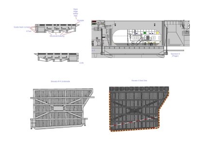

This is what I originally drew for elevator 4. Looking at the framework you will find several things where I diverged from this drawing especially in the guide rollers.
The final space is completely different to account for the part that slides in the guide rails. There is a relatively involved structure to duplicate. I have a few photos of the real elevators but only one which shows this area. The photo turned out to be from the Nimitz or at least a Nimitz class ship. Many of the details are different from Enterprise. The support trusses are a giveaway because they have the cut out like the two inner trusses on the Enterprise elevators. So in this area I used calibrated eyeballs, imagination and guess work. The version in my drawings is close but I drew them with 2 guide rollers on each side which is wrong there should only be the lower one. I didn’t have any interior bracing like on the Nimitz. So I co-opted details from the photo. There is an angled plate that is about ¼ of the width of the beam. It starts below the height of the elevator frame and matches up to the rear truss which supports the guide rollers. This is held off of the truss beam by a vertical metal plate and a strut. On the inner side there is a curved fillet plate that fairs the assembly to the back wall. There are 4 additional struts to support the inside wall.

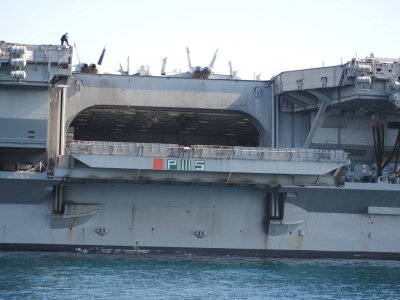

This shows the inboard edge of an elevator showing the supports for the roller guides. It is actually a Nimitz class ship but it gives you an idea of the structure.

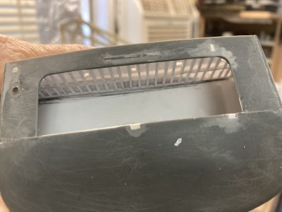

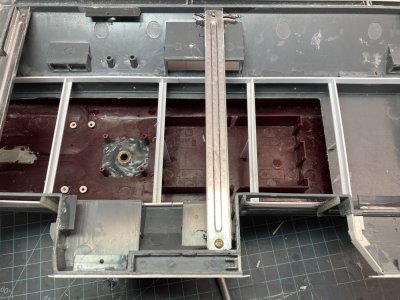

This is Elevator 1 with all frames finished.

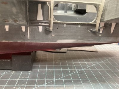

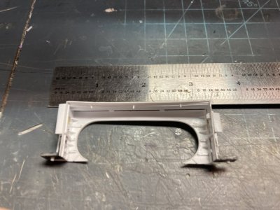

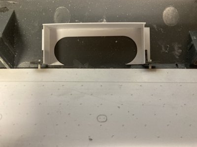

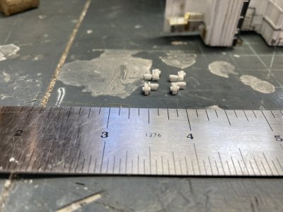

The kit elevator guides are incorrect because the slot the elevator slides in is on the side of the guides instead of the outboard face. Some carriers do have a side slot but not Enterprise. This is primarily for an operating feature on the model that lets you position the elevators as you wish. There is a tab that sticks out of the back wall on each side. Once the kit guides are in place on the model and before the flight deck is glued on you slide the tabs for elevators 1 thru 4 (2 thru 4 on the Tamiya kit) into the guides, and cement the flight deck in place trapping them in the guides. I replaced the guides with an aftermarket set and removed the tabs on the back plates of each elevator. Both kits have this feature.
These are the guides for Elevator 1.

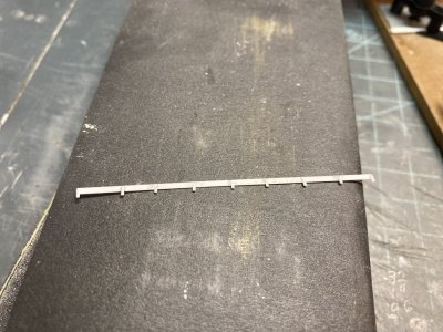

This is my take on the safety nets and coaming on Elevator 1.
This coaming is assembled and ready to install.

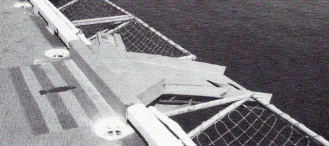

This photo from the 80’s shows the ordnance disposal ramp on the angle. Notice how the nets are rigged.
The nets on the elevators were individual assemblies because sometimes conveyors or brows were rigged to the elevators in port. The nets would interfere with this. You could pull the pins securing the braces and let select nets hang down so they wouldn’t be in the way. The usual manner of mounting the nets horizontally doesn’t look quite right to me. The nets were really steel cable woven into a net and secured at the intersections with swedges, they were laced to the frames with more cable. They sagged in the frames they were not tight. Assembling something to replicate that would be fiddley squared plus.

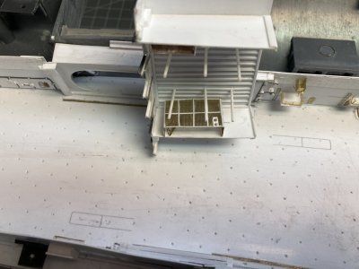

On the trusses for the elevator cables there appear to be 5 cables which are routed through a block of some sort and then are secured to the truss with nuts and washers. I had thought this originally was some kind of multiple pulley block and tackle arrangement but that would mean that each set of elevator cables would have been just one wire. There are 3 cables attached to each outboard edge and 2 inboard. I used a piece of .040” X .060” strip to represent the block. Bits of lead wire are for the 3 cables on the outboard face. I didn’t do the inboard because on the elevators that are up you won’t be able to see them. Then I used punched discs to represent the nuts and washers.

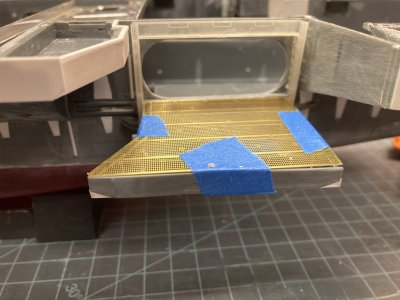

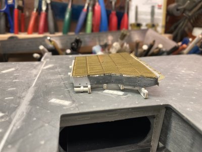

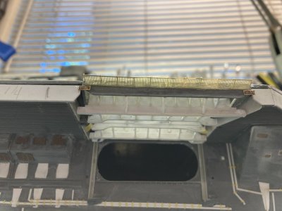

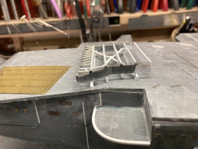

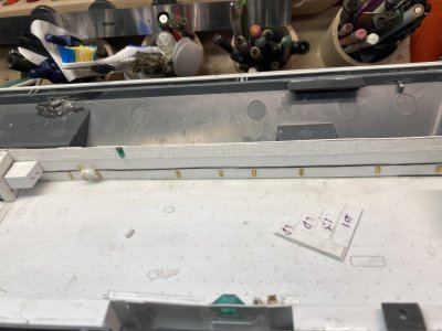

This completed Elevator 1 except for the deck but I did not want to glue it in place till the elevators are painted. Because of all the structural elements it will be easier to paint the elevator from the top and bottom. I’ll paint the underside of the deck with the hull color, allow that to dry and flip it over and paint the deck colors. At this point I am not sure if I will paint the red and yellow warning stripes or use the decals. But doing either will be simplified by keeping the parts separate. Now I just have to repeat this 3 more times.
I think this captures the look of the real one.

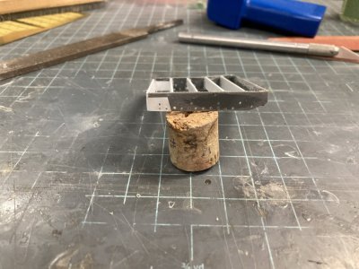

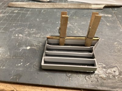

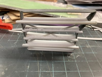

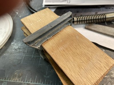

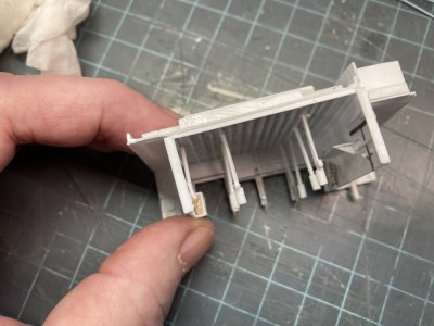

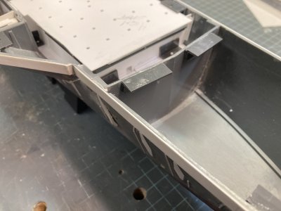

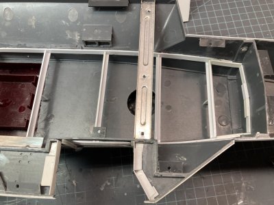

From Elevator 1 I moved on to 4. It is best to work on one space between frames at a time rather than drilling the entire deck area. This gives the part a bit more rigidity as you begin the filing and sanding process. As I opened up more deck I used wood shims to help support the elevator frame. I used a razor saw to cut through the deck between each beam. Then I drilled the holes at each end joining up the cuts. I used a cutting plier to cut the braces in each section. I could break the piece free opening up the space. I used a drum burr to remove most of the remaining plastic. I looked over the beam and if I damaged it or it appeared too thin I cut it away and glued a .040” strip of the correct height in its place. As I said I only kept one of the original beams.
When I was still trying to save the transverse beams this is how I supported them.

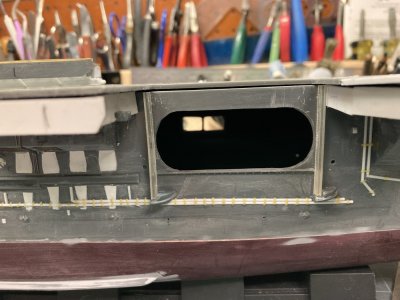

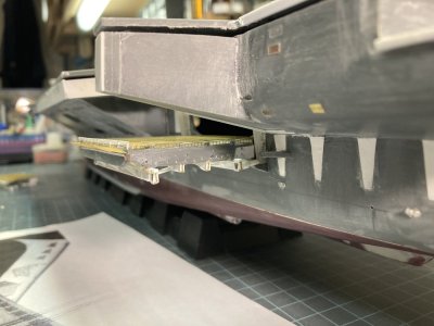

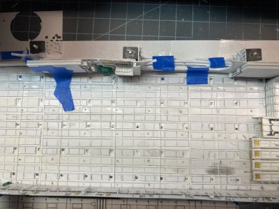

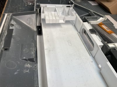

Since Elevator 4 will be in the lowered position I wanted to come up with a positive locating feature before I went too far in the construction. I placed it in position and realized that the lip at the hanger deck opening would require some spacers to hold the elevator at the right distance. The Elevator 4 door well has the widest lip of all the elevators. I added blocks of plastic scrap on the backside of the inner wall of the elevator until it was positioned in the right spot. I drilled two .10” holes below the lip through the hull spaced about ¾“ apart. I taped the deck plate in place and then taped the elevator in the down position making sure that the deck was lined up and level with the lip. I used the .10” drill bit to just make an impression of the correct location on the rear wall by twirling it by hand through one of the holes. I removed the elevator and drilled the hole. I then fit a .10” rod onto the elevator. This was glued from the inside. The elevator was placed back on the hull now using the single rod to position it. I taped it again to hold it there and marked the second hole. This was drilled and pinned in the same way. I can place Elevator 4 in position and it matches up perfectly every time.
Elevator (103) Elevator 4 holes under the lip Elevator 2,3 and 4 progress.JPG
Here I have drilled the mounting holes under the lip.
Elevator (102) Elevator 4 spacer blocks and pins Elevator 2,3 and 4 progress.JPG
This shows the spacers and pins on the back wall of Elevator 4.
Elevator (101) Elevator 4 pinned in position Elevator 2,3 and 4 progress.JPG
This is Elevator 4 with the deck taped in place and mounted in the lowered position.

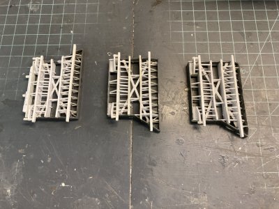

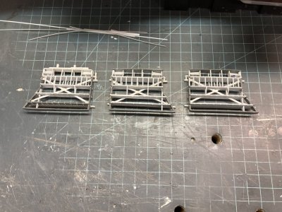

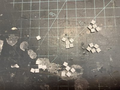

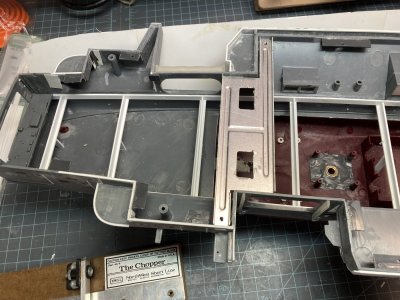

Detailing the remaining three elevators was an assembly line process from then on. When I got to a point where one elevator needed glue to set up I simply moved on to the next and brought it up to my latest stopping point. I was able to use a Chopper cutting tool to make several pieces of the same size. It sped things up considerably. I could use the prototype Elevator 1 whenever I had a question about materials or construction. On Elevator 4 when I made up the trusses I had to detail the inner sides since you can see them from above on the starboard side. I also drilled out the cable blocks to accept five wires. On Elevator 2’s deck I decided to use my second set of plates to come up with a fully plated piece for it. Elevator 3 comes closest and it matches up to the padeyes on the flight deck. It took several weeks to put the finishing touches to all the elevators. The results are pretty good in my opinion and it felt like a major item was completed. In order to complete the various sponsons I will need the elevators to determine the location for the slot that the inner truss passes through. When I construct items in the under deck area the elevators will help locate things like the cable reels.
The progress on elevators 2 thru 4.
All the framework and bracing is completed on Elevators 2 thru 4.

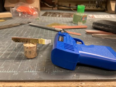

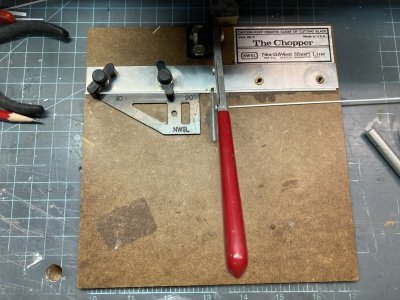

When you have to duplicate several hundred parts this tool is invaluable.

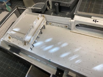

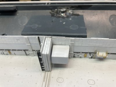

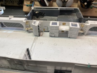

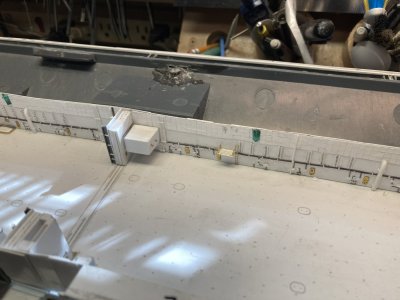

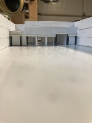

Elevator 4 needed one last detail. If you look at the 80’s side view phot o there is some detail on the ends of the beams that I just didn’t know how to replicate. Nothing I could think of would be fine enough to make raised detail on the ends. I was looking for something else and sumbled on the solution. I found some 1/400 scale railing in my stash. I could cut it up at the posts and…
Looking at the ends of the beams on Elevator 4 you can see the result of trimming railing and gluing it on the end plate.
The other side.

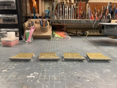

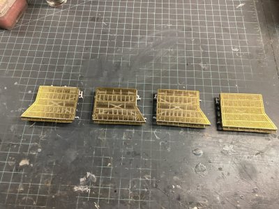

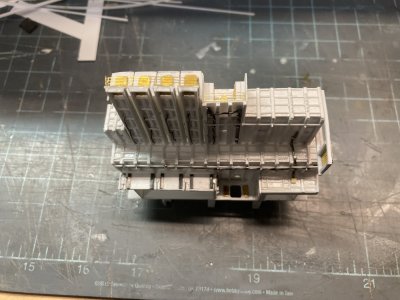

The 4 elevators finished.
The 4 elevators from above I like the see through effect.

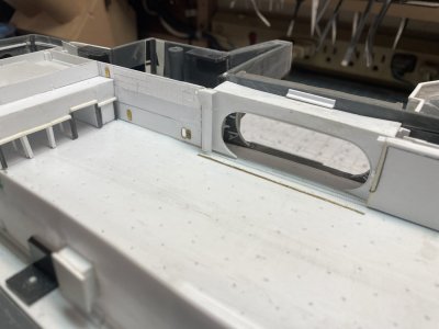

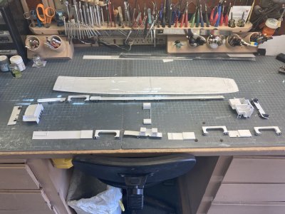

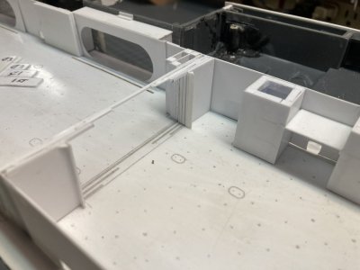

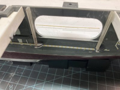

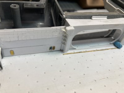

Part 8 The Hanger Deck
In this part I document my build-up of the hanger deck. I had to make 4 separate posts to accommodate all the photos and additional information.

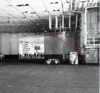

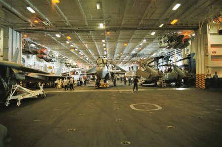

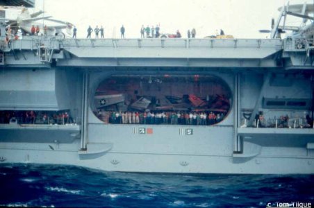

This appears to be some sort of time lapse of the hanger note the group of people to the right which are faded out. It was taken in front of the Power Plants shop facing forward. All the elevator doors are closed. The forward end is in its original configuration before the addition of the overhanging shops. All the way forward the roll-up doors to the left are the GSE shops. Just off the centerline is the entrance to the tunnel and the forward weapons elevator trunk is to the right. You are looking through the divisional doors at the backside of the bulkheads that cover them. The aft weapons elevators are to the right just forward of elevator door # 3 on the right. Elevator door # 4 is on the left.

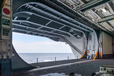

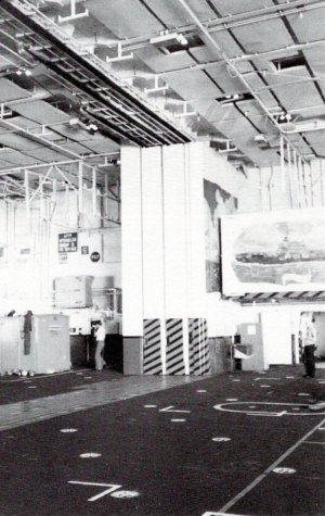

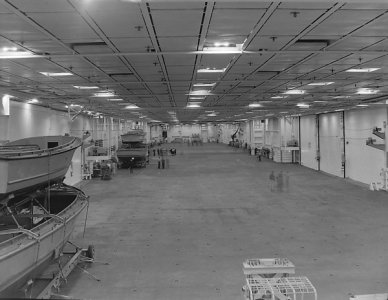

The hanger bay of the Enterprise was a cavernous area divided into two sections. It was 25’ high X 96’ wide (at the widest point) X 732’ long (.85” X 3.3” X 25.1” in 1/350 Scale). It began at frame 62, the divisional doors were at frame 153 and it ended at frame 242. It could house at least 1/3rd of the air wing or about 32 aircraft for CVW-14. At sea, deployed it was a noisy, chaotic scene of maintenance activity 24/7 for the entire deployment unless we were in a liberty port. Then a handful of aircraft were cleaned up and placed in the hanger as a display and all the others were crammed onto the flight deck. They did this in ports where visitors were permitted aboard to allow foot traffic with minimum peril from tie down chains and sharp surfaces. Usually they all went to the bow and guests were discouraged from walking around them.

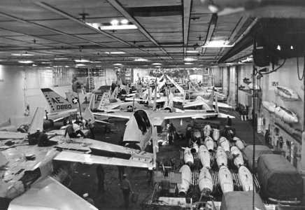

View of the hanger in the late 60’s or early 70’s. Note how the aircraft are stacked in here and there is very little space remaining.
This movement was usually preceded by a flight deck and hanger deck scrub down of epic proportions. Zamboni scrubbers were not in use at the time so it was all done by massive working parties. Each division provided bodies. We manned salt water fire hoses and stiff bristled brooms. First we cleaned the stern then all the aircraft would be moved aft and we scrubbed the forward flight deck. At the same time the hanger would be undergoing the same treatment. If the port was important signal flags would be hung from the overhead.

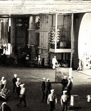

This is the GSE area in the early 80’s after the rework that changed the island. On the overhang at the 02 level the vans are not installed. The openings are the forward entrance to the vans.

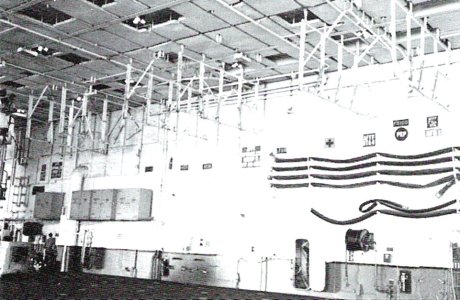

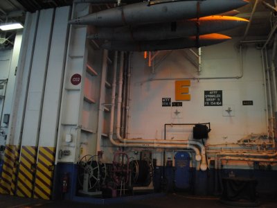

The hanger had a great deal of installed firefighting equipment, salt water fire hose stations, AFFF hoses (Aqueous Film Forming Foam,) these were the older flaked hoses not the reels which would be installed after the 1978 deployment, spare hoses, hose extension wands, battle lanterns, sprinkler control groups, CO2 and PKP fire extinguishers, litters and first aid boxes. Looking over it all were the 4 Conflagration Stations high up on the bulkheads 2 per Hanger Bay. There were several lockers for damage control teams, life jacket lockers in case of abandon ship and a lot of large shoring timbers were stored on the bulkhead.
Conflagration Station # 1 was the master control station Conflag #2-4 were smaller. The bulkhead markings show the locations of equipment. There is an AFFF sprinkler group control as well as a AFFF and salt water fire hoses. The 440V sign indicates an aircraft power station. Note the incandescent lighting.

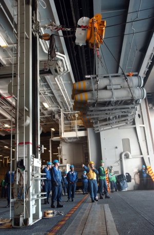

There were 3 fuel and defuel stations around the hanger. There were two sliding padeyes for use during UNREPs and fuel transfer hoses were hung on the bulkheads as well. There were a number of overhead cranes, two for AIMD Power Plants (one inside and one outside), one for the Mezzanine, one for the Calibration Lab and one for the ECM Vans. There were 4 large rectangular hatches in the hanger deck the most forward was a weapons elevator the other in the forward hanger was a shaft for stowing stores I believe. These two both were hinged on the long edge. In the aft hanger there were two more which lifted out on tracks exposing vertical shafts for stores. There were a number of oval hatches which I never learned the purpose of.
Good shot of the midships fuel station from the last deployment 2012. This is pretty much the same layout for this area in 1978 the color scheme is different but most things are in the same places.

This is the hanger during my 1976 deployment.
This is the hanger probably in the ships home port sometime in the 2000's. No aircraft are present and it appears that they are prepping for some ceremony or event. In the bow they have expanded the overhang some more to add a fitness center which helps date the photo.

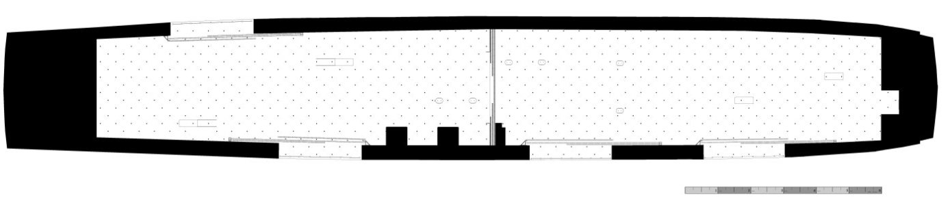

Now on to building a hanger deck in miniature; I have spent more time thinking, researching, planning and drawing this part of the build than it actually took me to construct it. Years ago when I was building the hanger for the 1/400 scale Enterprise, I made the basic parts quite easily but I found that the details were making me go around in circles. I would make the parts for say the shops in the aft end of the hanger and go through 2 or 3 iterations of that set and then maddeningly find some new photograph that had me doing it over again. Tired of reworking the thing over and over, I decided to first collect as many photographs as I could find and then draw a set of plans to lock down what I would build.
First I drew the elevations or the bulkheads for the starboard side, port side, forward, aft and divisional doors. I poured over the photos and painstakingly compiled a picture of the final product. This steamrolled however because after I completed the bulkheads I decided I needed a plan view which became plan views of the 1st deck, 01 level, 02 level and even some of the 03 level. Of course I should include the sponsons and…. then it became a never ending monster. I spent something on the order of 4 years making drawings from 2012 to 2016. I did these drawings in a bitmap raster program called Photo Impact which is similar to Adobe Photoshop or Corel Photo Paint. These drawings were originally made for the AMR 1/400 scale Enterprise but are up-scaled to 1/350. There is a 6 inch ruler on each drawing to help you get the size right.
I tried downloading some of the drawings below myself to make sure it worked and it appears it does not. If you want to get decent files go to the end of the fourth part of this post and there is a link to some better quality files.

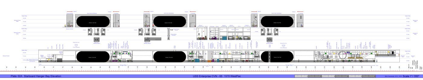

Plate 02A Starboard Hanger Bay Elevations

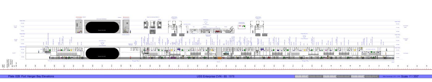

Plate 02B Port Hanger Bay Elevations

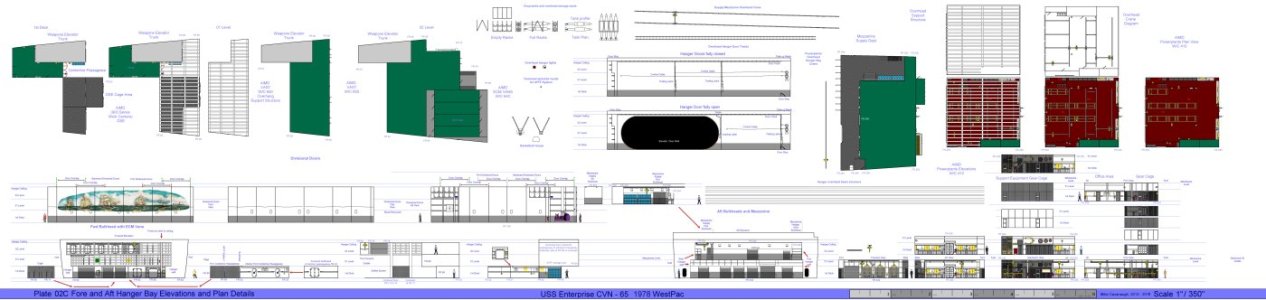

Plate 02C Fore and Aft Elevations and Plan Details

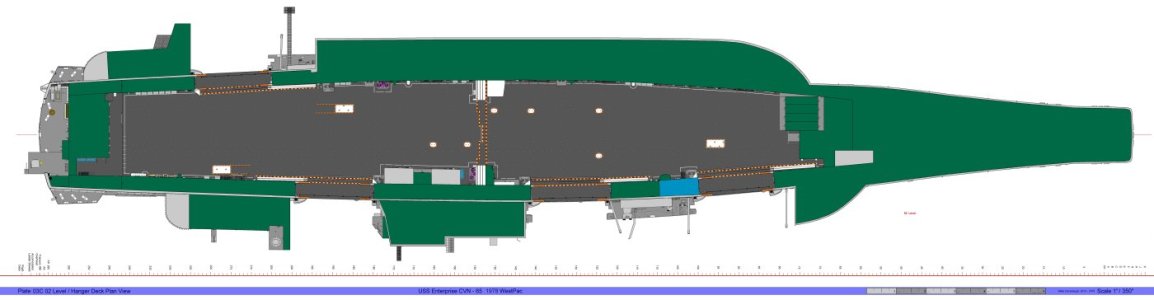

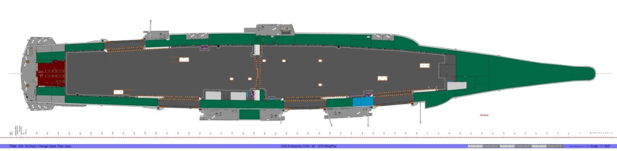

Plate 03A Hanger Deck 1st Deck

You may use these drawings for your own models, but keep in mind that unless you are building the A/M/R version they will only be useful as a reference.
When I went to the MHM 1/350 scale kit I thought I would just up-scale the drawings. Unfortunately the two models are not simply a different scale kit of the same thing. The locations of the various items are not the same. I needed a drawing of the hanger deck for this kit. I really did not want to start from scratch. On an IPMS website I found a review of a set of drawings for the Tamiya kit. The drawings were by a fellow modeler named Tom Pope. I put the link below again. His drawing will allow you to cut out most of the deck and drop it into place. He has copyrighted his drawing and there is a small charge for it.
https://reviews.ipmsusa.org/review/cvn-65-uss-enterprise-hangar-deck-scale-drawings

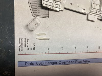

I took Tom’s drawings and added some details from my research. I made them the full length of the aft hull from the where the bow is glued on to the fantail. I marked out the locations of the bulkheads. I added the deck hatches and door tracks for the divisional doors and the hanger doors. I got ahold of Tom and obtained his permission to post those drawings for these parts in this post and you may use them for your models.
Hanger Template
Hanger Overhead Light Template. The lights here were moved around to better fit my model so you may find that you will need to adjustments.

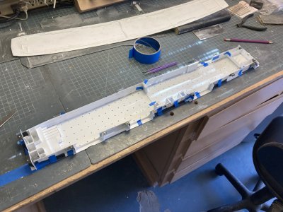

To add the hanger deck you first have to make some way to support it. I took some fairly heavy Evergreen strip, .060” X .250” and began gluing it to the inside hull below the starboard hanger doors. To make sure that it was the right height I took a small piece of .060” X .060” strip and laid it on top adjusting the height until the small strip was just flush with the door opening. While the first section was drying I measured from the heavy strip to the hull bottom at the doors. I used this measurement to adjust the strips where there wasn’t any visual reference. This is made easy in the MHM kit as the upper hull is cut off at the waterline which gives it a constant depth.
Here I have started the framework for the hanger deck.
To make cross beams I measured with a pair of dividers and glued sections of the heavy strip under the longitudinal stringer on the hull. Then I glued another piece vertically on top of the horizontal beam. This formed a T beam and proved to be very strong. You want to be accurate as possible here because if the beam is too wide you will distort the hull. Wherever possible I added a vertical support under the beam in the center of the hull. There is one where the motor and transmission will be installed that does not have a vertical strut but this doesn’t seem to be a problem. I used solvent glues on this part of the job because I wanted the parts to be welded together. Later when I had to make the hanger deck from .040” sheet instead of the .060” I added a cap of .020” X .060” strip to the top of the entire framework structure.

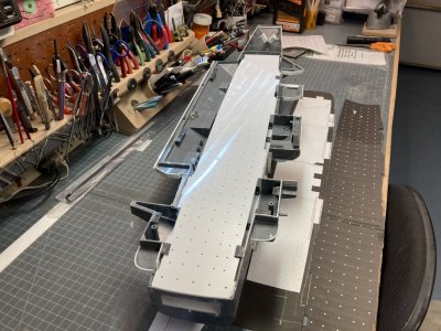

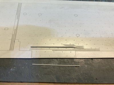

The Silhouette machine was made for scrap bookers and other home crafters and was designed to cut paper, cardboard, vinyl and things like that. I saw a video review of the thing on a modeling website cutting plastic sheet. I was hooked. I asked for it for Christmas that year. It is very handy and I confess that I use it a lot. It simply cuts straighter and more accurately than I ever could. But like all technology there is a learning curve. I made a new drawing based on Tom’s hanger and printed it out as a banner before I made the plastic version. I cut the diagram out and set it onto my hanger support structure. It dropped right into position. But the drawing indicated where some corrections were needed and these were made, printed and confirmed. This base drawing was used to build up the program for cutting and engraving the hanger deck in the Silhouette Design Studio proprietary software. When I did the hanger for the AMR Enterprise it was several days of cut, sand and try it then repeat trial and error.

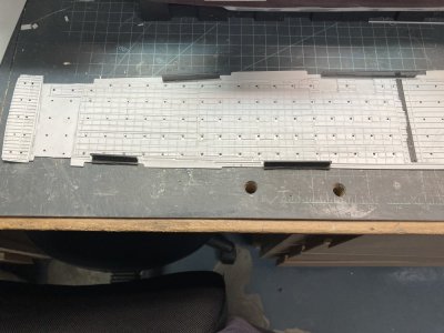

Here I have printed, cut out and laid my drawing on the frame to see how it will fit.
The material you want to cut is placed on a self-adhesive cutting mat. You then load the material and the mat into the machine and adjust the cutting settings and off it goes. The mats are designed to track through the machine with great accuracy. I did find that it was better to use slower speeds, smaller cutting depths, which were increased gradually for deep cuts, cutting complex drawings in several smaller jobs and making multiple passes. Now for this to work you don’t want the material to move on the mat. Even with a new mat the plastic sheet tended to move on the mat in tiny increments. This would ruin a cut project immediately since the mat is the reference point. My solution was to tape the work down on the mat. Do not rely on just the adhesive on the mat. But do not place tape where the machines primary rollers will go directly over it. I found that this would cause the knife to lock up. The silhouette mats are very sticky and might have worked but I found less expensive mats on Amazon so…
The literature I received said you could load larger projects directly into the machine with no mat. It might be okay to do this with paper or card stock but it did not work with the large plastic sheets. They slipped easily. The Silhouette folks make a 12” X 12” and a 12” X 24” mat but nothing longer. I took a 12” and a 24“ mat put them end to end and taped them together then placed my plastic sheet on it, taped everything down and still had problems until I cut a .040” sheet in half lengthwise. I just about had the .060” sheet working but ran out of unmarked blanks. When I ran the .040” material into the machine it finally worked beyond all my expectations. It took about 4 hours cutting slowly and multiple times. It did not shift on the mat nor did my homemade 36 inch mat shift in the machine. Full plastic sheets were just too heavy. There isn’t a setting for a 36” mat so you have to use the no mat settings.
This how I arranged the machine during the engraving and cutting of the hanger deck.
I tried to draw several versions of padeyes for the machine to engrave but none of them worked well so I settled for a small index mark at each padeye location. I used the same tool that I made for the flight deck to represent padeyes in the hanger. I used the same spacing for the padeyes as on the flight deck.
The newly cut hanger deck sitting beside the model.
In each elevator well there is a railing that raises and lowers depending on the position of the elevator. When the elevator is up at the flight deck the safety rails are raised in the hanger. Or if the elevator is down then the barrier is up on the flight deck. I set up an engraving for this too because the real thing is recessed in the deck. I will need to manually scribe them on the flight deck as well. The door tracks have a series of rectangular metal plates that move with the doors as they travel. They cover the actual track to keep out debris. Finally inboard of the hanger door tracks is a grate over a scupper or drain for sea water. I probably could have gotten the machine to engrave something for this but I just represented it with a thin rectangle. I had the machine cut these nearly all the way through. Later I punched them out and glued a .030” X .040” strip in the slot partially filling it. I cut some photoetched grating material and glued it in the remaining .010” space.

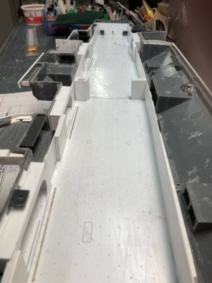

When I placed the plastic deck onto the supports it fit very well. I had to sand the bow and stern area edges at an angle to match the shape of the hull. There were some places with gaps but most of those would be hidden. Around Elevator 2 I added some strip to the edge to fill a gap. I also added some to the fantail and bow to get a tight fit. That was my fault for sanding a bit too enthusiastically. I was very pleased to get this all to work so well.
It fits!
The plastic of the models hull is very thick, .060” or more in places. The hanger door openings, the fantail opening and the various doors needed to be thinned down for a more scale appearance. I laid the hanger deck in place the glued sandpaper to thin wood shim stock. This can be held against the hull and you can sand the hull without marring the deck. I thinned the hull to approximately .040”. This step had to be complete before I started building up the bulkheads.
Sanding down the elevator door area.

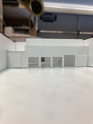

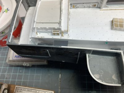

The Port side only has the aft bulkhead mirroring the port. I used .020” sheet to make these and separated them from the doors with .010” strip. The center set of doors has a keyed edge to fit snugly together when closed. I used .010“ X .020” strip on the edge of the doors to simulate this. On The port side a single strip centered vertically and on the starboard side 2 strips with a corresponding gap in the center. I used some very fine pieces of strip to fashion the upper door tracks. This was some finicky stuff but I finally got all the parts in place and aligned. The 4 sets of hanger doors were made the same way but they are the full height of the hanger. They were spaced with the .010” strip from the bulkhead. These were glued to the hanger bulkheads in the open positions. The upper tracks will be done later.

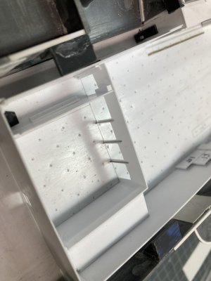

The two ordnance elevator shafts were made from .020” sheet backed up by thick strip. I first tried to pin these to the deck but went with gluing them to the bulkhead instead. Up until the yard period after the 1978 deployment there was a deck at the 02 level spanning them. There was a hoist that allowed large items to be brought up to the Calibration Lab as an option to the platform at Elevator 3. This was walled off sometime after that deployment but I am not sure when. Originally I thought these shafts had been rounded off on the vertical edges but a couple of good shots of the area finally came my way and dispelled that notion. The exteriors will require detailing with strip but during this initial part of the build will be just the basic construction. The doors to Sponson 7 lead to the After Brow or the enlisted access to the ship which was used in port tied to a pier.

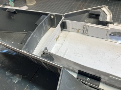

When Enterprise was launched the forward bulkhead was a doorway to the tunnel area of avionics shops and supply work centers. The bulkhead at frame 62 is the doorway. There is an overhang over the door and a protrusion of the forward weapons elevator trunk on the starboard side of the entry way and GSE Shops on the port side. They extend out from frame 62 to frame 66. These features form the bulkhead of the forward hanger bay.
The completed basic forward bulkhead.

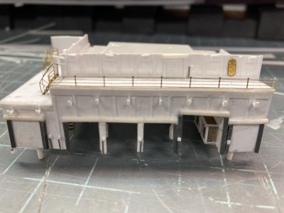

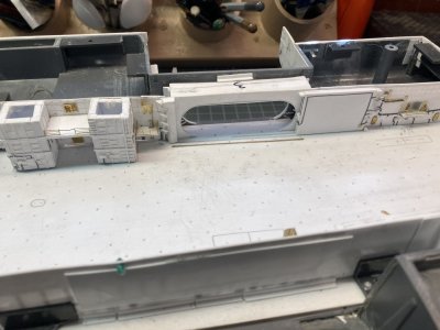

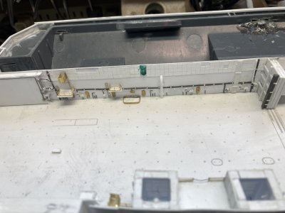

I moved on to the shop area at the aft end of the hanger. The center section is AIMD Powerplants which has a large watertight double door out to the fantail which I have opened. This door is taller than standard doors to accommodate engines on trailers going out to the test cell. There are 4 roll up doors for Powerplants which will be open. To the port I believe was the Tire Shop and on the starboard side was Airframes. I am unsure of what was above the Powerplants Shop. Each of these has 1 Roll up door which will be closed. These shops were unique in that they were 1 ½ decks tall to starboard and 2 decks tall for the center and port. This was to accommodate the overhead crane system inside the Powerplants shop. Above Airframes was the Mezzanine which belonged to the supply department. To access it you had to go to the 02 level on the starboard side, through a door and down a short ladder. I got assigned to this area during a working party along with a friend who knew the way up to it or I would never have found it.
Hanger Deck (86).JPGHanger Deck (86)
The aft structure pinned in place.
The build-up of this area is much more straight forward than the bow construction. I already had the forward and aft bulkheads. I made 2 Side bulkheads both the height of the Powerplants Shop. I glued these to the forward bulkhead and reinforced the joints with strip and angle. I was a bit worried by the flimsiness of the area around the roll up doors though. I glued the door material on each of the outside shops to represent closed doors. I decided to pin each of the center 3 frame posts to the deck. I marked the locations from the front part. I used some stiff stainless safety wire to make pins which I superglued on the backside of the three center door frames. I marked their locations on the inside deck. I drilled each hole just inside the engraved line on the deck. This locates the shop parts solidly.

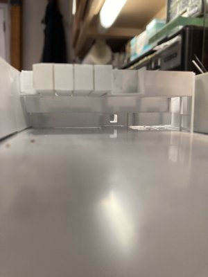

Looking through the completed basic aft structure to the fantail

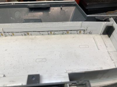

I next fitted the deck for the Mezzanine and then the deck over Powerplants. With these glued in place and reinforced the aft shop area is pretty solid even if the aft bulkhead is not glued in place. I had to extend the port bulkhead at the Mezzanine up to the level of the aft bulkhead. Then I made a forward bulkhead for the top structure and reinforced them. With all of these parts constructed but not detailed the basic hanger bay is complete with the exception of the overhead.
The aft structure. The Mezzanine is to the starboard side.

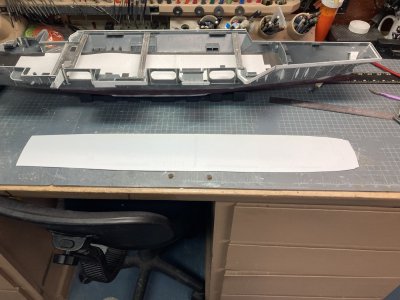

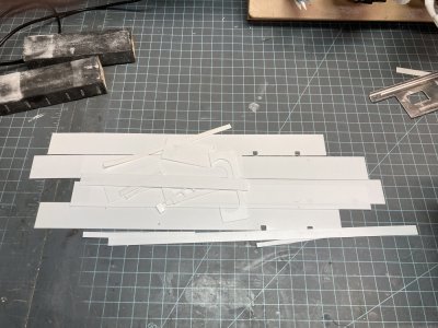

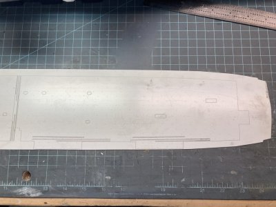

My hanger deck template provided the basic general shape for this part. I placed the printed hanger deck that I used to test the fit of the plastic hanger deck on top of the hanger structures. I made some penciled lines where the drawing will be changed for the overhead. I took this to my computer and made a new drawing for the overhead. I squared off the bow and extended the stern to fit correctly for the fantail overhead. I cut back both sides but left some material to overhang the bulkheads. On my model there are some plastic angle supports for the flight deck around the hull and I added cut outs to fit around them. This was printed and inserted over the hanger again. I found a few points that I wanted to adjust and took those corrections back to the computer.

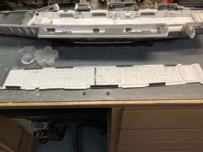

The various parts of the hanger laid out minus the overhead.
Well I have run out of picture room again so I will add a third post.

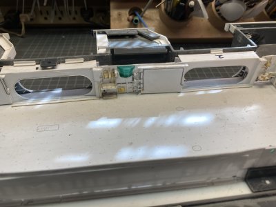

I had two thoughts about how the LED light strips would be used. In the ideal world both the red and white diode strips would be equal in spacing from diode to diode and I would cut the holes in the overhead based on the spacing. I would lay the strips on the overhead with the diodes lining up with the holes. I had purchased the rolls at separate times and they were not the same spacing. My second Idea was to adhere the strips to the underside of the flight deck and let the light come out through equally spaced holes. This is what I went with. I printed out the new ceiling drawing with the light locations and check for conflicts with the interior structures. I moved lights around accordingly on the computer and printed the drawing again. After verifying the final locations I converted the drawing to a cut program in the Silhouette software.

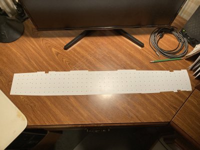

I used all the lessons that I learned making the hanger deck and cut the overhead from a .020” X 6” X 12” sheet. I t went like clockwork and after about 3 hours I had the new overhead. I went out to the model and it went into place with a couple minor modifications. To secure the position I put several pieces of angle around the lip up against the bulkheads. I then removed the hanger and assembled it out of the model. I used tape to hold things together and then added more angle pieces to gaps around the bulkhead to deck joins and then around the bulkhead to overhead joins. I only wish that I could take this whole assembly and drop it in place but unfortunately that isn’t possible. I blame the quasi- engineer who designed and built the thing.
The cut out plastic overhead part. Getting the plastic to poke out of the light holes was a little tedious. If you allow the machine to cut all the way through to the mat these little parts can float around and cause a jam.
The overhead is laid in place.

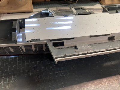

The hanger taped up outside the ship. The overhead has the angle attached to locate it when installed. I have just finished adding sections of smaller angle to finish the locators.

Part 9 Hanger Deck Details Part 1
I last posted back in October of last year. A lot of time has gone by and I have been busy I hope you like what I have been up to.

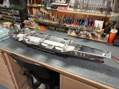

In this photo you can see the lines drawn for the 1st deck, 01 and 02 levels on the hanger bulkheads.
In this part I begin adding details to the hanger parts with the goal of having all possible items in place before painting. Detail which will be added to bulkheads and overheads includes wiring, panels, pipes, soundproofing, doors, framework, tracks and overhead crane guides. Items that would be more difficult to mask over or paint in situ such as lockers, fire hoses and other fire-fighting equipment will not be added until after the basic colors have been painted on the bulkheads and overhead. These items will be painted off the model and installed later. At least that’s the plan.
I first went around all the major parts that I had previously made for the hanger and worked on getting each one to fit more precisely. I added more angle and strip to lock down the position of each part. I added 2 pins to the forward bulkhead of the Powerplants assembly (the one all the way aft) and drilled corresponding holes on the inside deck. This keeps it in the correct position and supports the fantail bulkhead. It also helps lining up the metal pins on the door posts. At the bow I added some angle to make channels to hold the forward bulkhead in place. After all the hanger parts were taped up and securely in position I used my deck height gage to mark the location of each deck on the hanger bulkheads. This will help consistently locate detail vertically. Then I put the overhead in place and checked for locations that needed some angle to hold it more securely.
This photo shows the additional pins on the Power Plants shop. Note that I have also added 6 support columns and additional detail for the roll up doors. The columns were necessary because of the multiple engine hoists in the overhead which required additional support on. The girders spanned a wide space in real life and the engines were very heavy.
I decided to begin with the overhead detail first. I had to replace the upper tracks for the divisional doors because these broke several times. I was trying to keep the doors as a separate assembly but decided to add them to the bulkheads and make new tracks. I removed the tracks from the doors and glued each block of doors to the appropriate bulkhead. This had the added benefit of positioning the bulkheads at the midpoints of the hanger since the doors already had their own locater pins. I made a new set of tracks with some 1/16” ABS Plastruct Channel.
I should have used this material in the first place because it was stronger and more rigid than the set I made which was very fragile and kept coming apart. The 5 pieces of channel were first glued together on a sheet of wax paper and when they had dried I set them on top of the divisional doors and held them in place with Blue Tack. I set the overhead in place and used a long brush through the hanger doors to cement them to the overhead. This correctly located the tracks on the ceiling. If I had built the door tracks this way in the first place I probably could have kept the assembly as a separate part.

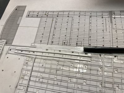

Here the hanger is upside down with all the parts now taped to the overhead. I am in the process of marking the overhead for the vertical part locations.
To start detailing the overhead I had to determine where the bulkheads would be located in relation to it. I removed the hanger from the ship and taped all the parts to the deck again. I placed the overhead in position and taped it in place also. I flipped it over so the assembly was resting on the overhead. I removed all the tape holding the deck in position and removed the deck. This allowed me to run a pencil all around the inside, marking the locations of all the bulkheads on the overhead. I reassembled the hanger in the hull of the model and as well a possible marked the overhead for the fantail. You have to do this through the fantail opening so it is difficult to mark it accurately but this is important for detailing the overhead and keeping fit issues to a minimum.
The fantail overhead has been laid out and glued in place
Test fitting the overhead with the fantail overhead detail in place.

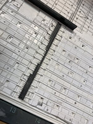

I used .040” x .040” strip to lay out the girders of the overhead around the light openings. These were actually H beams and those are available in plastic but I already had the square stock. Also the smallest H beam that I found is 1/16” which is thicker than the .040.” This probably would have looked out of scale and would have overall lowered the ceiling. You won’t be able to tell it isn’t H beam when you look through the hanger doors. I made up the fantail overhead and moved from there forward to the divisional doors and finally to the bow. There are some thwartship beams which divide the ceiling into sections. I put those cross beams first then I added the fore and aft girders between them. I checked the fit of the overhead repeatedly to ensure that nothing I had added would interfere with the ceiling dropping in place. Thankfully the hanger has the beams spaced further apart than the fantail but I still used 4 packages of the strip and needed more to do the entire overhead assembly and all the smaller pieces.
In the 60’s to the 80’s there were soundproofing or insulation panels between the beams throughout the overhead. These were removed sometime in the mid to late 80’s. They do not appear to have filled the space between the girders but were suspended to same level as the bottom of the H beam. I used various strip and .040” sheet to make these panels and then began placing them one by one in the strips with light openings. In the other strips I made a single piece for each section and then used a razor saw to scribe cross cuts marking out each panel. I did not try to model suspended panels. As a bonus once all this strip is in place the overhead is stiffened up considerably. After these panels were removed from the real ship it looks like the overhead was coated with some sort of textured paint to insulate the 03 level.
This photo of the divisional doors from the 1980’s shows the nature of the suspended panels. Note the T shaped hangers which were used to route casualty power cables across the hanger.
The aft section with the girder layout complete.
The aft section of the hanger overhead has had all the panels installed.
The forward section with sprinkler heads installed.

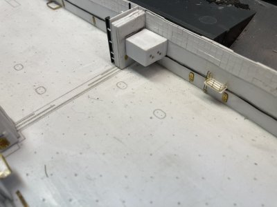

After I completed the framework on the overhead I went ahead and did the framework for the platform between the weapons elevators, the forward overhang structure, the interior of the Powerplants shop and the overhead of each elevator well. The ceiling in power plants is supported by 6 columns. I layered some thick plastic from my scrap box on top of the area and drilled holes for the columns through the laminated blocks and then the ceiling. The thick plastic provides the support for the columns. I used some 3/64” rod for the columns.
To ensure that each post will sit on the deck I cut short sections of tube and slid them onto the posts. I installed the aft assembly and held it in position. I removed the fantail bulkhead and using tweezers slid each section of tube down to the deck. I used a brush to place drops of Tamiya extra thin on the post securing the tube in position, I had to use just a minute amount of glue or I would have prematurely glued the posts to the deck. One of the tubes slid up on me so I had to remove that entire column and re-do it. This isn’t accurate either but it looks okay for what is visible and it solves any problems of columns floating above the deck.
Powerplants in position

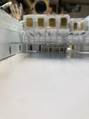

This is a good view of the divisional door tracks after the soundproofing panels were removed. Note the gussets on each section of the track. You can also see the exposed plumbing.
Each upper door track is heavily gusseted to keep it from flexing and about 150 triangular gussets more or less were cut from .010” X .040” strip. These were all made and then glued in place one by one. I did all the gussets at the divisional doors and then the elevator doors. On the elevator door tracks where the gussets would have been hidden by soundproofing I just ignored them. This is primarily on the inboard sides of the tracks. This cut the amount of gussets by more than half. It also cut the amount of work without detracting from the appearance. Finding a viable shortcut is always a good thing especially when you have to do so many repetitive pieces. I worked in smaller segments for shorter periods to get through it.

One of the things I needed to solve was modeling the Double Watertight Doors that opened to the Hanger Deck, some sponsons, the fantail, The 02 level between the weapons elevators, the 01 level leading to the Hanger Deck Yellow Shirt Locker and the exterior platform above elevator 3. With one exception In all the sets of photoetch and 3D print that I have or had researched representing US Navy doors there are no double water tight doors.
The exception is Eduard Set Part 4 which has a set of doors for the platform over Elevator 3. 2 part number 12’s from this sheet represent these doors but they are just flat panels with no relief detail. The dogs, hinges and handles should be seen even in this scale especially on the exterior. Every other set ignored all of the other doors on the exterior of the ship. That was surprising since Eduard had noticed the one set of doors but did not have any of the others. Enterprise had a least 11 that potentially could be visible from the sponsons or the hanger deck. All of the carriers that I served on had them. If you can’t buy any then you either scratch build some or just ignore them and use standard doors (“That will never happen,” I said). I used the Silhouette to make up several plastic blanks of the standard height and the taller doors of the Jet Shop.

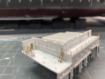

Double Watertight Door blank. This is actually 4 parts which can be used to represent open or closed doors.
I had originally wanted to open several of these double doors to get some alternate views into the hanger but after looking through the openings that I had made I decided not to continue. You just can’t see very much through them and there is a compartment spanning the space between the outside and inside doors in the case of the sponsons. I incorrectly cut the opening for the port side going to the Boat House aft of the Divisional Doors instead of forward and had to fill and blend the hole, duh. That opening was roughly ¼” square and even without the boathouse bulkhead in place not much of the hanger could be seen. All the other openings were filled and smoothed over. Only the Powerplants doors will offer any slight view of the hanger.

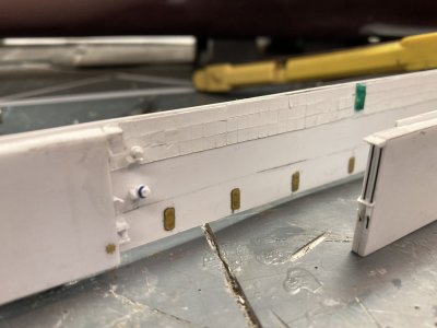

The blanks were installed on the appropriate sponsons, the platform over Elevator 3 and the interior bulkheads. I embellished these with some cut down photoetched square doors to add some dog and hinge detail. This was by far easier than scratch building all of the dogs and hinges on each door. It took two square doors to make each double door. Cutting them in half wouldn’t have been wide enough. I needed about ¾ of each door to use and the remainder went in my scrap box. I went ahead with opening the doors to AIMD Powerplants on the fantail which are taller, The Yellow Shirt Locker and the Tunnel Entrance primarily because these doors were frequently left open. You can see these three doors through the elevator openings. All the others will be modeled closed

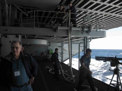

This ladder leads up to the Yellow Shirt Locker. Note the open Double Water Tight Door with what appears to be a normal 2 panel door behind it. It was made of metal not wood. These panel doors were common throughout the ship where a compartment did not need to be water or air tight. You can’t find these doors in any set either (perhaps in a dedicated set for a cruise ship). I only need a few of these so I made them.
This photo shows sponson 7. Just behind the sailor with the 50 caliber machine gun is the Double WTD standing open. There is a ladder well/ passageway between this set of doors and the doors between the weapons elevators in the hanger.

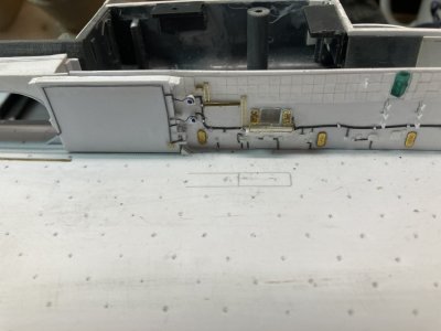

This is the Double WTD leading to Sponson 1
This shows the double WTD to Sponson 1 from the hanger as an Admiral is piped aboard. You can clearly see out to the sponson through the ladder well. When you size this down to 1/350 scale you can’t see much.
The double doors are all about .015” thick made up of 3 layers of .005” plastic. The Power Plants doors to the fantail are much taller to accommodate engines on trailers going to and from the test cell. This type of door is not what was commonly called a knee knocker. They were used to move large items about the ship. The lower sill is only a couple of inches high. This would still present problems moving an engine by manpower only. All the ships I was on used 1/2” L profile metal plates which were set on the sill interlocking with alternate panels. They formed a ramp and allowed heavy cargo to be moved through the doors relatively easily. They were designed so that a pallet jack could roll across them without hanging up. I made the doors for the Jet Shop with this feature. I went so far as to test the opening with a 3-D printed engine on a stand. These plates were used on any double door where cargo had to be moved through them. When the doors were closed the plates were generally stowed in racks welded to the bulkheads off the hanger bay.
This is the exterior face of my fantail bulkhead with the entrance to Powerplants open.

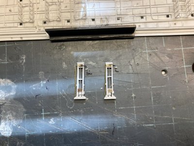

On the Fantail doors leading to the Jet Shop I had to scratch build the dog and hinge detail. I added stretched sprue dogs and hinges. Using metal doors to make this detail this would have taken 4 door segments whereas a normal height double door only used two. They would not look right trying to fit the 4 sections together. Because the real doors were so tall the only way to set the dogs across the top was by a ladder. Both doors had rungs welded on the inside and outside to facilitate quickly opening or closing them. I used a 5 Star caged ladder photoetch sheet making use of the type where you fold the ladder rails perpendicular to the rungs. This causes the rungs to protrude a bit. These were glued to the doors and the doors were glued in the open position. They look fairly close. The ramps are strips cut from .005” sheet.

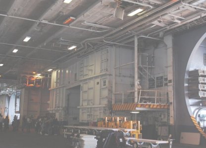

This photo from 2012 shows the weapons elevator trunks in the aft hanger bay. Note the red arrows pointing to the forward elevator door and the pulley arrangement.
6 This is the aft trunk and the red arrow points to the door.
There are 2 Weapons Elevator trunks in the aft hanger and one in the forward hanger. Each of these had a vertical door on the 1st Deck (Hanger Deck) to access them. I found a couple of photos from another ship showing them closed in the magazine. So I based mine on that photo. I did not have a good clear close up photos of these doors in the hanger but the pictures I do have show reinforcing bars horizontally across the door so I added them to my drawing. I used that to make a cut diagram for the Silhouette. I only needed 3 but I made 6 to have spares. I had the machine cut 3 parts for each door from .005” sheet and layered them together. It worked quite well but I did need to have some of those spares in the end. I made some mistakes and had to correct them.
The weapons elevator door in a magazine.

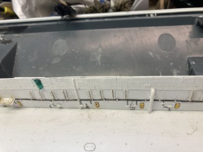

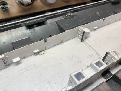

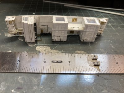

I next detailed the elevator trunks with various dimensions of plastic strip, rod and lead wire to model the details on each. The doors for the trunks in Hanger Bay 2 are on the aft side of each trunk. I finally found photos of both trunks which bear this out (and validate my memory). These two openings had some sort of pulley system above them and this was made with some tiny bits of plastic strip, stretched sprue and punched discs.
I once was assigned to assist my squadron’s Ordnance Shop moving a Data Link Walleye II guided weapon and pod from the hanger to the flight deck. My shop was involved because we had to verify their operation. The Ordies had made arrangements with Weapons Department for an elevator run and we took the skids to the aft Weapons Elevator in Hanger 2. I don’t remember much more about the system than that. It was some 43 years ago after all. I was fascinated by the operation of the whole thing. We had to go topside to accept the skids after sending them up and I got to watch as the flight deck elevators opened for other weapons.

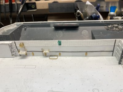

On the starboard side of the forward bulkhead of hanger bay 1 I placed the third door. You can just make out this door in photos. The overhang covers the pulley rig on this door or it is set up differently. There is an opening for the most forward elevator too but it is located in an alcove off the centerline tunnel not in the hanger.

In this photo they are testing the AFFF sprinklers. Off to the far right you can see the forward weapons elevator door. The Tunnel entrance would be to the left of that.

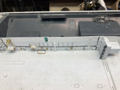

In this view of the weapons elevator trunks from the late 60’s there are several details that are pertinent, The open platform in the middle at the 02 level, the power cord or fire hose on the face of the aft trunk and on the elevator door machinery platform with the storage for triple ejector racks(TER’s)
Since all the bulkhead components would have doors installed on them and because they helped locate other details I installed all the doors on each bulkhead at this time. The majority of the doors accessing the hanger were Quick Acting Water Tight Doors (QAWTD.) These doors all had a wheel with a single bar for leverage to open or close all the dogs at one time. As the wheel turned it would move cams which were connected to multiple dogs by a system of bars and levers. Tom’s Modelworks sheet of 1/350 USN doors comes with several types on each sheet. I used all the QAWTD on one sheet to model the Hanger Bay. They have details for both open and closed doors. I modeled one of these doors open in the aft hanger bay to have the chow line going through it. There were some standard WTD’s with individual dogs which were each thrown by hand. I used the individual dog type where I found photographic evidence of them.
This is section of the port bulkhead with the doors attached. Note also the sound proof panels are in place.

This bulkhead forward of the Elevator 1 doors is a test case for detailing the other bulkheads any mistakes I made here will be virtually invisible once the hanger components even with the overhead removed.
While I worked on the forward structure I also detailed the starboard side bulkhead forward of elevator 1. This area can hardly be seen even with the overhead removed so it was ideal to practice on and if the results were a little less than perfect it wouldn’t matter. I did the soundproofing, wiring and panel detail and then any plumbing.
To install the wiring I used dividers to measure and cut a section. To get it straight I rolled it over my cutting mat with my fingers. The runs on the hanger bulkheads tended to go up and down around obstacles. But starting with a straight piece is better. I positioned it with tweezers and let some Tamiya Extra Thin tack it in place. When this dries I use thin CA to fasten it permanently. I punched discs and used tiny bits of strip to represent junction boxes and panels. Once these are positioned I ran leads from the main cable to the boxes or to the deck. To represent wiring hangers I use thin strips of aluminum duct tape pressed into position, trimmed and glued with thin CA. I worked on one area of the hanger bulkheads at a time until I have everything in place. Then I moved on to the next section.
Some of the common electrical installations are AFFF sprinkler control groups, sound powered phones, aircraft power and SINS (Ship’s Inertial Navigation System) Stations.* These various panels looked similar on the ship but could be laid out quite differently depending on what else was in that same location. For the purposes of the build I am making them pretty much alike. There is also backup emergency lighting (Battle Lanterns,) light switches, circuit breaker panels and junction boxes that have to be modeled. Each section of the hanger looks very busy after this stuff is installed which is what I am trying to achieve. All of the 3 phase 440 volt aircraft power stations were made less the actual cord since I wanted some plugged into aircraft in the hanger vice being coiled on the bulkhead racks.
In this photo of a small section of bulkhead you get an idea of the plumbing and wiring installations behind the tractor. Pretty sure this shot was taken in 2005 – 2012 time frame. The tractor would be a nice addition for any of you master painters. I’m glad I won’t have to duplicate it in 1/350 scale.

In each elevator well there is framework on the inner faces of each bulkhead. I used strip to add the girders and gussets. I added wiring, fixtures, plumbing and vent grills to detail each well. I ran a sprinkler pipe in the overhead of each well with sprinkler heads. Each well will later have fire extinguishers, life rings and elevator control podiums installed after basic painting is completed. In later photos there are some racks attached to the bulkhead with crates stowed on each. Those were not present when I was aboard. I think these might have been stowage for cross deck pendants for the flight deck But I don’t know for sure.
This shows some of the detail completed in the Elevator Door well.
The bulkhead between Elevator 1 and 2 was the next to be detailed. I had a set of 4 Conflagration Stations from Shapeways modeled in clear acrylic. I cut a hole in the bulkhead where I would mount them. This will hopefully allow each station to eventually be backlit. Since they used ballistic glass I painted them with thinned down mixture of Tamiya clear green and blue. Before I lay down the basic colors on the bulkheads I will have to mask the windows in each one. One of the three satellite stations was either a short shot of broke because the top was missing and I had to make a new piece to cap it. These were from a designer called Baconfist Models which I believe is out of business now. I attempted to contact them on their Facebook Page with no results. A flashlight shined behind each one produces the desired effect but it remains to be seen if the LED lighting I will be using will work. 90% of the time I never saw any sign of lights inside of these stations so if the effect doesn’t work out it won’t matter. When they were lit (probably at change of watch), they windows showed that blue-green tint.
In this photo from the 80’sThe overall area between Elevator 1 and 2 is shown. You can make out the plumbing going under the Conflag Station and then to the platform just forward of it.
Hanger 010.jpg5
This close up photo shows the plumbing and the three platforms. I’m not sure but I think this was some sort of filtration system.

There were 4 Elevator Door machinery platforms, 3 starboard, 1 to port and two Sliding Padeye machinery platforms on the port side. In the area between Elevator 1 and 2 the platform is just aft of the Elevator Door assembly. Each machinery platform had a vertical ladder to access it. The platforms and ladders were installed in the desired locations. There were large electric winches to move the elevator doors and smaller ones for the sliding padeyes. Those winch detail parts won’t be added until after basic painting. The Silhouette machine cut out the platforms and the support structure underneath. The Sliding Padeyes platforms are smaller than the elevator machinery platforms. These were used to raise and lower the Sliding Padeyes which hung from the overhead. They were retracted unless we were having an UNREP or they were undergoing maintenance. A Sliding Padeye is a screw like mechanism in a rectangular frame which automatically corrects for the vertical movement of the ships during UNREP.
This is the platform for the elevator 2 doors it is unique in it’s shape all the others were a simple rectangle. Only the basic platform, a storage box and the ladder have been added so far.

This photo shows the struts after they were freed from the wax paper. The set with the black markings were to mark the set for the elevator 2 door platform which is narrower than the others.
Each elevator platform had a vertical support system which ran from the platform to the overhead. Each of these had hooks to store MERS, TERS and launchers. These were installed on the supports during the Viet Nam Era but they were no longer being used for this during my two deployments. I made these off the model on waxed paper again. These will not be installed until after the painting and 2nd round of detailing is complete. Above each elevator platform was a smaller work platform with access to service the pulleys and cables to connect to the doors. I made the small platforms from re-purposed photoetched floater net baskets and L’Arsenal structural parts. An additional vertical ladder runs to these small photoetch parts. I also added railing to each platform.
The 4 elevator door machinery platform support struts are all made up.
This my take on the aft bulkhead of the Powerplants shop. I based it mostly on the photo below.
You have to look past the engine in work but you can see the doors, wiring and vents.
I detailed the aft structure inside and outside. Inside there is framework on all 4 bulkheads of the Power Plants work center. I have some pretty good photos from various times of the inside. There were 2 panel doors leading to office space, a storage cage on both the port and starboard sides and the normal complement of wiring and plumbing. Several vent pipes were located on the walls and door struts. These blew cool air on the men at work on engines in the shop. The 2 aft most support columns had air lines attached to a take up reel for pneumatic tools.

This photo shows the early construction of the starboard bulkhead aft of Elevator 4.
This is the final look of the same area. I have made the life jacket lockers but won’t install them at this time.
The life jacket Lockers under construction.
I made the lockers from the dimensions of the lockers in my drawing. I cut a 3/16” strip from a sheet of .060” sheet. I set up the Chopper and cut the strip into 3/16” pieces. The strip yielded 35 blocks and an off cut. I needed about 28 by the drawing but I made more in case. I used some .010” X .080” strip for the 2 doors on the face, cutting these with the chopper also. A pair of doors was glued to the face spacing them apart in the center with a scalpel blade. There is a strip at the bottom where the doors are cut off short to represent the drop bottom of the lockers. I used some .010” rod to make up handles for the doors and a piece of strip to make a hasp for each locker. I made them all at this time primarily because I wanted them all made the same. I did not intend to glue them in place at yet.
This is the forward port bulkhead.

I have used this photo elsewhere but the port bulkhead at the Divisional Doors.
Hanger 017.jpg4
Finally the port bulkhead to the Elevator 4 Doors.
I did all the wiring then various panels like I did on all the other sections finishing with the plumbing. Just forward and aft of the Divisional Doors were all the riser lines for the AFFF sprinklers. There were also a couple of fire mains and 2 large vent ducts on the port bulkhead. The port side has most of the Life jacket Lockers and multiple hooks to store sections of refueling hose. I now had the Life Jacket Lockers to help locate where the hooks would be positioned. During the deployment the refueling hoses were kept rigged at Sponsons 1 and 5. There were plenty of spare hoses stored on the bulkhead though.
This is the progress on the port bulkhead from the elevator doors to the Divisional Door.

I tried several methods of making these hooks. I first tried cutting them with the Silhouette but they never quite turned out right. I did use these in other areas (The forward structure and the Elevator Machinery Supports). I tried cutting thin wafers of 1/16 channel but this was too labor intensive and they looked out of scale. In fact 4 different attempts were tried and discarded before I hit on this. I made the hooks from vertical ladders. I cut off 5 rung sections of ladder with a sharp # 11 blade. I removed parts of the stringer between the rungs on one side of the ladder leaving a stub of stringer on each hook. In order to get some consistency placing these hooks, I glued sections of strip at the location of each row. I glued the brass part temporarily next to each strip with Tamiya Extra Thin and then positioned a second piece of strip on the other side of the hooks to keep the hooks upright and in place. Later I went back and reinforced each one with thin CA. It took about 8 hours to do all the hooks on the port bulkhead.
The hooks have been added to the aft end.

To make up the winches for the 4 elevator machinery platforms I had to make a transmission, an electric motor and a control panel. I did not want to install these parts yet but like the Life Jacket Lockers I needed them to ensure that other parts would not be interfered with. When I used the Silhouette to try and make the hooks I also set it up to cut out transmission blanks. It worked for the transmissions and I would be able to use them not only for the machinery platforms but also for the deck winches on the sponsons. They were cut out of .010” sheet and 3 pieces were used to form 1 transmission.
In this photo I have made a prototype elevator door winch and am working on the other three.
This is the 4 completed winches.
One winch and set of struts with pulleys at Elevator Door 2 Platform.
I used some punched discs and strip to detail the transmission. Next I used 1/16” rod and 1/16” deep channel to make the DC motor and stand. I glued a 2” long section of each together and cut small sections for each motor. I punched some discs to attach to each end of the motor. A small piece of strip was glued to the top center of each motor. A small square piece of strip was glued to the side of the transmission as the shaft guard for the motor. Then the motor was glued to that assembly at a right angle in the center of the guard. Finally 2 punched discs representing the output pulleys were glued to each side of the transmission. In all 16 separate parts were required to make up each winch. The control Panels are square pieces of strip with more rod and strip details. The winches for the Sliding Padeye Machinery platforms were also made up with tiny pieces of strip and rod. I had only a one bad picture of these from my era but some better ones from 2012. They are smaller than the deck winches and they actually mount to the bulkhead not the deck. I made the control panel for these as a part of the winch but here I added a photoetch panel to detail the controls since they will be visible.
This photo shows the 4 sets of struts, the 4 sets of elevator door winches, 2 Sliding Padeye Winches and 4 Elevator Door Machinery control panels.
These are the drop tank racks as I remember them. Note that they have a solid bar across the bottom, later they discarded these and started using a strap. I believe this was because the F/A-18 drop tanks were bigger in diameter than the tanks pictured here.
One major detail of the hanger was the overhead racks to store aircraft drop tanks. I had purchased photoetch racks from Tom’s Modelworks. I assumed this detail was covered and did not really look at the parts very closely. I wanted to install the racks now as they would be painted white along with the overhead. When I folded one up I was concerned with how flimsy these were. But my biggest concern was that they did not look like the racks in my photos. I served on 5 carriers and they did not look like any of the ships I served on. I believed that I could make them work but one problem was kind of insurmountable.
On the left is the one I made. On the right is one of the photoetch racks. You can see that I haven’t done a very good job folding this one up. I thought that the two angled points at each end would also fold up. They don’t but I felt that I could cut the frame and fold them. It would have been pointless though because….
This is the 5 parts for the racks that I made.
Here is one assembled and both tanks will fit in the rack.
I made up a cut program for the Silhouette based on my scale drawings for the ship. The first time I tried to cut out a batch I made the frames too thin and they did not cut out properly. I beefed up the frames a bit and tried again. This time the results were pretty decent. Each rack is made up of 5 parts. The frame that attaches to the overhead isn’t quite accurate but it makes the entire assembly much stronger. I made a couple by just gluing the parts together testing their ability to hold the tanks. It occurred to me that if I glued the base frame to the overhead the rest of the assembly wouldn’t be quite so fiddley. I did this for all the remaining racks placing them by the drawing.
Here are most of the racks in the aft hanger.
And the forward hanger.
In this photo you can see one end of the basketball court and a pretty good view of the projection booth.

I used my drawing to measure and cut 4 uprights and base pieces for 2 machines until I found out that the drawing wasn’t as tall as the model. I made the uprights slightly longer to be the same height as the bulkhead and the bases a bit wider to keep the symmetry. Each lower base was 3 parts, each upper was 2 and the uprights were 5 each. Smaller pieces made spacers to support matching parts. The inner face of the uprights had a recessed slide to keep the trolley from shifting. I used thin strip glued to the edges of each upright to make the slide. I placed and glued a base piece on the top and bottom of 2 of the uprights.
For the shaft I needed a fine stiff wire with an even finer wire wrapped around it to represent the threads. While searching for something to use I remembered some steel electric guitar strings that I had bought for another project. I had 3 sizes of strings and the smallest was pretty close to what I wanted. I drilled a # 64 hole centered in the each brace for the screw shaft. One brace is just above the motor the other is near the top for some sort of equipment shelf. I used a small square of plastic strip for the trolley it also had a hole drilled in it. I cut the shaft to the length between the two braces but did not have any protruding from the either. I made the electric motor from some 1/16” rod and some punched discs. This was glued between the lower brace and the bottom plate. Then the other upright was glued in place.
Two detailed up sliding padeyes.

I placed each part on the overhead and cut 3 pieces of plastic angle to represent the up lock and hinges. Holding the part in place I glued the angle pieces to the overhead but not the Sliding Padeye leaving it removable. Everything was left to dry overnight before I wired the machines and the overhead. The wiring extended down one strut on the opposite side to the ladder, connecting the padeye to the overhead, the electronics at the top, the junction box and the motor. I used sections of lead wire to make up the wiring harness with a short pigtail which will disappear into the overhead. I used rigging eyes and more half reels on the overhead to rig the padeyes to the winches on the two platforms. All the half reels received a small punched disc to give them a more 3 dimensional appearance. 2 more rigging eyes were added to the port bulkhead above the padeye platforms to bring future rigging up to the overhead.
You can just make out the pulleys and rigging loops on the overhead.
The model with the detailed hanger bay installed, the overhead and the two boxes of parts to be added after painting.
Looking to port at the aft end.
Moving forward to the divisional doors.
Just forward of the divisional doors.
Looking to the port forward end with the forward assembly removed.
The starboard forward area.
The same area with the forward assembly installed.
The forward assembly looking to port.
Looking to starboard the area between elevators 1 and 2.
From elevator 2 to the divisional doors.
The area between elevators 2 and 3
From the weapons elevator trunks to the elevator 3 doors.
The starboard aft bulkhead.
