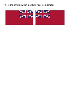

I'd love to find a way to print my own flags, so I could have a period flag on my Baltimore Clipper.
I download the flag that I need from the internet and load it into Powerpoint. After sizing it and creating a mirror image, I print it in color. Then I spray the image with several coats of clear enamel from a spray can to seal it. After carefully cutting out the image I fold it over the attachment string or cord, and glue the halves together with while glue. Voila! A flag. I usually make several copies of the flag to allow for mistakes.

TheDonMI has it right. The method of printing a flag from power point...sealing it together...coating with poly...works great...I have done this as well. One secret is to "curl" the paper flag..either by hand or by gently scraping it across a rounded straight edge to curl the paper into a drape. Once curled into a drape form one would not readily tell it was actually printed paper. I have tried and I do not know of any paper, even silk span, that one could print on that would "show" through the opposite side. No matter what you use to print...you will likely need to print a reverse image as shown above and seal them together. No worries...when done carefully it will look fine.

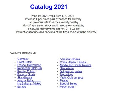

Great news - so we should remember the name Hans Blissenbach
and his web-page Exclamation-Mark
here the catalog in english
