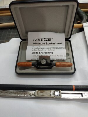

miniature spokeshave
  • Thread starter Thread starter stuglo
  • Watchers Watchers 4
Veritas miniature tools are beautifully made and just right for wood modelers.

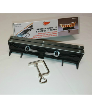

That is what I was talking about the shaving horse.
Here's one. For holding strips of model sized wood for planing or shaving. I made my own. The one PT-2 is referring to I think, is called a shaving horse, used by barrel makers, chairmakers and others to hold wood to be shaped with a spokeshave or drawknife.
Shaving horse
EJ
Shaving horse is what I was referring to with the name. As I said leather stichers and saddle makers use the same type of a clamp bench. I have the shaving clamp that you show but have not had a lot of success with it or used it often enough to get the clamping down. When I used it I didn't pay enough attention to the grain direction and the knife dived and cut too deep. Maybe sanding would work better for me. PT-2
I found the same problem, but cutting with the point can prevent this. But the set up is fiddly and I find easier and better with a metal ruler-clamped to table for longer pieces. Also passing the wood over a clamped upside down mini plane allows excellent control and the option of varying the amount of removal at various places along the length.
